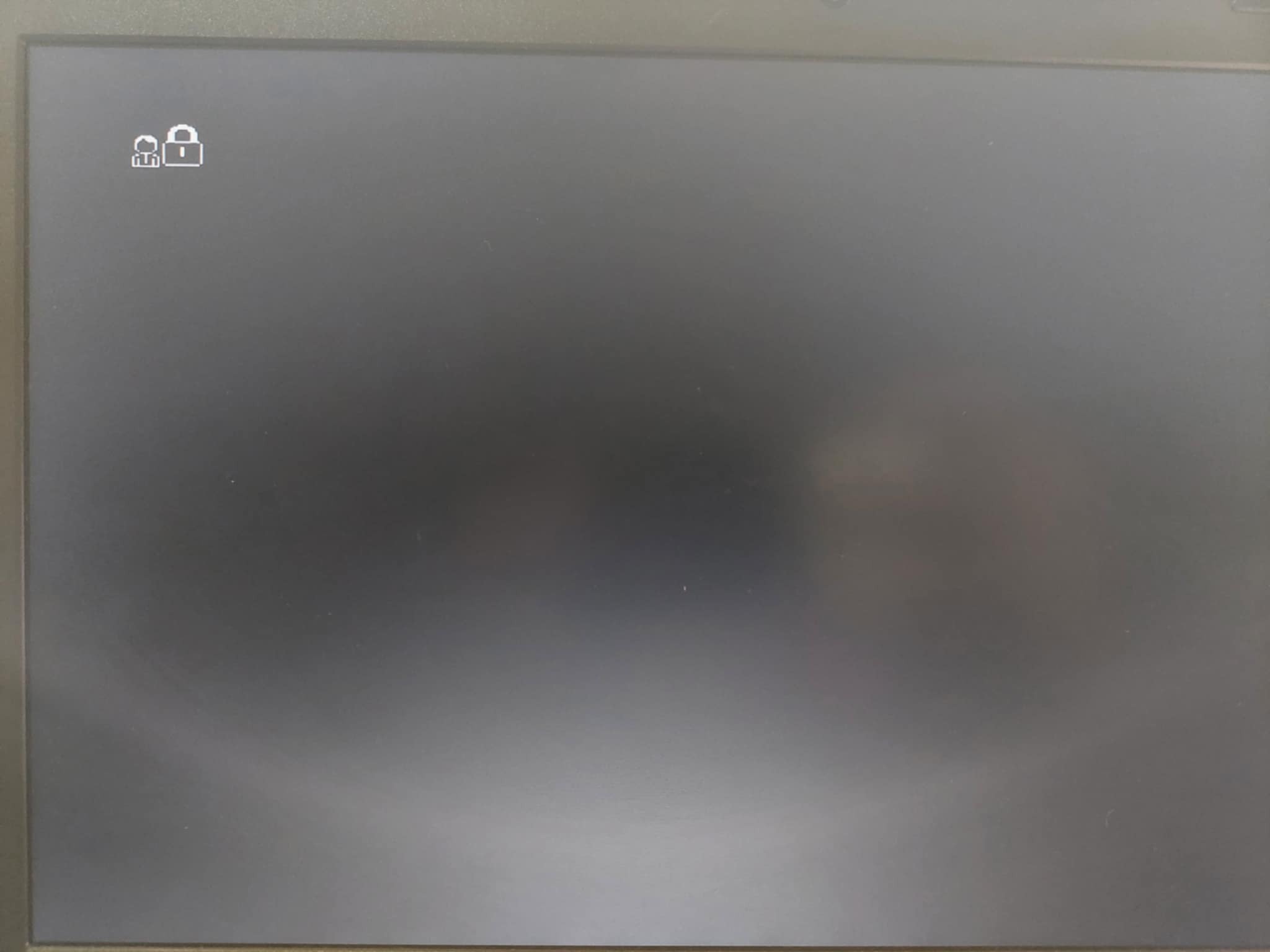

            • thelibrary
              • Jul 2018
              • 18
              • philippines
              #3546
              i flashed the patched file.
              i boot the machine
              press enter
              asking for supervisor pass
              i enter any pass 3 times then it lock and shutdown
              it didnt show hardware id

                • thelibrary
                  • Jul 2018
                  • 18
                  • philippines
                  #3548
                  working thanks
