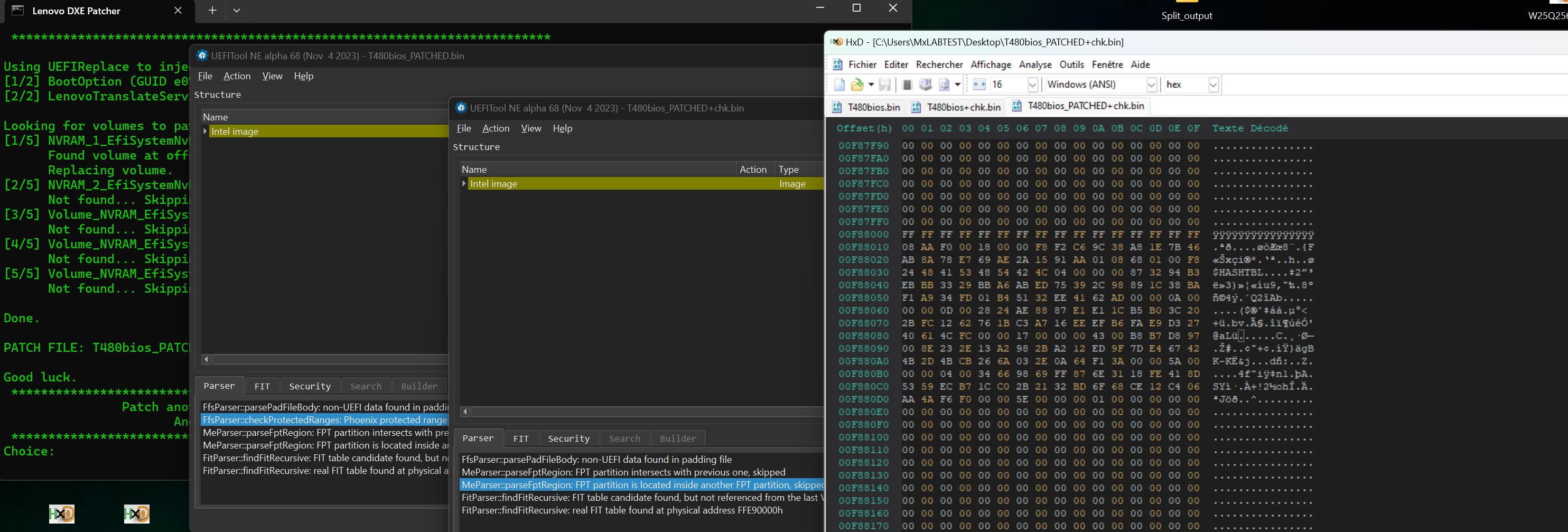

                                    #3397
                                    So I tried following the guide, but hit an immediate roadblock. The hash range 970000h: DA0000h doesn't match with the hash ranges in the security tab in UEFITool:
                                    Code:
                                    FfsParser::checkProtectedRanges: Phoenix protected range [970000h: DA0000h] hash mismatch, opened image may refuse to boot
                                    Code:
                                    Phoenix hash file found at base 00F88018h
                                    Protected ranges:
                                    RelativeOffset: 000A0000h Size: D0000h
                                    Hash: 873294B3EBBB3329BBA6ABED75392C98891C38BAF1A934FD01B45132EE4162AD
                                    RelativeOffset: 00170000h Size: 430000h
                                    Hash: F346D4820EAC0C54FF7B7D342BBEDC1773C839936B53F366B50CE7CC92DEF45B
                                    RelativeOffset: 005A0000h Size: 40000h
                                    Hash: B8B7D897008E232E13A2982BA212ED9F7DE467424B2D4BCB266A032E0A64F13A
                                    RelativeOffset: 005E0000h Size: 10000h
                                    Hash: 34669869FF876E3118FE418D5359ECB71CC02B2132BD6F68CE12C406AA4AF6F0
                                    Unless I'm missing something from the tutorial?

                                      #3398
                                      [QUOTE=Tokeri;n3465637]
                                      [QUOTE]
                                      Post your bios
                                      model and serial number to respect the rules

                                        #3399
                                        [QUOTE=Maxpower3;n3465640][QUOTE=Tokeri;n3465637]
                                        Post your bios
                                        BIOS in attachment (unmodified)
                                        serial number PF-1QP25J
                                        Type 20L6
                                        • Maxpower3
                                          Bad Veteran
                                          • Feb 2018
                                          • 1356
                                          • France
                                          #3400
                                          [QUOTE=Tokeri;n3465647][QUOTE=Maxpower3;n3465640]
                                          Type 20L6
                                          try
