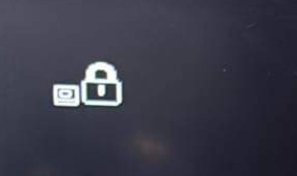

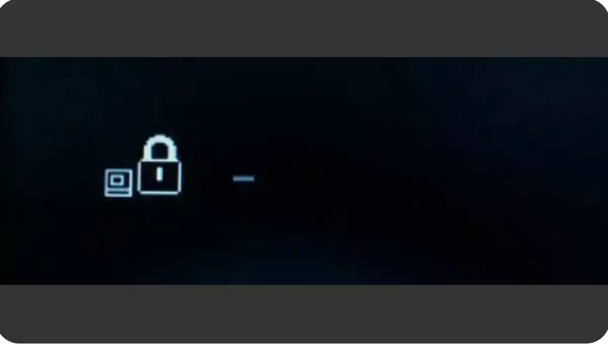

      Originally posted by auszylow
      yes , so I have do it correctly but there is still bios password
      Post a screenshot, which one do you have on the screen?

      • auszylow
        • Jul 2023
        • 22
        • United Kingdom
        #3103
        ok, everything done now . Thank you guys for your help !!
