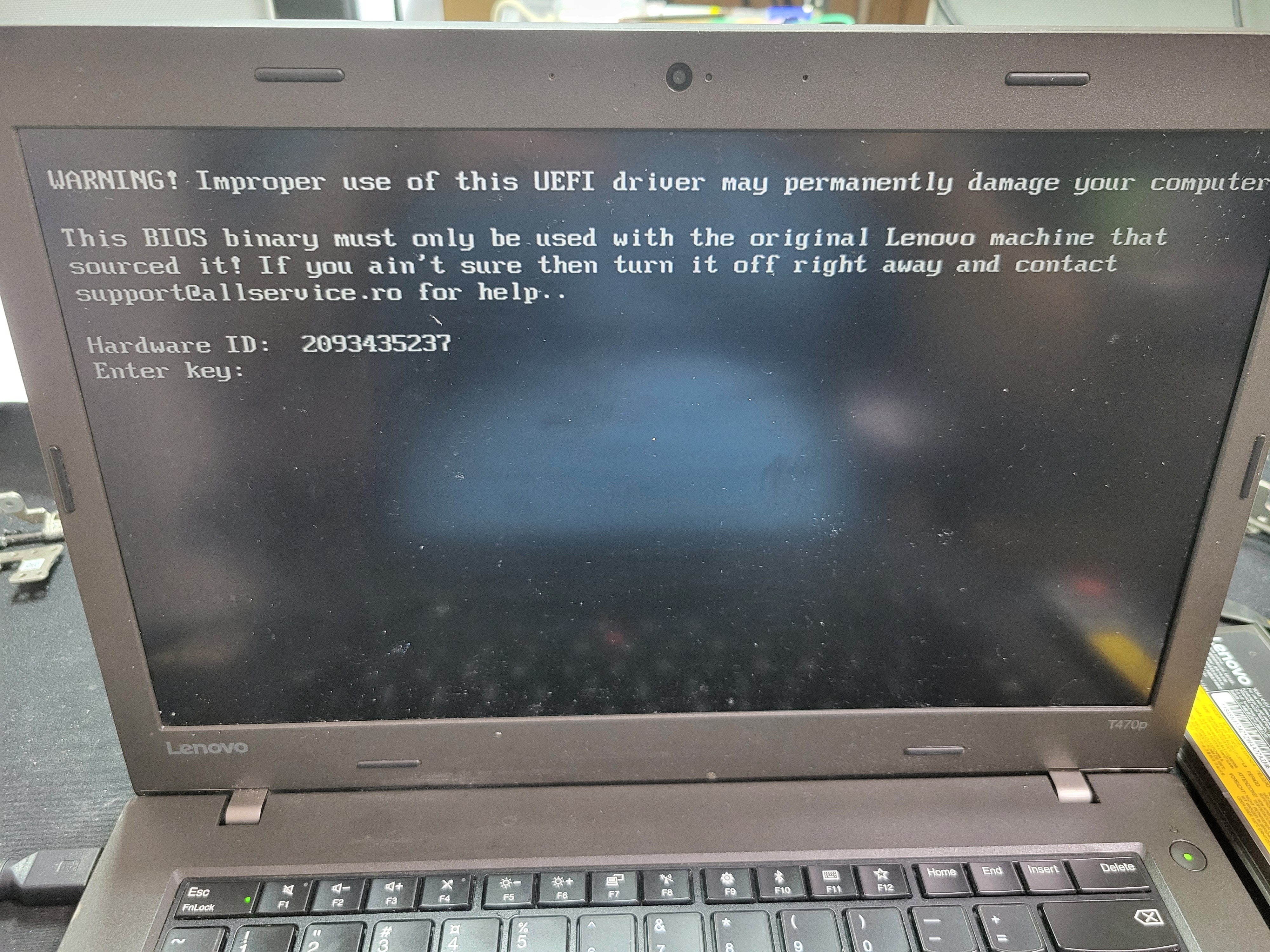

                      • paboxx
                        • Apr 2019
                        • 4
                        • Poland
                        #3016
                        hello,
                        please could You help to patch bios with supervisor password blocked after thermal paste replace.
                        Thinkpad T470p
                        Laptop model 20J6-0018MD
                        S/N PF-0WUH3E
                        Board number NM-B071 Rev:1.0
                        Thank You wery much.
                        • Markus1741
                          • Sep 2020
                          • 946
                          • N/A
                          #3017
                          Originally posted by paboxx
                          hello,
                          Thinkpad T470p
                          S/N PF-0WUH3E
                          Try this patched file ...
                          • paboxx
                            • Apr 2019
                            • 4
                            • Poland
                            #3018
                            Thank You Markus, but with new bios laptop stuck at red lenovo logo.
                            If i interrupt pressing enter it gives me error 0183: Bad CRC of Security Settings in EFI variable.
                            Press F1 to enter Setup, and after press F1 supervisor password icon appears.
                            Maybe You could help me.
                            • paboxx
                              • Apr 2019
                              • 4
                              • Poland
                              #3019
                              Hello once again, I type password "admin" and it go further.
                              Then appears screen uploaded in attachment, and I push Enter, then press space two times appears and reboot.
                              Now supervisor password not show up, but when trying to enter bios it only shows "Entering Setup" and 5 dots appearing
                              I think I made mistake not typing key under Hardware ID
                              What should I do now?
                              • Markus1741
                                • Sep 2020
                                • 946
                                • N/A
                                #3020
                                Hello, have you ever read the instructions in post #1 where you can see everything about how to remove a password from the 4th to the 8th Lenovo version.
