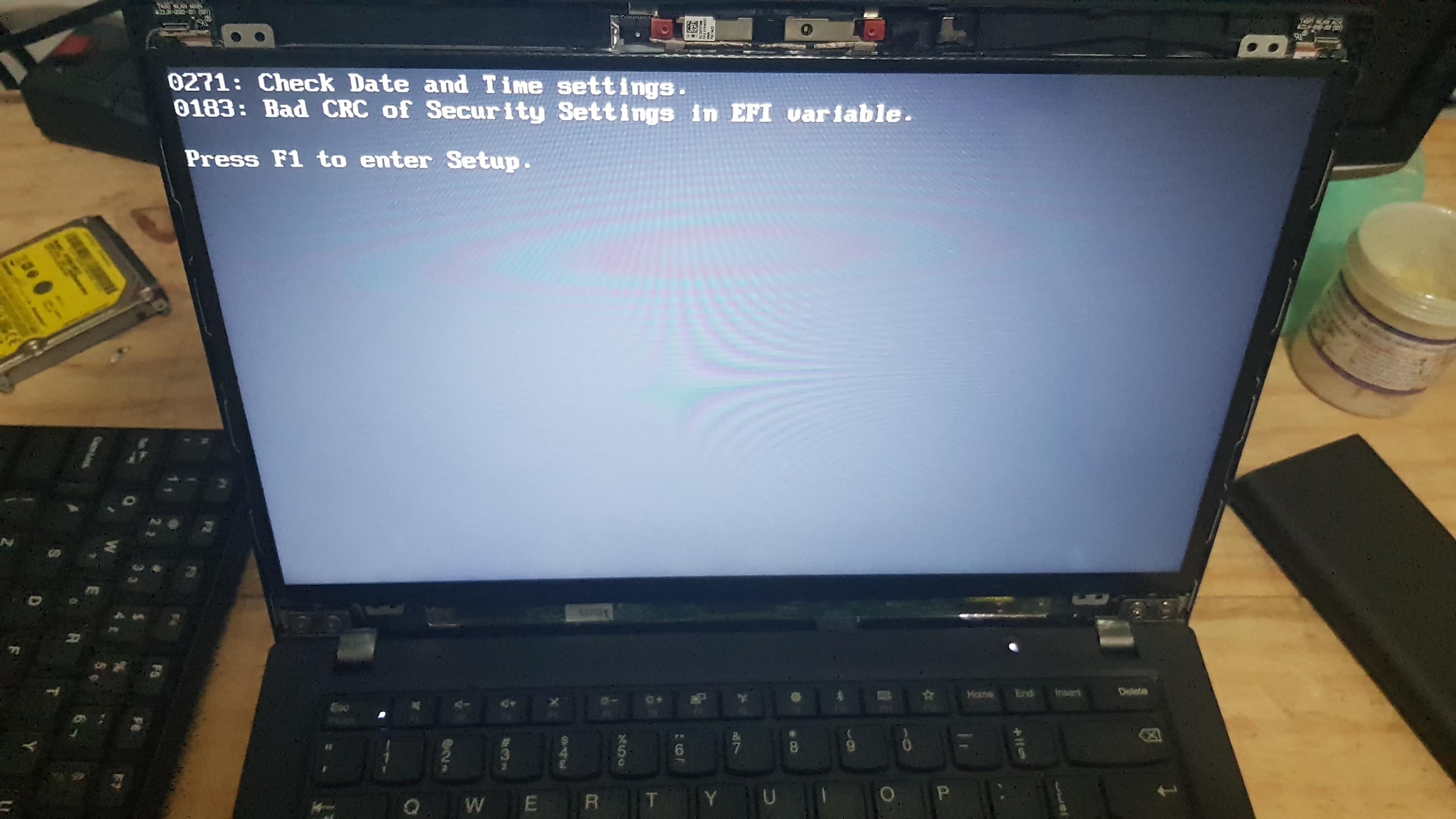

    what to do when you don't have the supervisor password, and you get error 0183? model T490.

      enter the bios, set the date and time.
      Check if the bios battery is connected.

        it is not possible to enter the bios, because I do not have the supervisor password.

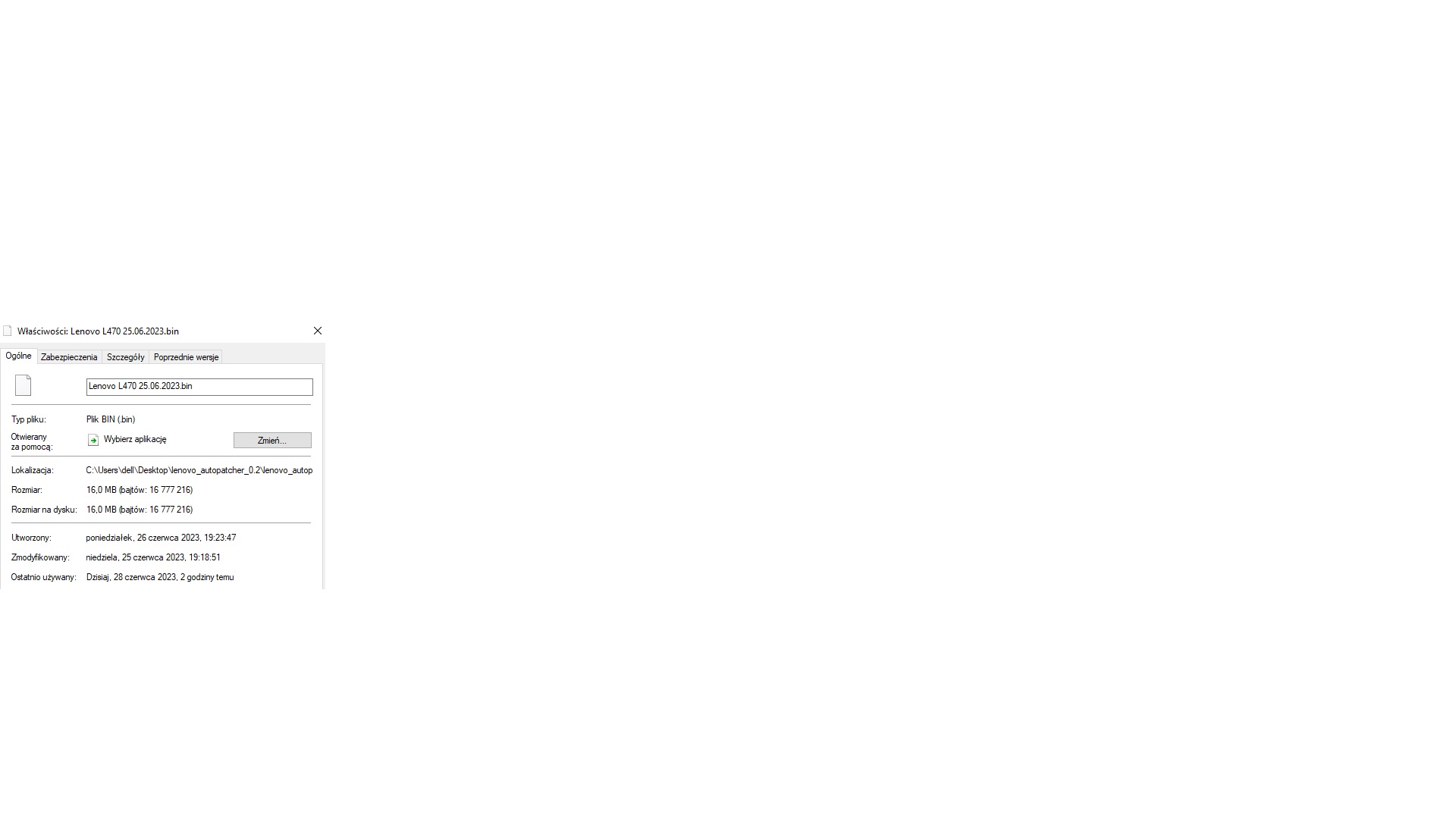

          Proszę o pomoc nie radzę sobie z moim biosem od lenovo l470
          nawet autopatcher nie pomaga proszę o pomoc
          Hello again
          Please help, I can't deal with my bios from lenovo l470
          even autopatcher doesn't help please help

            Are you kidding?
            Your uploaded BIOS file is completely empty.
            I would first try to create a reasonable backup of the notebook.
            Ideally, create three backups.
            And then read me how the auto-patcher works.
            And the whole thing in English and not in Polish.
            Good luck ...

              Hi Markus as the file can be empty as it is 16MB I do not understand how it happens that it is like please help
                Open the backup with a hex editor,it will be all FF`s . HxD hex editor -> https://mh-nexus.de/en/downloads.php?product=HxD20 .There is a polish version.
                What model is your programmer, i`ll guess its a CH341A or EZP20** .Have you desoldered the bios chip or are you using a clip. Post a picture if you can of the bios chip on the board.

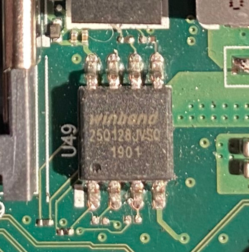

                            Oh the Lenovo T480s model is tricky the resistors are placed way too close to
                            the EEPROM they can be damaged very quickly with the clip.
                            This interrupts the signal path so that the BIOS can no longer start.
                            Please be sure to look at the pictures, I've already had to repair it.
                            Good luck ...

                              So it seems like you know your way around a t480s
                              Can you also confirm which is the bios chip? There's two possible ones: one near the ram (which I supposed was the right one) and another near the wifi card.
                              Thanks a lot for the recommendation. I'll try to see if that's the problem and if I can fix it.

                                    Update on my T480s that was making beeping sounds.
                                    I managed to get it all working. What I did different was taking out the RAM (though I doubt that actually made any difference) and enabling all options in the "Write IC" drop down in neoprogrammer: Off-Protect, Erase, Blank Check, Write and Verify.
                                    By default it was only Write and I didn't even notice the drop down menu there.

                                      Hi, it turns out that my programmer was damaged I bought a new one you can now look at this file
                                      I used the EZP 2023 programmer + now I bought CH341 on clips my bios winbond 250 128 vso 1703
                                        Hello now everything fits, try the file, good luck ...
