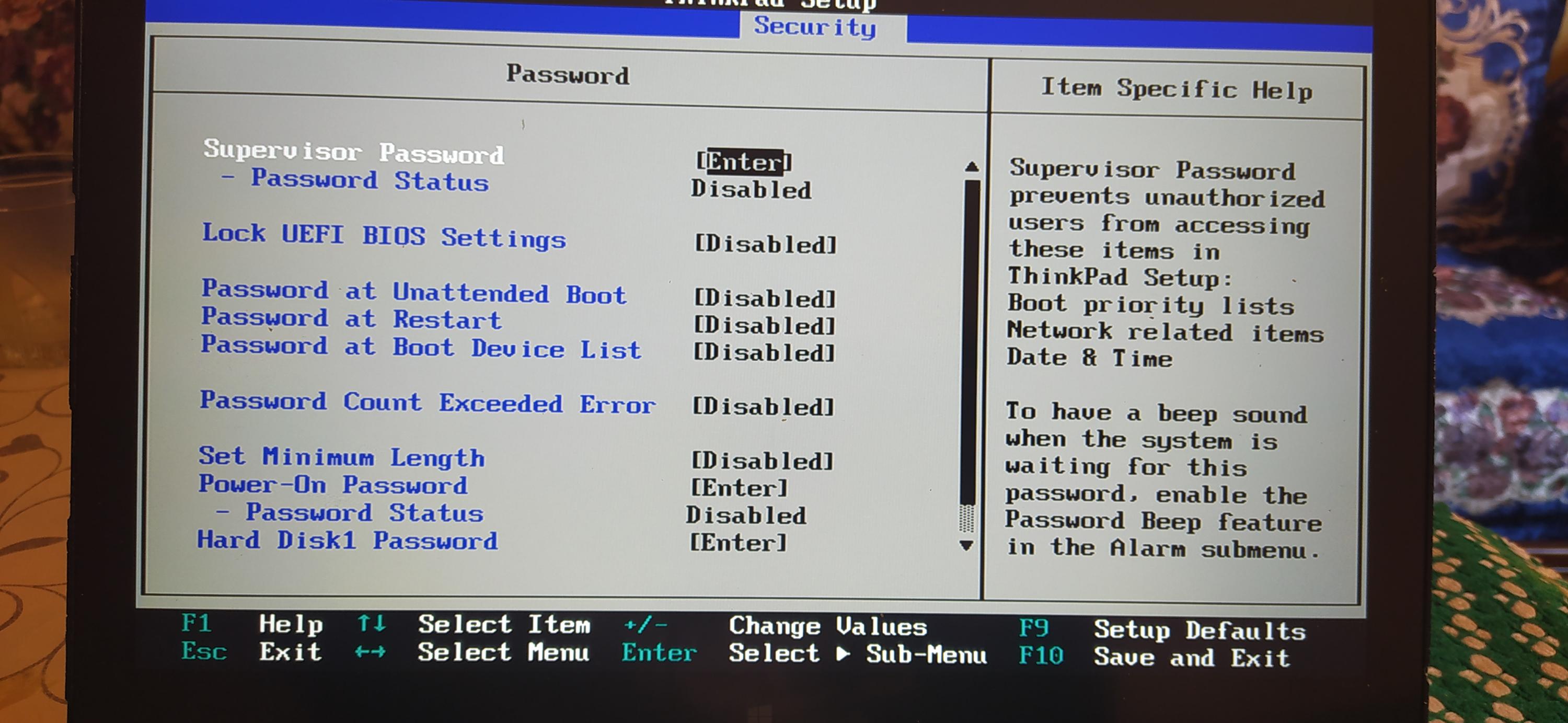

                      • Syavko1
                        • Mar 2022
                        • 53
                        • Ivano-frankivsk
                        #2451
                        Re: LENOVO BIOS AUTO-PATCHER for Supervisor Password Removal
                        try this file and follow steps described in #1
                        [ HOW TO USE THE PATCH ]
                        STEP 1: Flash and replace current BIOS with the generated patch file
                        STEP 2: Boot the machine
                        STEP 3: Press ENTER/F1/etc. to enter BIOS settings
                        STEP 4: Enter any character when asked for Supervisor Password
                        STEP 5: Press enter when it shows Hardware ID
                        STEP 6: Press space bar 2x when asked
                        STEP 7: Turn off machine
                        STEP 8: Restore original BIOS
                        STEP 9: Reset BIOS settings to factory default
                        [ NOTES ]
                        When booting the patched BIOS you might have to:
                        - Hold the anti-tamper switch down the whole time (use tape)
                        - Remove the hard disk or replace it with a locked one
                        after firmware, the laptop does not turn on, only the power indicator lights up
                        • Syavko1
                          • Mar 2022
                          • 53
                          • Ivano-frankivsk
                          #2452
                          [ NOTES ]
                          Thank you, I am very happy. The problem was that the chip was not soldered well: компиляция:
