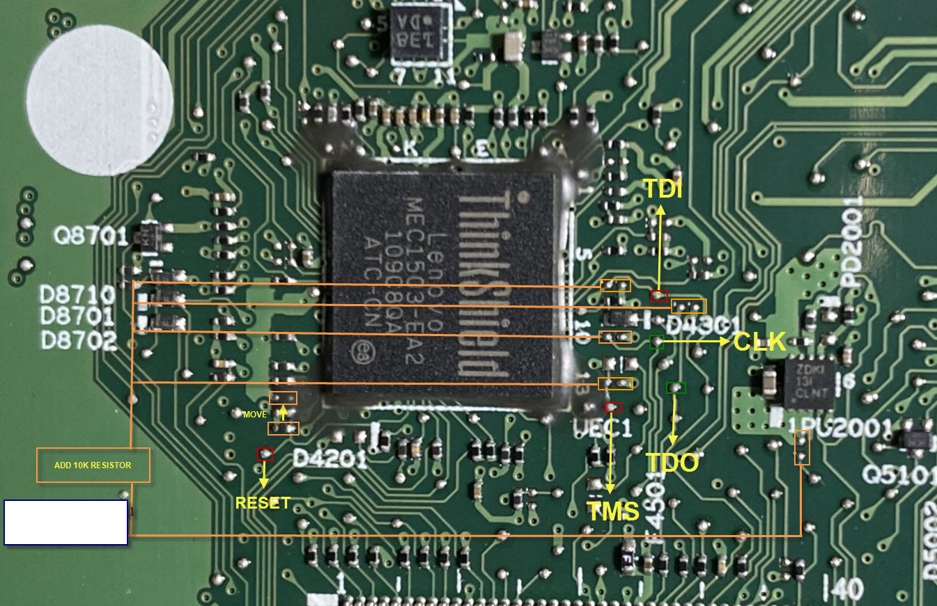

              hello folks
              after many hours of searching about how to remove password for Lenovo t15 2gen with MEC1503,i did found how to enable jtag and adding some resistors,i tried to read it by RT809H,it can be readed succefully,but file data are 0080.
              someone told me that there is a paid method for reading and patching this kind of MEC using RT809H.
              if anyone can help i'm sharing jtag enabling and testt points

                              Originally posted by mafioso3
                              hello folks
                              I would also greatly appreciate some more infos on this topic.

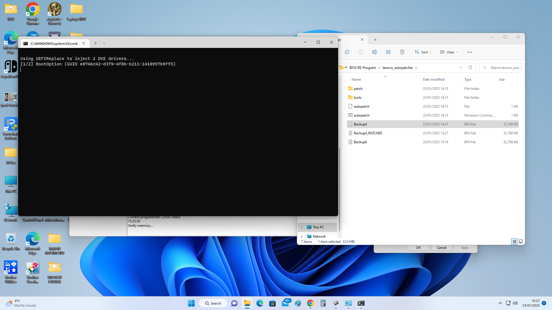

                                    Hi guys i have tried to use this program but it doesn't seem to work when using autopatch it shows a updated bios then disappears.

                                      #2238
                                      Re: LENOVO BIOS AUTO-PATCHER for Supervisor Password Removal
                                      Might be easier if I upload my backup file
                                      the system is: Thinkpad X13 Yoga Gen 1 20SY-S27K00
