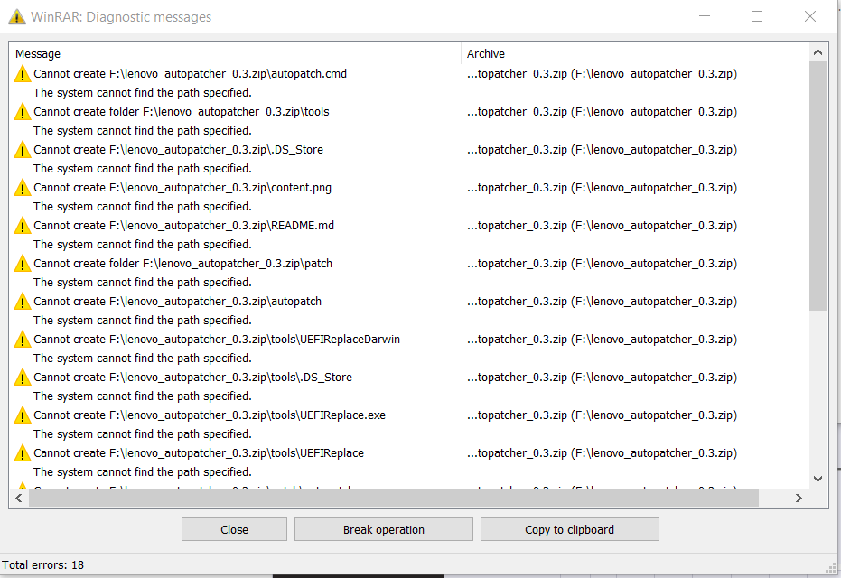

                  • hoaca388
                    Badcaps
                    • Jan 2022
                    • 12330
                    #2089
                    Re: LENOVO BIOS AUTO-PATCHER for Supervisor Password Removal
                    Originally posted by syscall
                    Unfortunately, I'd already the permissions set.
                    The issue was caused by some files I forgot to remove from the DXE folder after experimenting. Shame on me.
                    As I've read in this thread that I was not the only one who ran into this issue.
                    To give something back to this awesome community and thread, I've adjusted the script a little bit:
                    * Added support for MacOS.
                    * Added a README.md with the content of the TO's first post.
                    * Added some additional information to the user when he runs in a similar issue.
                    Hope it helps someone to prevent future (layer 8 ) issues.
                    Zip file error.

                          #2092
                          Originally posted by hoaca388
                          Zip file error.
                          Sorry, I zipped it again. Can you try it again please?
                          Unfortunately, I couldn't find a way to edit my previous post.

                                        Tried drag and drop inot the "Autopatch.py".
                                        Laptop stops on "ThinkPad To interrupt normal startup, press Enter", but when I press Enter nothing happens. Any solutions?
                                        Hello, I had the exact same problem with the same model.
                                        I think it is due to a corrupted ME region in the original BIOS file.
                                        At that time nobody wanted to help me either, I'll try it once.
                                        Greetings to Poland.
                                        https://www.badcaps.net/forum/showpo...postcount=1278

                                          Unfortunately it didn't change anything, it's still hanging on a black screen.
                                          Anyway, thank you very much for your efforts/time and greetings to you my German neighbor.
