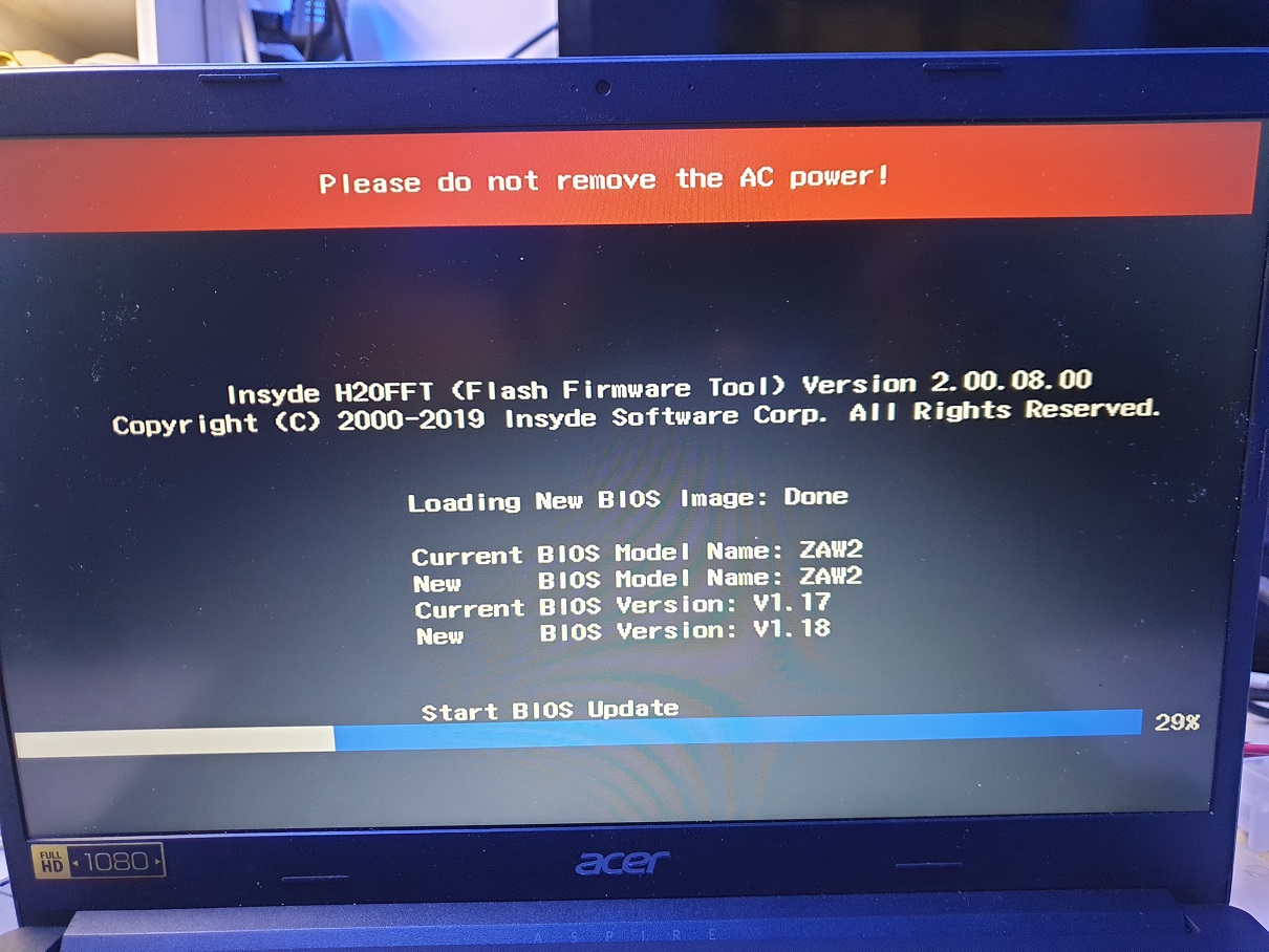

i extraced 13Mo from exe file + 3Mo header acer bios from other backupComment
Re: bias dump Aspire A315-55G

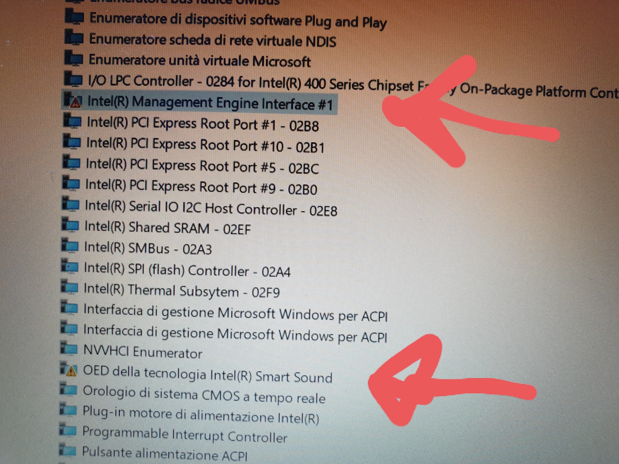

the eprom is a Winbond 128 ... btw now when the pc starts ( 24 seconds on warming up and 3 minutes to load windows ) there is the Intel Management Engine (on drivers) with an error.. this maybe can be a CLEAN ME issue?
DA0ZAWMB8G0 rev G
P.S. the flashed one is reporting the 1.12 release of the bios.. and after that i flashed with official tool to 1.17... and now i'm trying to flash to 1.18 ( that is the last one) .. just to be sure that BIOS and ENE will be at equal version of MELast edited by Bartoloni; 11-13-2020, 06:12 AM.Comment
SMDFlea you are a GENIUS! this BIOS is perfectly working on the A315-55G board release G !!!
P.S. the FAN is very loud, seems spinnig at maximum speed after a while.. thermal compount was just replaced ... i saw that the BIOS version is the 1.18
P.P.S. after a while i pressed a switch (reset for freezed super-io chip) on the board... after that the fan is no more working at full speed... the CPU is an i5 10th with a turbo mode of +4ghz (!!!) 8 threads... a beast.Last edited by Bartoloni; 11-13-2020, 08:50 AM.Comment
I`m no genius. I used the bios from this thread,post #8 https://www.badcaps.net/forum/showthread.php?t=89632 .I cleaned the ME firmware .Clean the heatsink fins,and check if the fans metal cover is removable,lift the fan off the spindle,if it will lift with no force and put a drop of sewing machine or other light oil on the spindle.Comment
