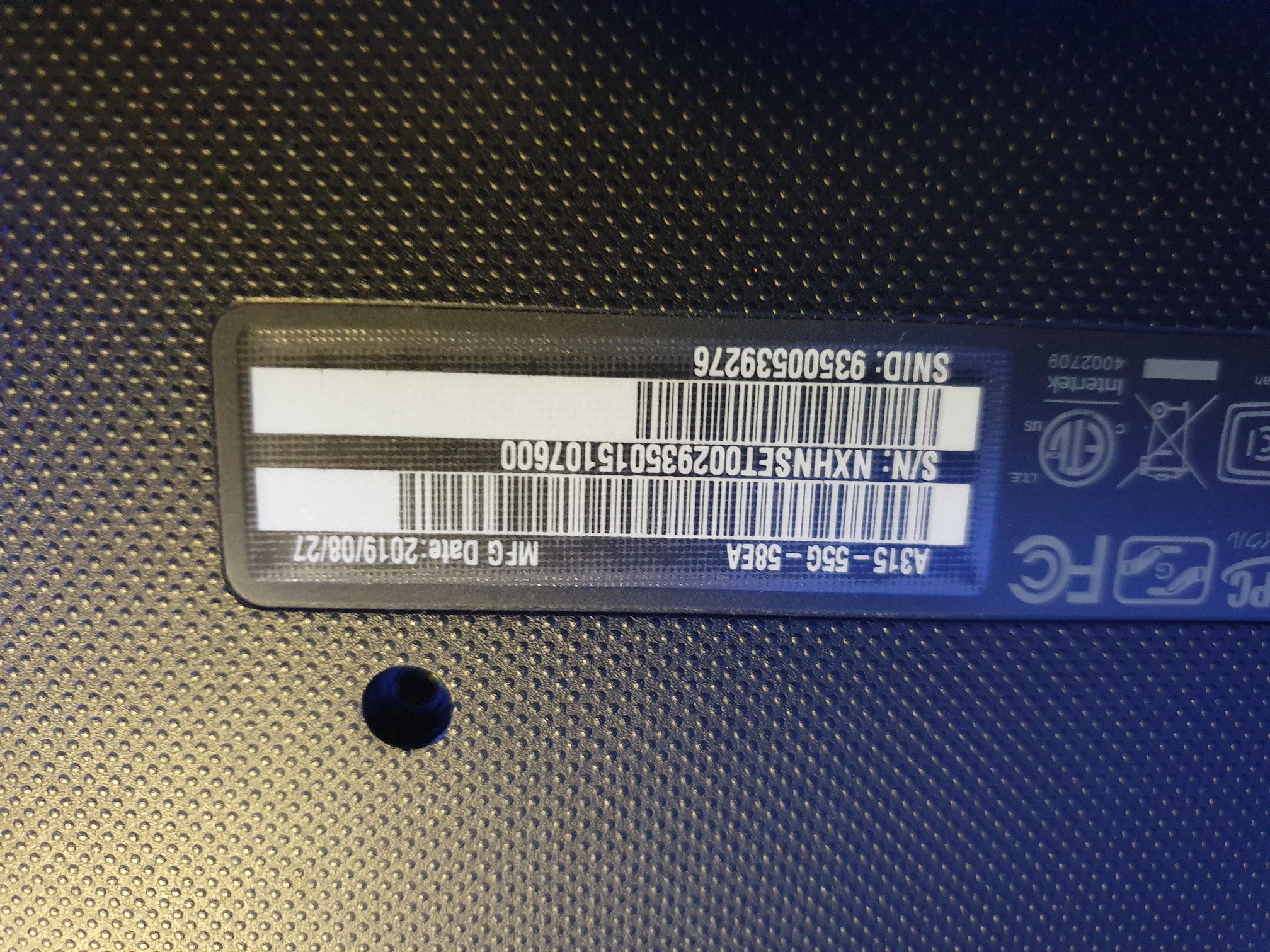

                anyone has the REV G bios? i tried the 2 posted here but are not right

                    hi SMDFlea the issue is that this laptop is coming from another shop and they already flashed the original bios right now there is not a dump

                      Post the serial number and pictures of the stickers with model number .

                        Re: bias dump Aspire A315-55G
                        here you are:
                          Originally posted by Bartoloni
                          here you are:
                          Extract from officiel site with your serial laptop
