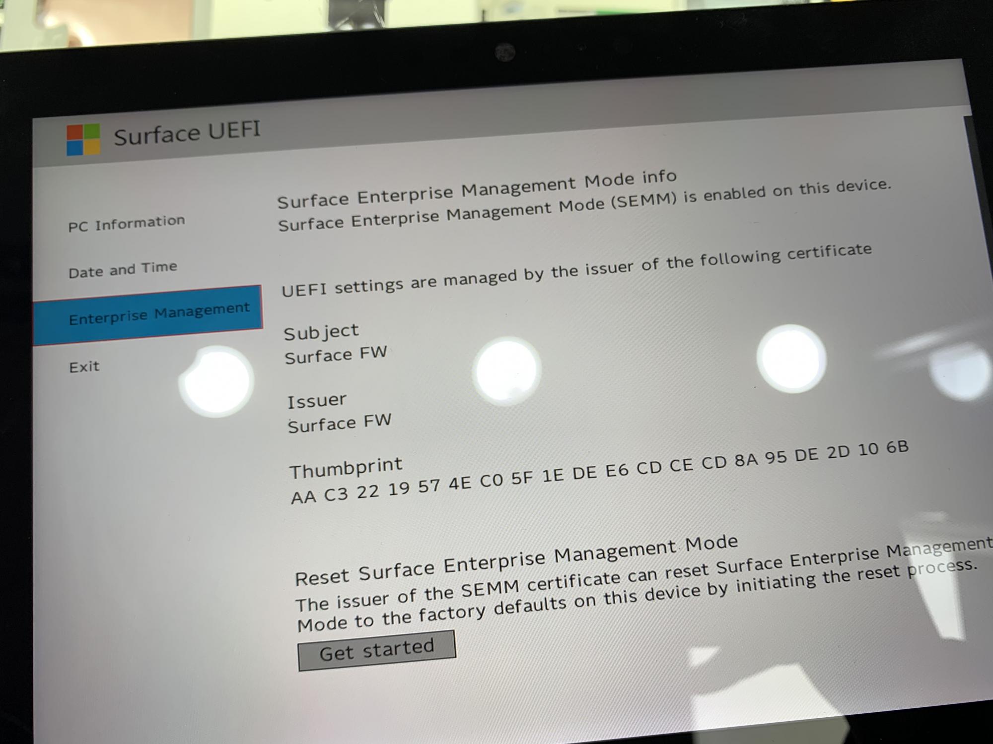

Need to remove efi lock surface go
    plz someone help me.

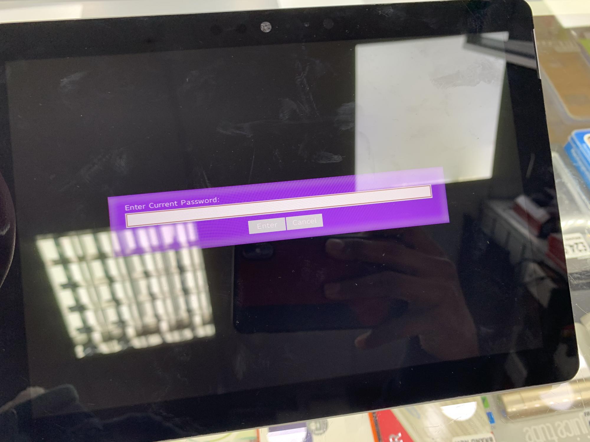

          Re: Need to remove efi lock surface go
          its say bitllocker no password.
          i have efi password on bios. its not let mew install windows.
          plz help me. what should i do now.
          thank you.
            Can you access bios or not?
            If it doesn't let you access bios, it is locked bios.
            If it doesn't let you USB boot, it is locked boot order.
            If it doesn't let you install windows, it is bitlocker.
            So which one is it? Take a picture of it.
                Well, SEMM is a different story then. I have not seen it yet so I don't know how to disable that.
                  There is no solution ? 😔
                    Try this and update.
                      Thank you so much. It's working perfectly. 😊✌️
