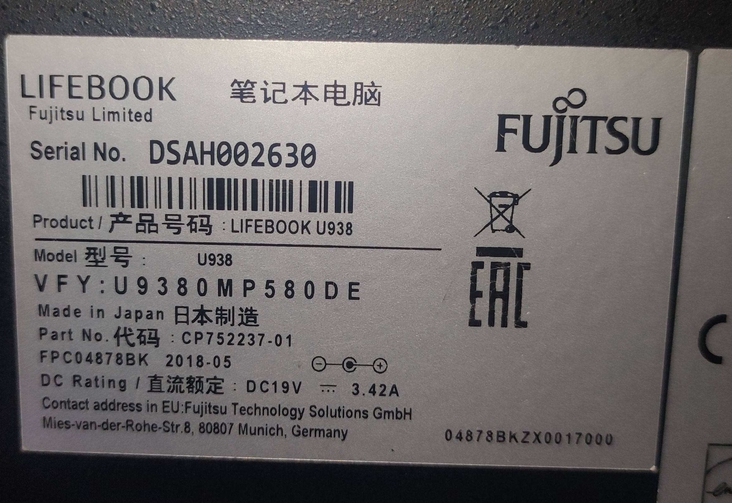

                • DaFluepp
                  • Oct 2019
                  • 57
                  • Deutschland
                  Re: Need Bios LifeBook U938/S
                  thx for reply, it´s an Fujitsu Lifebook U938. My BIOS crashed by Updateprogress. The BIOS in this Thread U938_Lock works, but i dont can use Bios-Settings and my Notebook works 1 minute before booting and many lights are blinking.
                      i´m new user, what do you mean with toshiba/Dynabook part number ?
                      • DaFluepp
                        • Oct 2019
                        • 57
                        • Deutschland
                        This is the Notebook with Bios problems !
                          • 20952
                          Don`t know why i thought it was a toshiba/Dynabook .Note to self, its a FUJITSU
                              Is it possible to convert original Fujitsu Bios.bup file to bin file ?
                                • 20952
                                Yes but its just an update,not the full bios.
                                Try this one, 1.27 extracted update merged, DMI + clean ME .
                                • DaFluepp
                                  • Oct 2019
                                  • 57
                                  • Deutschland
                                  Thank you so miuch ! The Notebook works perfect. You are the King !!
