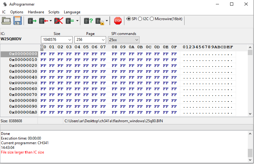

      thank you, i did chip 2 only and the laptop acted different ( fan spins and stops several times ) but still not coming on , tried to flash chip one with the other file but i got error (Error: Image size (8388608 B) doesn't match the flash chip's size (1048576 B)!)

        ...tried to flash chip one with the other file but i got error (Error: Image size (8388608 B) doesn't match the flash chip's size (1048576 B)!)
        You doing something wrong I'm afraid, did you use AsProgrammer "? button" first and select matching chip name from the drop down menu?
        Post AsProgrammer screenshot here.

          i left it for half an hour as i thought the same, i use flashrom , its the same whit asprogrammer , the data size is bigger than 8 , mb
            Re: I have big problem with x360 g2 1030 bios
            You`re trying to write to a W25Q80,its a 1MB chip.
            W25Q80: 8M-bit / 1M -byte (1,048,576)

              yes the file been uploaded is over 8mb , chip is one mb

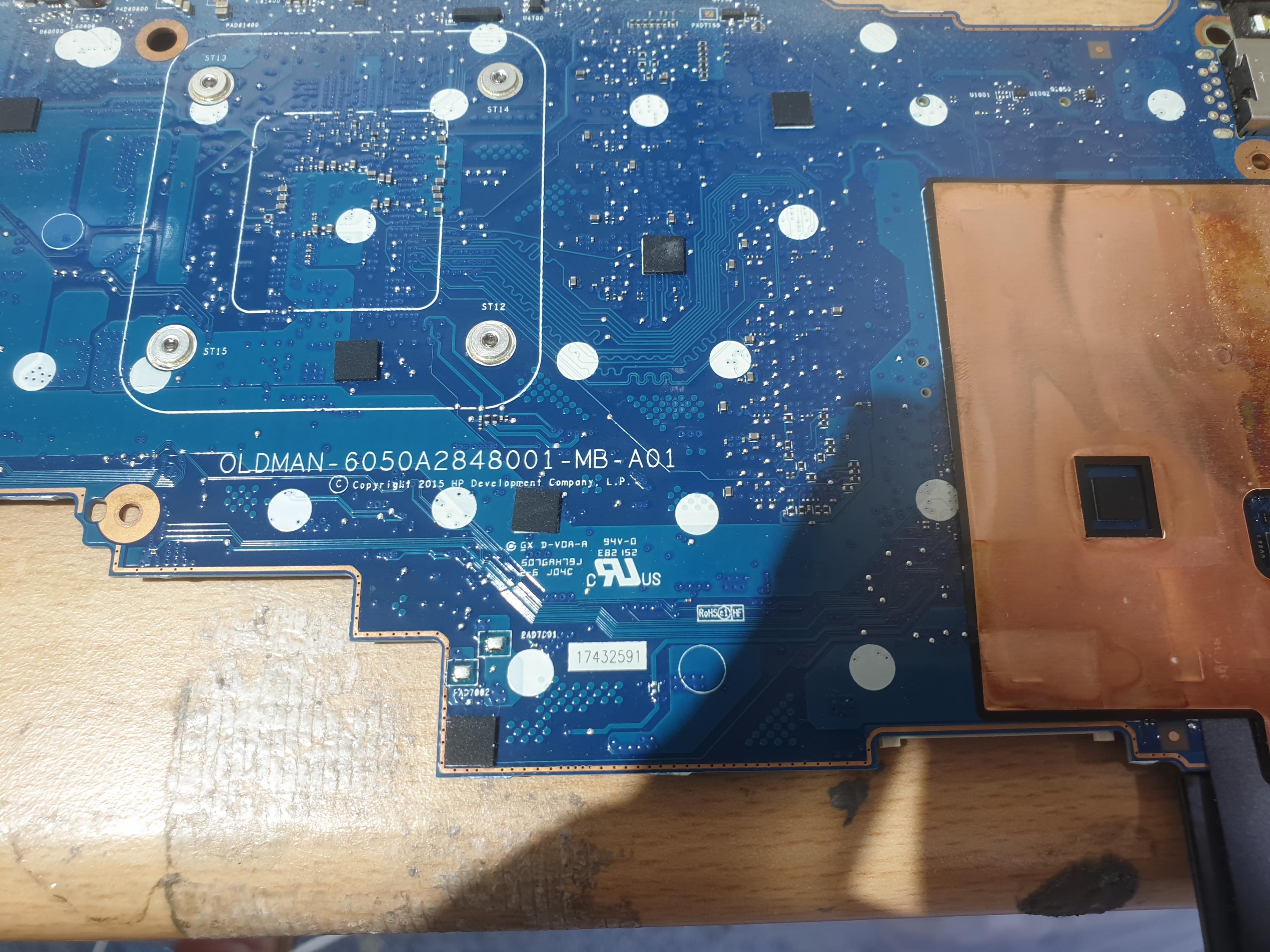

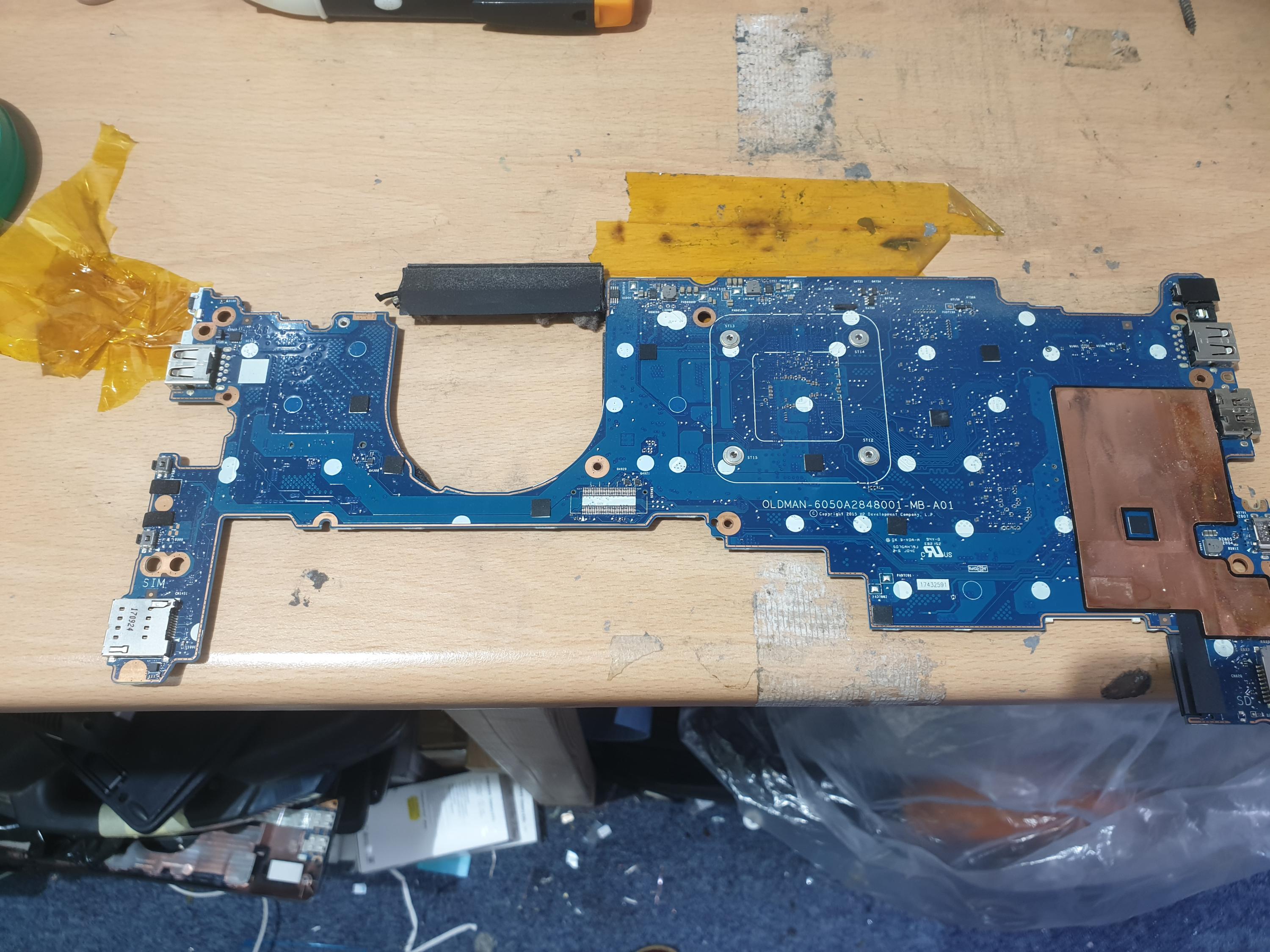

                  Here it is I had to remove the motherboard to get it

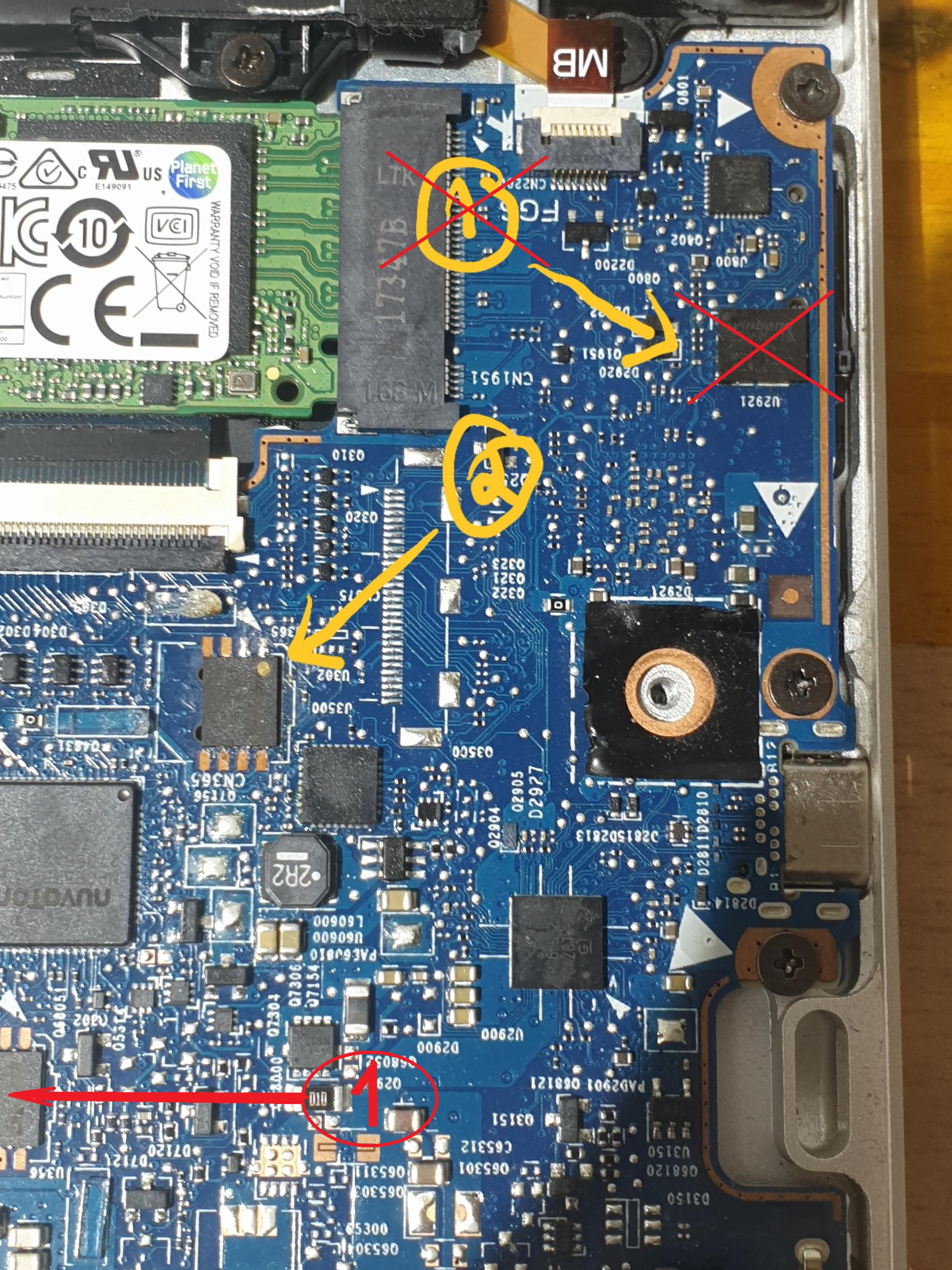

                    I think I found the problem, the chip at the red arrow must be 25Q64FV, which is actually the second bios (8MB) chip :
                    P.S. OLDMAN-6050A2848001 -yes, must be exactly x360 g2 1030, so flash the 25Q64FV with the 8MB file (make backup first) and (fingers crossed) it should come on.

                                  Good afternoon., can someone do a cleanup of the Hp EliteBook x360 1030 G2 Serial # 5CG80343VW (MB OLDMAN-6050A2848001-MB-A01). Both the BIOS Bin files are upload. The problem is no display, I observe the CPU is turning hot & the MB is taking nearly 1 amp but stuck on that. Thank in advance
