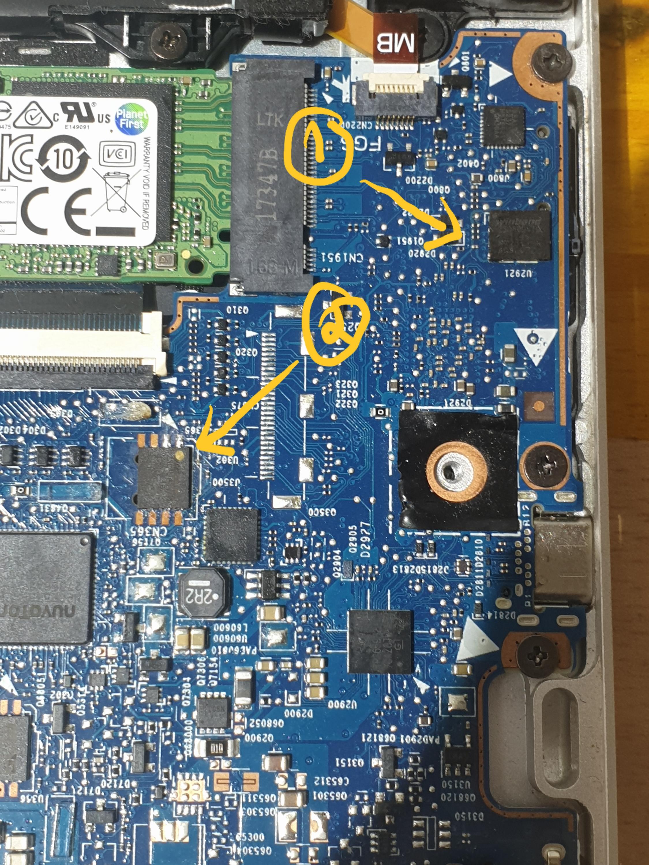

I have big problem with x360 g2 1030 bios
+ More Options
Posts
  • layad
    • Nov 2011
    • 244
    Hi there , a laptop came with bios password , checked the laptop inside and found two chips, the first one is 25q80dv1g( number 1 in the pic), and 25q128jvpq (number two in the pic) , first I flashed chip number one with a dump file found it in this forum, nothing changed, the laptop still working and the password still there, I flashed the second chip with the same file the laptop died , the backup file is corrupted , bought a chip from Ebay but still the same , anyway to sort out chip number two ?
  • piernov
    • Jan 2016
    • 4437
    • France
    Re: I have big problem with x360 g2 1030
    What programmer did you use?

      ch341a, asprogrammer and flashrom
      • piernov
        • Jan 2016
        • 4437
        • France
        I don't have a CH341A, but I've seen people having a lot of problems with 128Mb chips when trying to dump/flash them with CH341A.
        • Vesko356
          VIP Moderator
          • Aug 2018
          • 4386
          • Bulgaria 🇧🇬
          Files for chip 1 and 2 are different, flash the chips with corresponding images, verify the written files to make sure the chips are correctly programmed and you are good to go, nothing hard or special.
          Try AsProgrammer with CH341A support

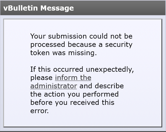

          Edit: I'm trying to upload the bios files, but permanently receive same error :

              I just tried again and got the same error . I sent a message to the moderator about the issue. In the afternoon I will try again, if the problem persist I will upload the files to Dropbox and will post a link in the thread.

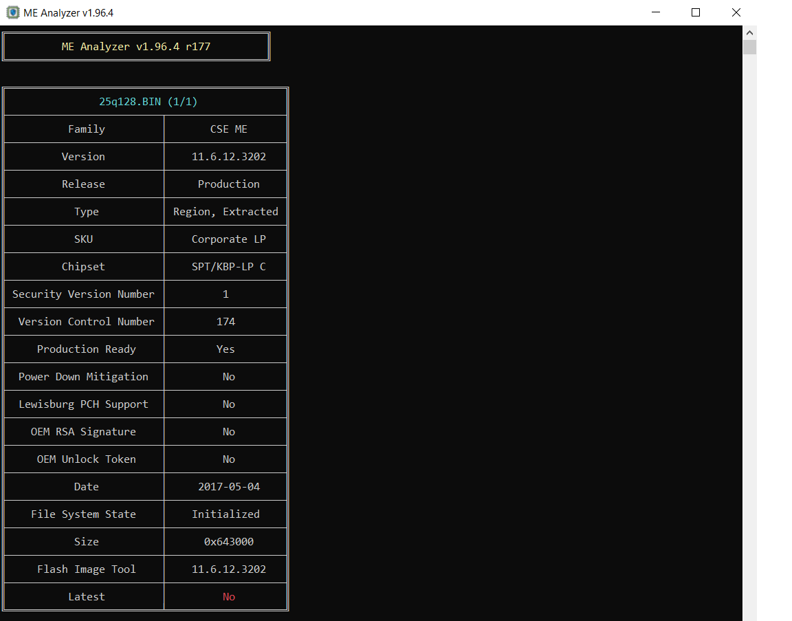

                The problem is with the 25q128.BIN. It won`t upload zipping it seperately,the file is corrupt somehow

                  I don't think so, most probably it's a forum platform bug:

                    I didn`t mean the ME management engine firmware, i meant the part of the whole file,something isn`t right with it, its not the file attributes or size.It could be NTFS related.
                    Anyway the ME firmware is initialized which means its been booted on another machine already, the ME is "dirty" so it would need cleaning, i tried that,the file is still not uploading. I don`t think its a forum platform bug.

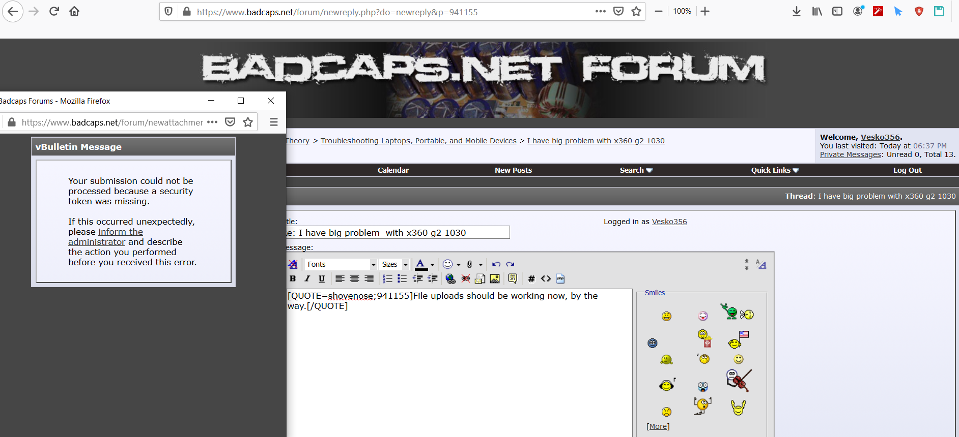

                                  File uploads should be working now, by the way.

                                    No, still same problem:
                                      Strange, they seem fine on my end. What file are you trying to upload?
                                      • Vesko356
                                        VIP Moderator
                                        • Aug 2018
                                        • 4386
                                        • Bulgaria 🇧🇬
                                        This one:
                                        https://www.dropbox.com/s/uww3qb1umt...01030.zip?dl=0
                                        And same problem with the file from this thread.
