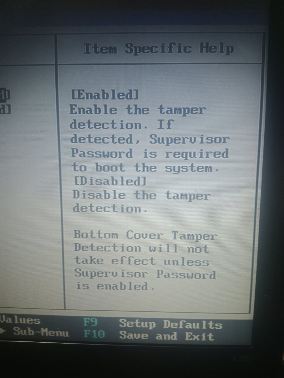

                [ NOTES ]
                When booting the patched BIOS you might have to:
                - Hold the anti-tamper switch down the whole time (use tape)
                - Remove the hard disk or replace it with a locked one

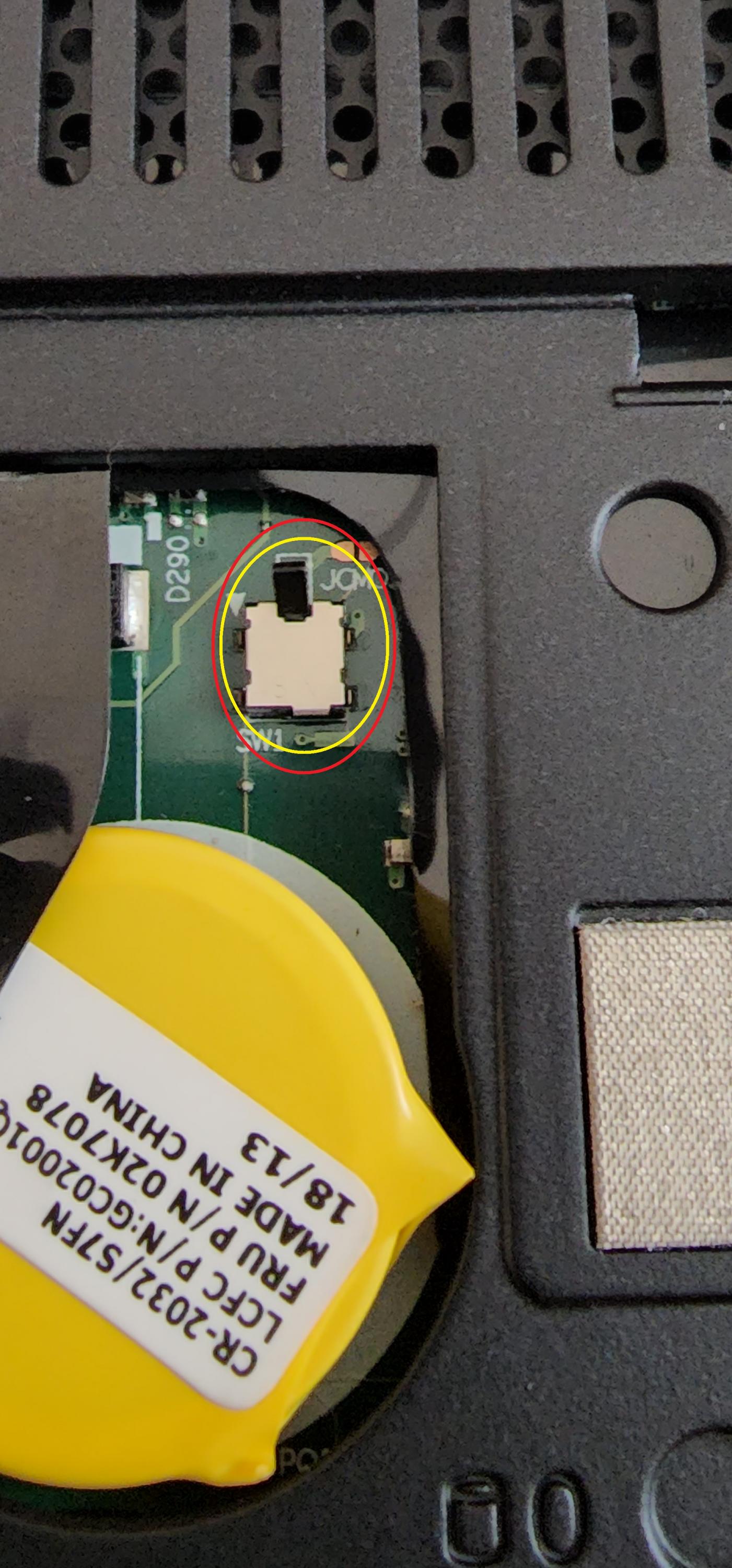

                  Re: Help, Patch Bios for Unlocking Password Thinkpad X280
                  That switch looks like this.
