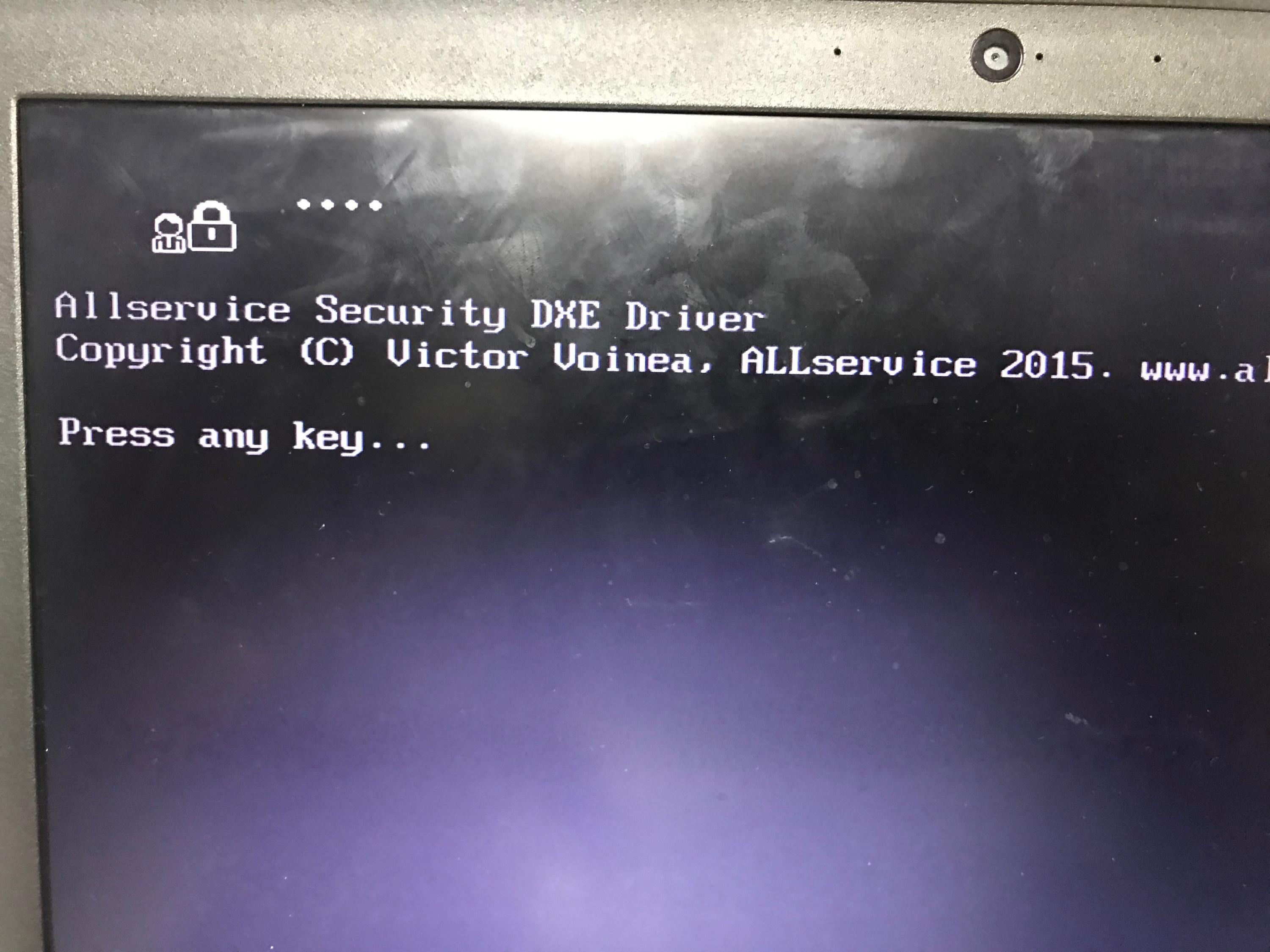

      #102
      Re: Lenovo Unlock Dxe Driver Bios Collection
      Worked just fine on T440p, thank you!
      My method: I took another 25Q32 chipset and wrote the patched file with CH341A programmer - I didn't "touch" the original chipset, read erase or write - I followed the steps described, after all was done I replaced the chipset with original one and restored factory settings in BIOS. No beeps, no errors except when I turned on 1st time with original chipset I had a checksum error fixed by updating bios with last version.

                                #115
                                Patched file for X270 didn't work for me, failed after asked for key for hardware id. (invalid key) I took a patched file from https://www.badcaps.net/forum/showth...highlight=X270
                                and worked.
