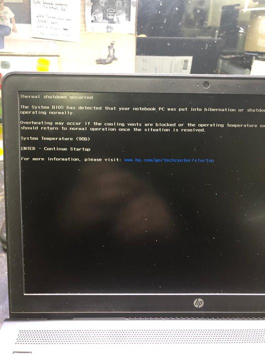

          image comes in 30 seconds
          fan rotates too fast and gives this error
          shut down when enter

            Both those bios posted are BID0836B (KABYLAKE H) ,the bios update has 4 different ones. Check your cpu ID by the part number on the CPU,or check the laptop models spec page,get the bios from: https://www.badcaps.net/forum/showthread.php?t=81556

                  Hi did you solve this problem i have 2 machine the same problem i checked cpu model and used correct bid bios dump nothing changed..
                  Also i tried all suitable ME file but still delay 45 seconds.

                      Try the virgin bios and EC, if it doesn`t work then your problem is somewhere else. https://www.badcaps.net/forum/showthread.php?t=81556

                              The bios is different from what you wrote. The SN is different and the model is different.

                                You wrote a BIOS dump from another laptop with an initialized ME region, that's why you get issues, do you have the original (corrupted) BIOS?
                                If not, fix the serial, product number, with HP BCU
                                https://ftp.ext.hp.com/pub/caps-soft...it/HP_BCU.html
                                Clean BIOS extracted from HP website, ver F.41 with (wrong) serial inserted from your BIOS dump
                                BID 0836B
                                DMI 220000-22803F
                                • omran1@!

                                  i dont have the original dump
                                  and this bios dont work

                                    Try with clean F.06, same version as your "working" BIOS
                                    If it works use HP BCU to fill serial, model, product ID, build ID, feature byte, etc.
                                    First boot may take long time, it's clean ME
                                    Code:
                                    Serial Number:  5CD7259DZ9
                                    SKU Number:  2FL07PA#AB2
                                    Product name: HP Pavilion Power Laptop 15-cb0xx
                                    Build ID: 17WW2NFT604#SAB2#DAB2
                                    Feature Byte: 3K6b7K7M7WaYapaqatawbhbzcbd7d8dUdXdpdqfg.fQ
                                    System board CT number: PGPUA028J813DR

                                      thx its good but the gpu nvidia dont show in the device manager
