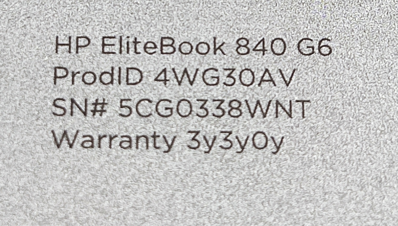

            Hello,i need help, it's a locked laptop hp 840 g6, which after unlocking gives an endpoint security error, I've tried almost all files from the forum. it doesn't work, it throws an error, I'm sending you the original locked files. please unlock them, and remove the endpoint error.

            #386
            only flash this main do not touch the EC.
            follow these instructions.
            First boot press f10 reset bios to factory defaults and exit, 2nd boot reset security settings to defaults.
            use BCU permanently disable the absolute there.
            here's your DMI info:
            Serial Number: 5CG0338WNT
            Product Number: 4WG30AV
            CT Number: PHWGH00WBE3D13
            Description: HP EliteBook 840 G6
            build_id: 19WWCFCT601#SABD#DABD
            Feature Byte: 3X476J6S6b7B7H7M7Q7W7m7saBaEapaqauawbUbhcAdUdpdqfPfXhKhkjhk8.y8
            MAC Address: 84-2A-FD-C7-EB-84

              #387
              Great work REX98, thank you so much. now is ok.

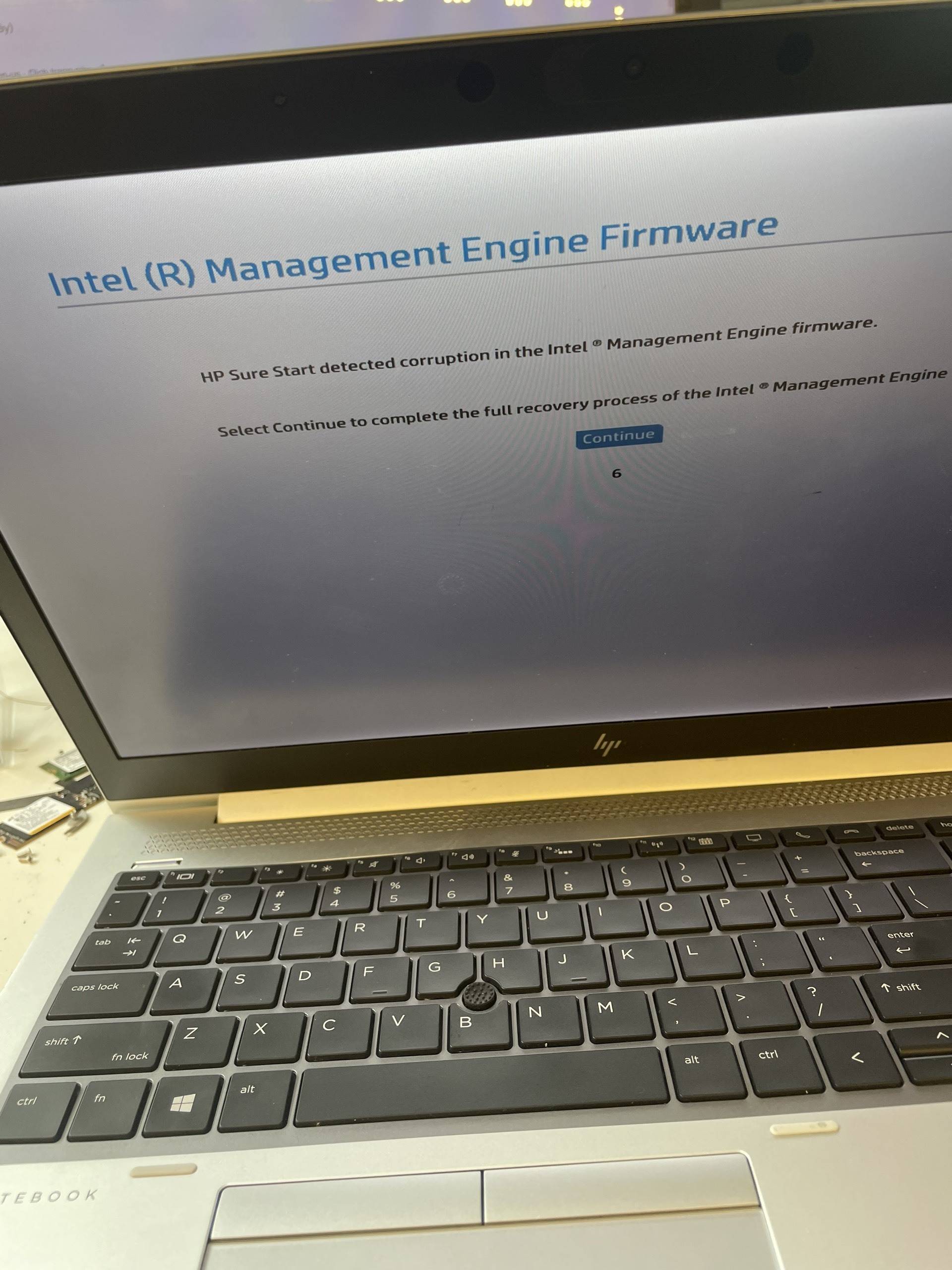

                                hello friends i need remove password and clean me hp elitebook 840 g6
                                and i have this message
                                hp endpoint security controller problem
                                i need resolve this message
