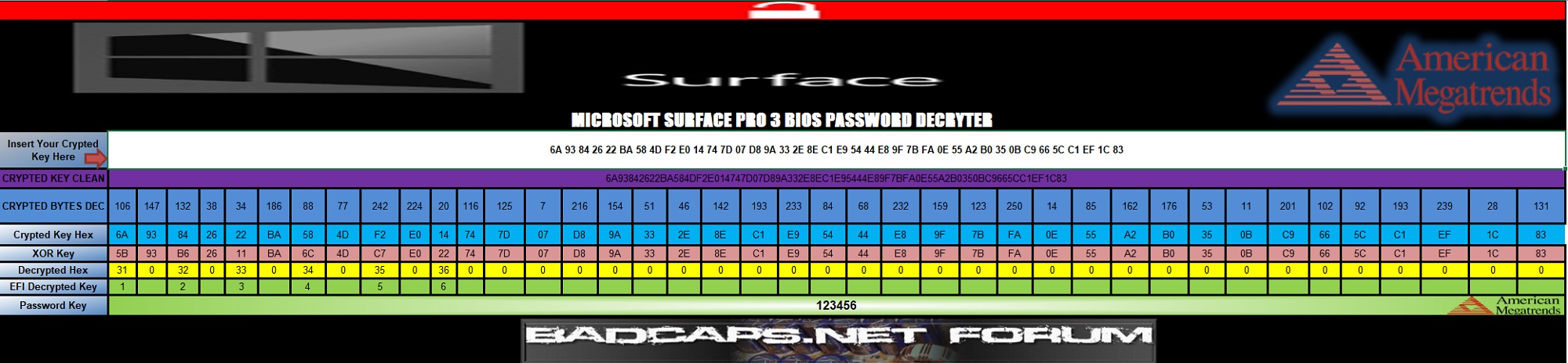

              Hi everyone can you help me with ta file i cant decrypt that can you explain how to decrypt with excel ? thanks i put my file i hope i can get the password

                read
                https://www.badcaps.net/forum/showthread.php?t=103526
                try...
                goc31

                    hi again i cant find the line for the pass can you check it for me ?

                      AdmWin8

                        can you say me what line on the hex editor you take it?

                          https://www.badcaps.net/forum/attach...0&d=1641457272
                          use this software

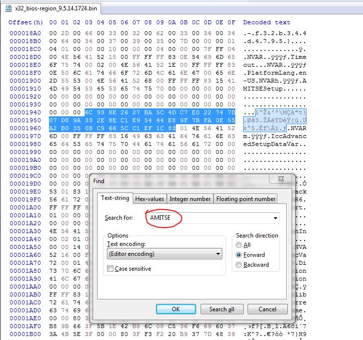

                                    The method and find the password and decrypter tools are all here in this thread.
                                    Open your bios with HxD hex editor https://mh-nexus.de/en/downloads.php?product=HxD20 search for the word AMITSE,keep pressing F3 to search for the next instance until you find the same as in the picture, copy the highlighted hex and paste into notepad, remove the spaces inbetween.Find the decrypter enter the hex and you should have the password.

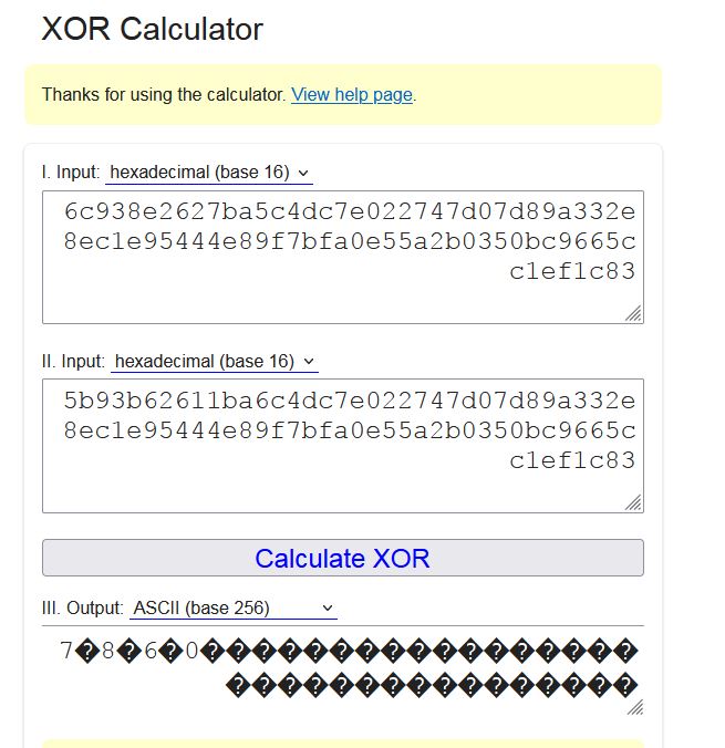

                                      i tried, but not work this my hex code 6C 93 8E 26 27 BA 5C 4D C7 E0 22 74 7D 07 D8 9A 33 2E 8E C1 E9 54 44 E8 9F 7B FA 0E 55 A2 B0 35 0B C9 66 5C C1 EF 1C 83

                                        Originally posted by rashmignanesh
                                        i tried, but not work this my hex code 6c 93 8e 26 27 ba 5c 4d c7 e0 22 74 7d 07 d8 9a 33 2e 8e c1 e9 54 44 e8 9f 7b fa 0e 55 a2 b0 35 0b c9 66 5c c1 ef 1c 83
                                        6c938e2627ba5c4dc7e022747d07d89a332e8ec1e95444e89f7bfa0e55a2b0350bc9665cc1ef1c83
                                        5b93b62611ba6c4dc7e022747d07d89a332e8ec1e95444e89f7bfa0e55a2b0350bc9665cc1ef1c83

                                          #320
                                          Re: Microsoft Surface Pro 3 UEFI password
                                          Unlock password pls
                                          thanks bro its working
