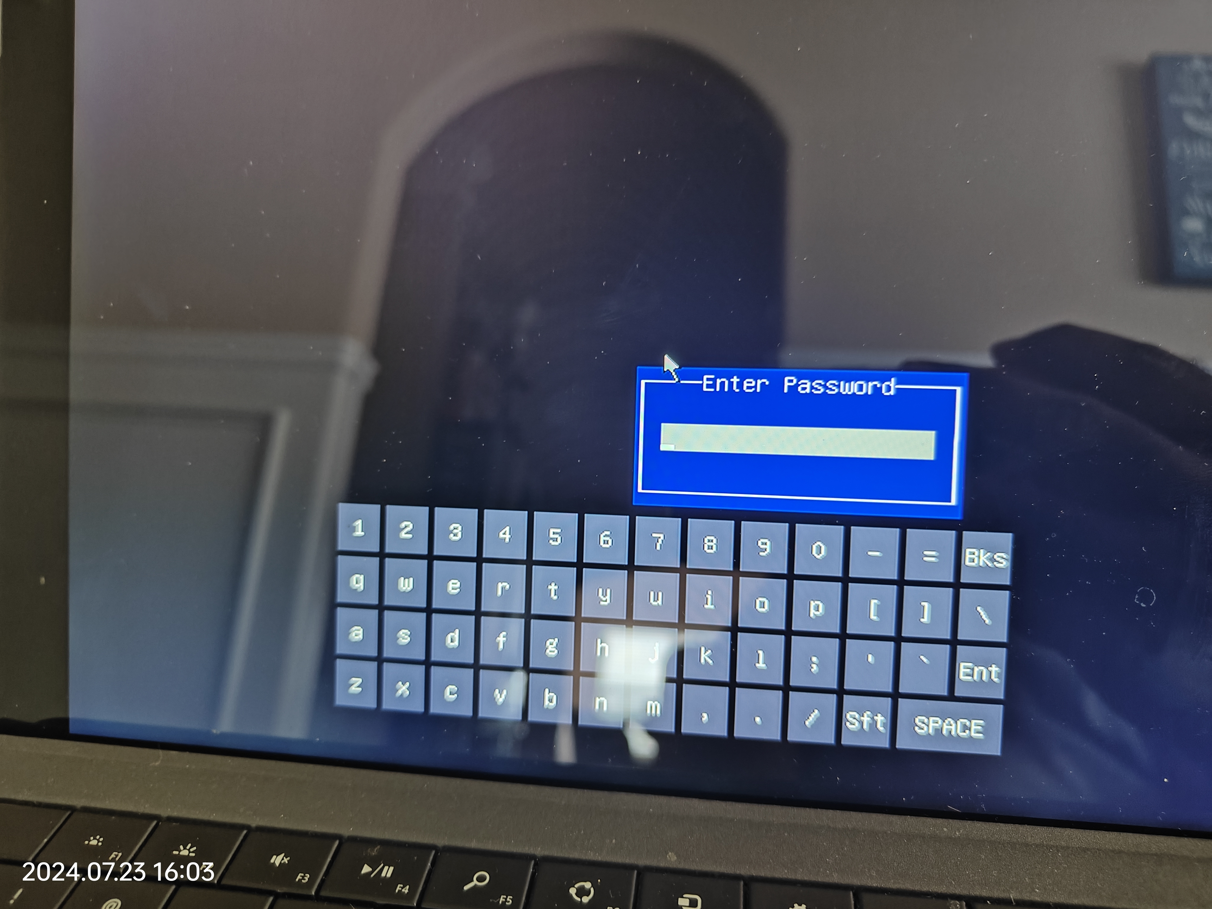

                  I recently bought a Surface pro 3 off facebook and found out that it has password lock. I do not think it is user password. This prompts right after the boot logo. I tried contacting microsoft support. they asked me to login to safe mode but its again go to password screen. Later suggested me to do a full recovery by downloading the zip OS from msft site. this is also not working as after i select the full recovery, it works till 2% and then it says failed to recover. attaching a picture for your reference. please help me in this regard.

                  subbucat attach BIOS backup from your surface pro 3. and attach pic from your motherboard and model part in mother.

                      Bro, thanks for the reply. The laptop is not letting me beyond the password screen or login to bios. How can I get the bios backup.

                          you need an SPI programmer..here is a video as an example...https://www.youtube.com/watch?v=DWWigscuQDY

                              You don`t have to take the screen off, read posts 13,16,17 .Use Flash Programming tool

                                    DHRUVPRO CH341A 24 25 Series EEPROM Flash BIOS USB Programmer + SOIC8 SOP8 Flash Chip IC Test Clips Socket Adpter Programmer

                                      No need to remove it. Use flash programming tool to read bios region and upload it. I can find and decrypt the password. This way you don't even need to remove the screen to unlock this model.
                                      Hi bro, i cannot login to bios or windows. How can I use flash programer to upload the unlocked bin?
