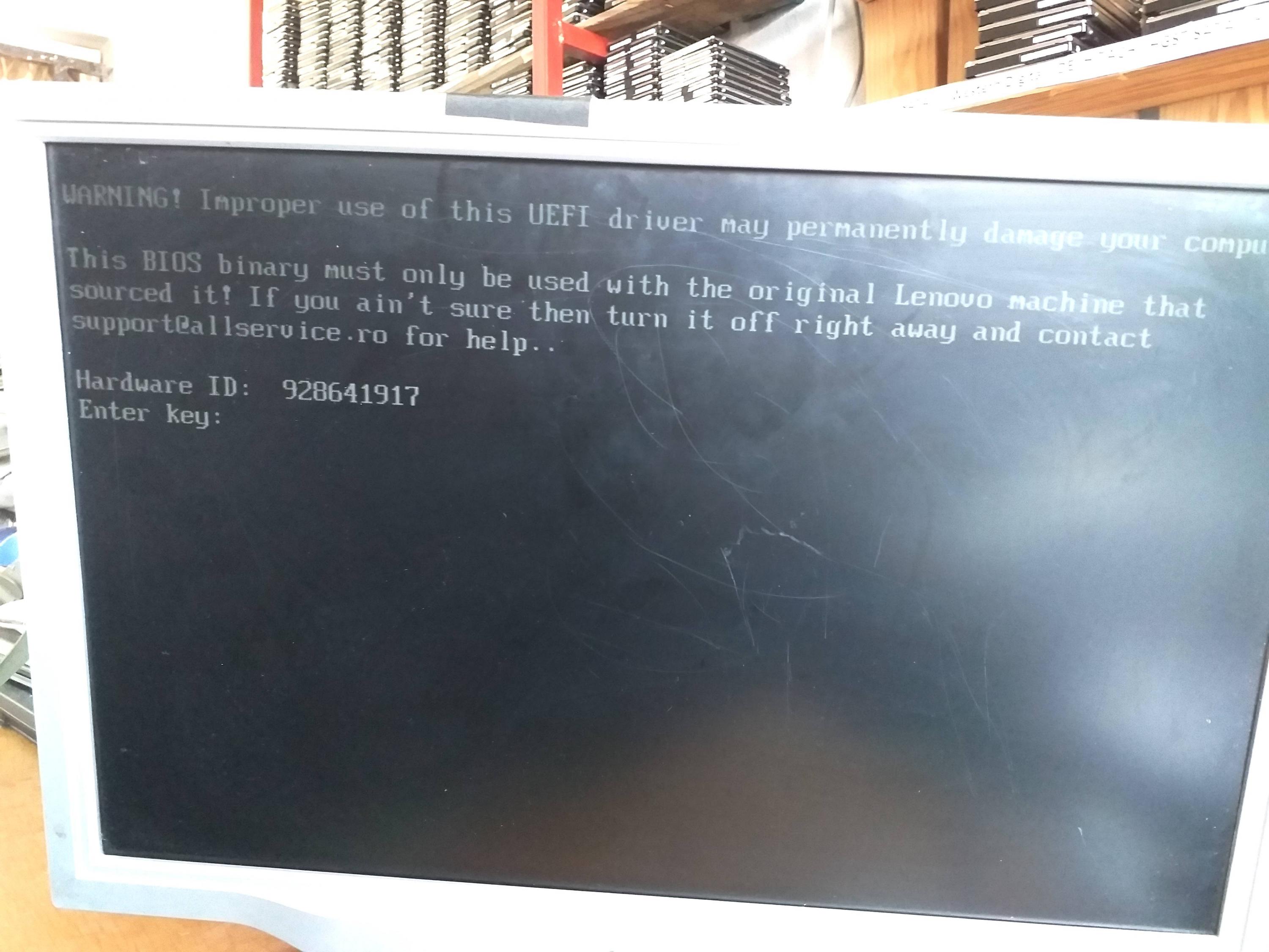

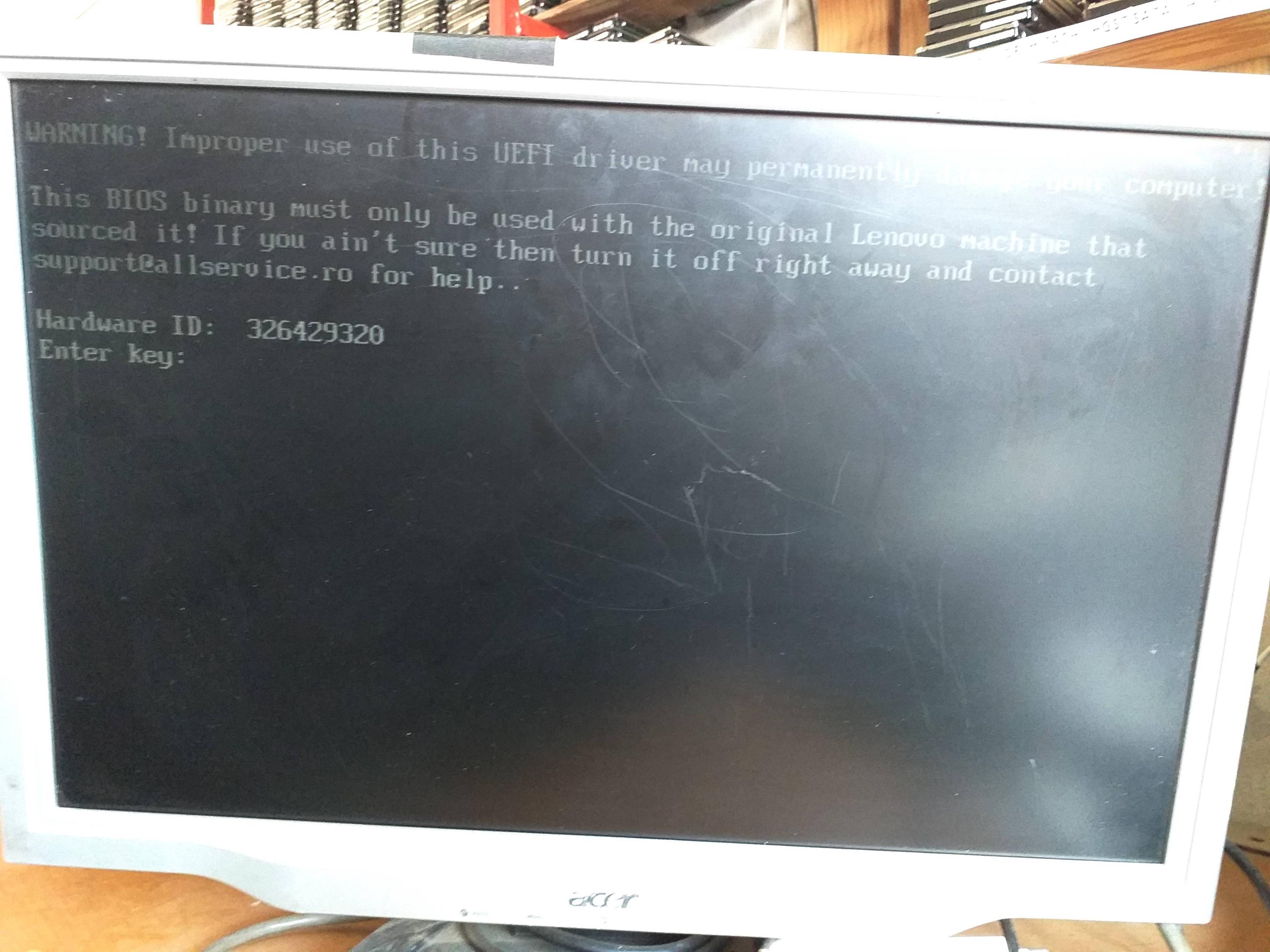

                        Re: Lenovo ThinkPad T540P LKM-1 SWG2 MB 12308-2 48.4L016.021 PASSWORD
                        LENOVO THINKPAD T540P
                        I flashed a patched bin file now the laptop is OFF the fan spin 5 sec and stop
                        same things with original bin file.
                        Any idea about the error?

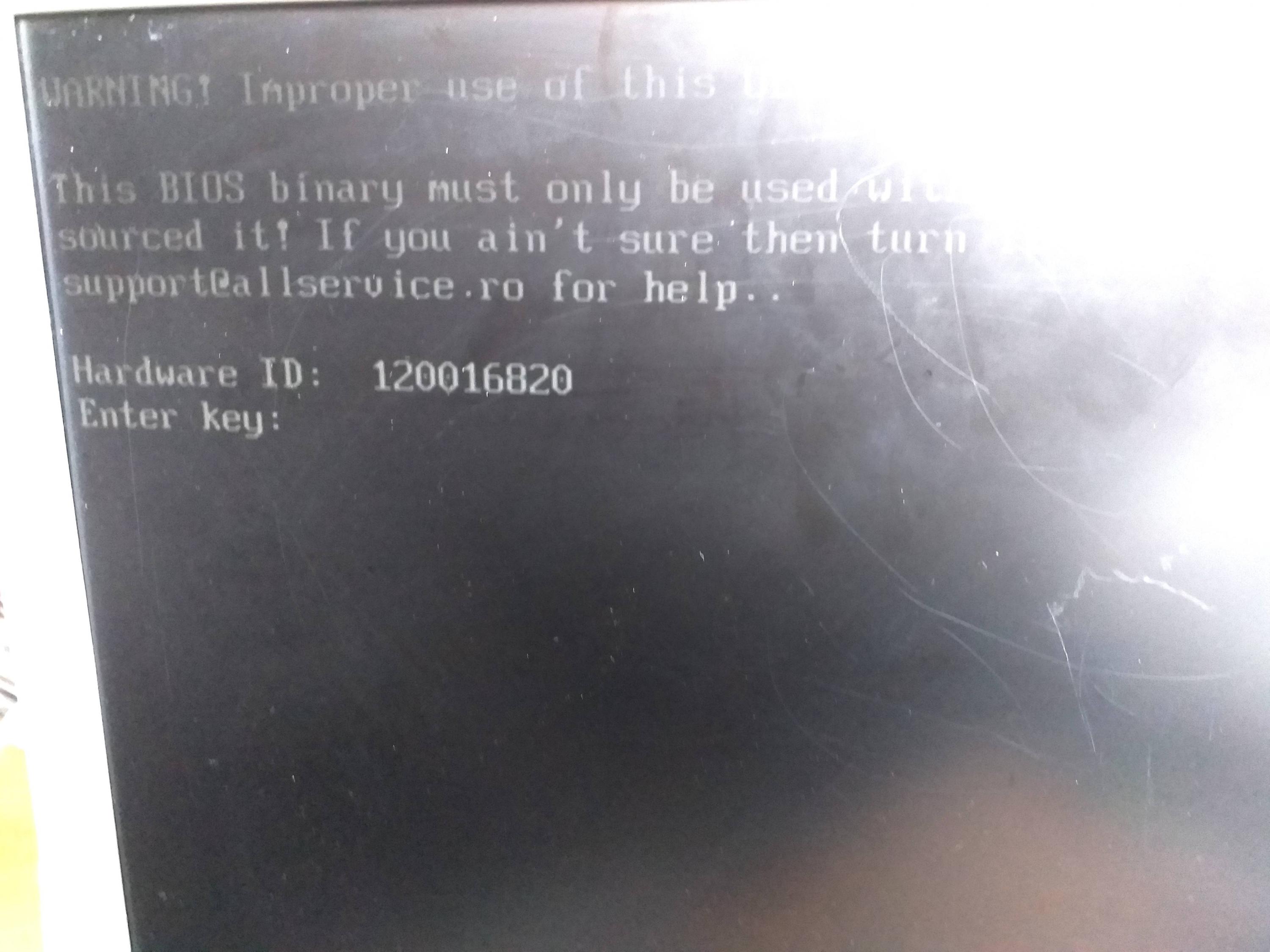

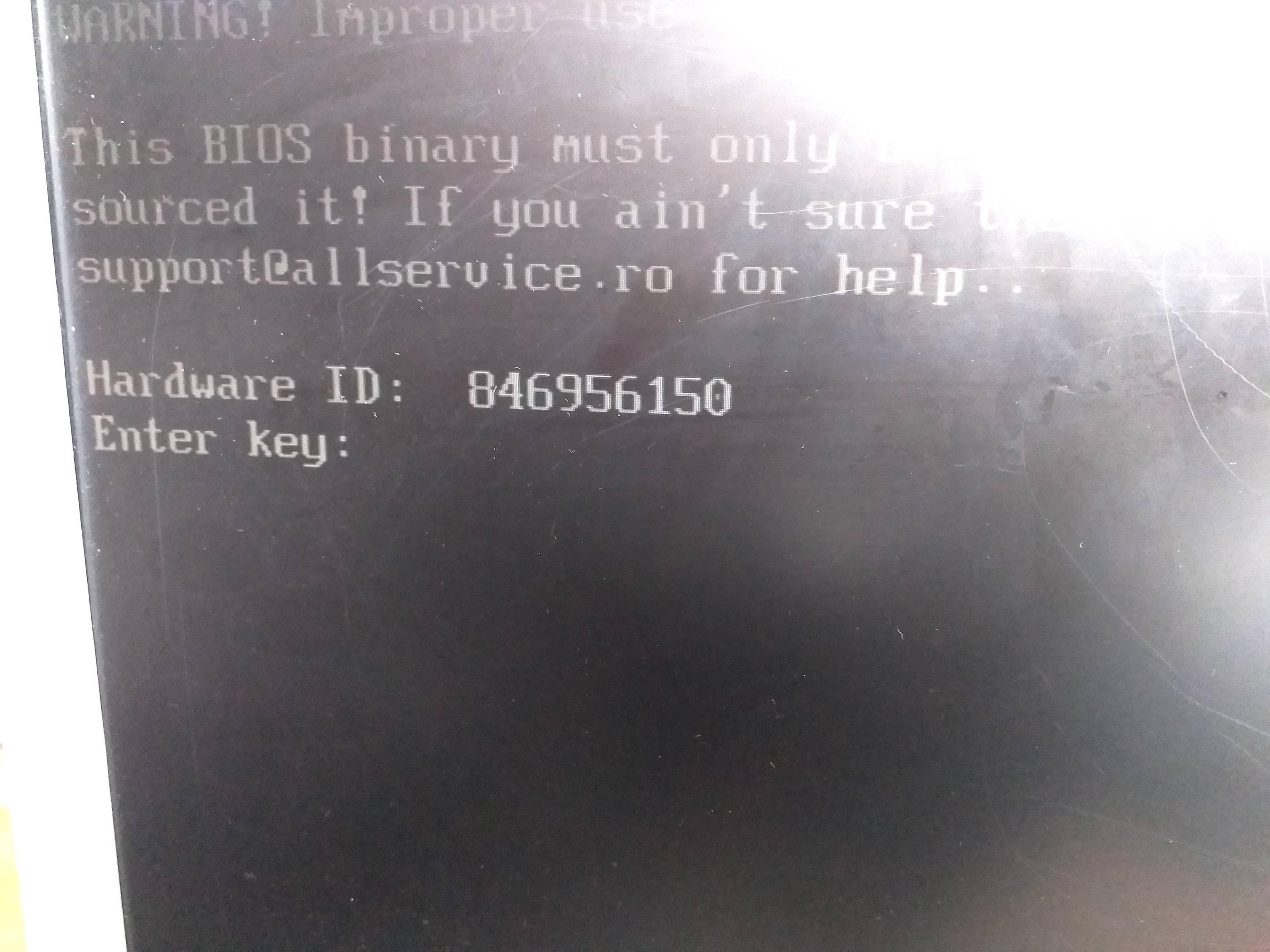

                          T540p BIOS black screen issue
                          Hello all,
                          laptop turns on,but with black screen (screen tested good on another maschine).
                          Can anyone take a look and patch eventually attached dump pls. ?
                          Thank you!

                              Re: T540p BIOS black screen issue
                              Thank you Hoaca388,
                              but it is power cycling every 3 seconds now...
                                OK,since original bios dump was a nogo i used both chips from machine with fried board.
                                And it`s working just fine
