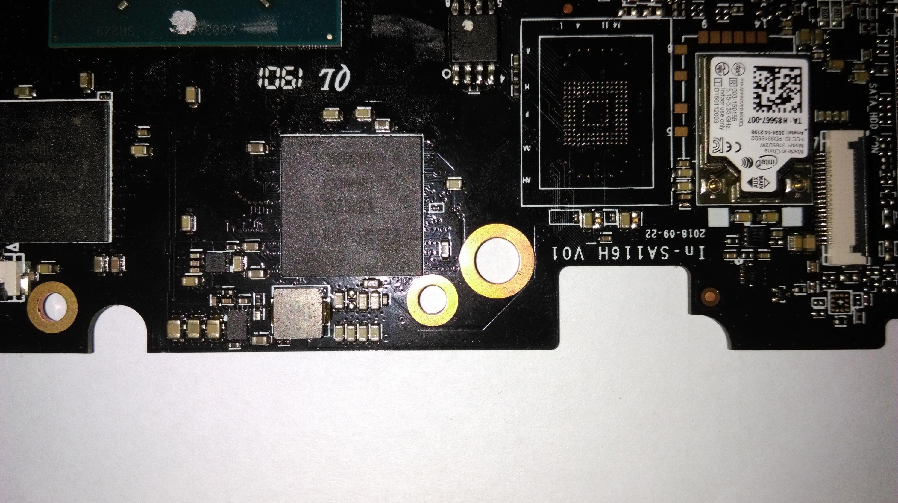

    Hi .. I need bios for In-SA116H_V01 motherboard,or someone to fix this ...
    thank you...

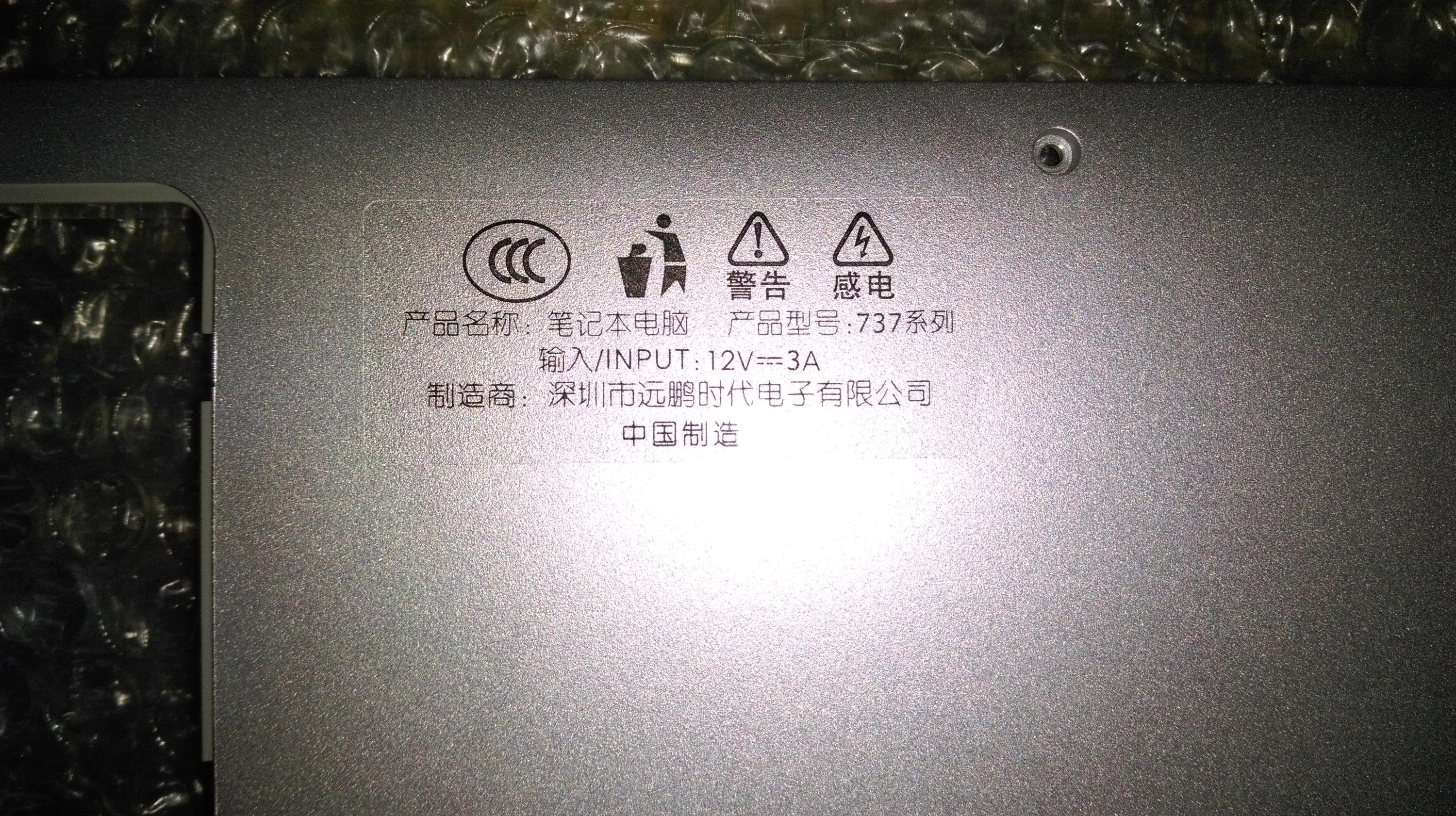

          Re: Yepo 737in
          Are you sure about the model number 737in ?

            Re: Yepo 737in
            i think he mean 737i...
            the popular one is 737a, same as my backup

              Re: Yepo 737in
              He writes in Chinese, so he translated the application from my phone, but what he writes on the motherboard is ok.

                Re: Yepo 737in
                motherboard.
