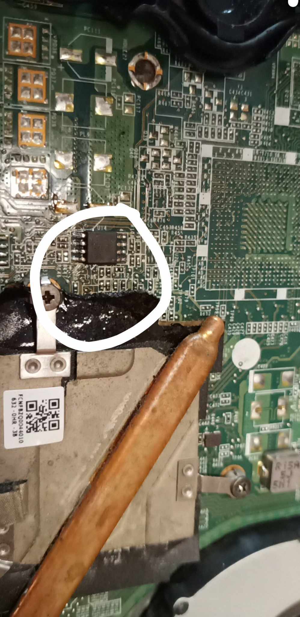

    Hi this board has no power but I tired diffrent bios it turns on but it has no display maybe incompatible bios
    BOARD : DA0ZQ0MB6E0 REV.E
    SNID: 55302308576
    I HAVE BACKUP TO.

              IT8587E CODE
                • 20795
                Re: Acer travelmate p246 series bios
                Originally posted by kalilinux25
                How can I check it sir?
                IT8587E CODE
                schematic https://www.badcaps.net/forum/showpost.php?p=697265
                Programmable and non-programmable SIO list https://www.badcaps.net/forum/showthread.php?t=66963

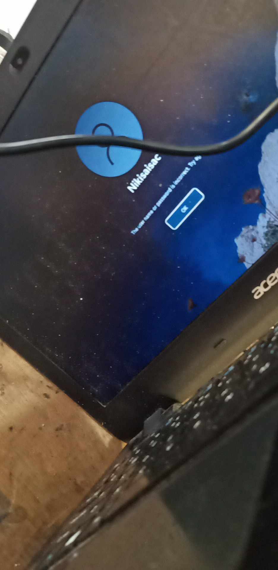

                          Originally posted by peste
                          try..

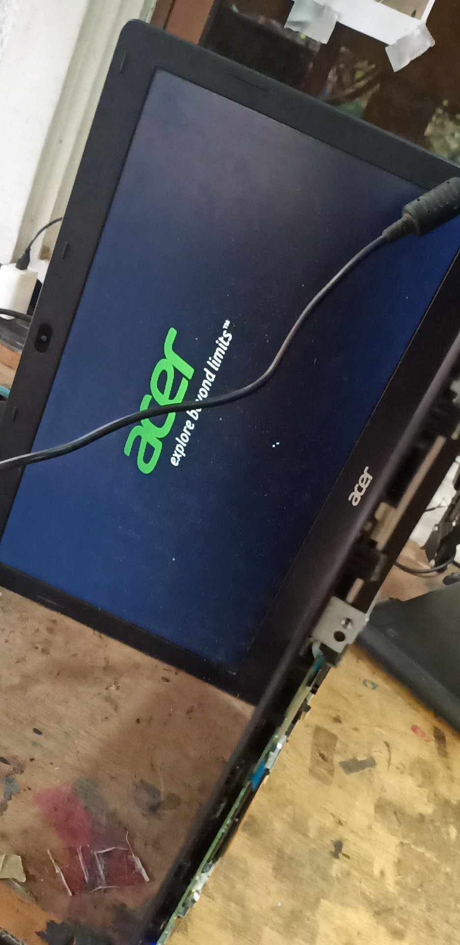

                          thanks bro
                          perfect working bios..
                          • gyro10
                            • Sep 2020
                            • 20
                            • Philippines
                            try..
                            tnx work 100%
