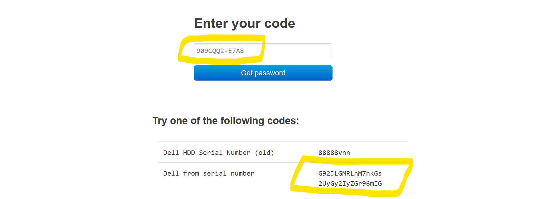

              Dell Latitude 7390
              Reg Model: P28S
              Reg Type: P28S002
              System Number: 909CQQ2-E7AB
              *Service Tag SN: 033759
              Motherboard: DAZ20 LA-F312P Rev: 1.0 (A00)
              *Issue description:
              i need Clean up Password Bios
              Many thanks in advance
              *Original dump
              Unlock Done

                Originally posted by DZ-Developer
                Dell Latitude 7390
                Reg Model: P28S
                Reg Type: P28S002
                *Issue description:
                *Original dump
                This is the second time today I am making a remark for you to read the rules!
                BIOS guides, methods, resources and tools
                Password removal by laptop brand
                3.4. Dell
                Dell laptops store the password in EC. However, some generators exist depending on the code suffix.
                See: https://beta.bios-pw.org/ .
                Note: The 6FF1 suffix has a bug,use your service tag with the BF97 suffix instead,Example: 1234ABC-BF97
                There is no publicly available 8FC8 generator available at the moment.
                The CTRL-ENTER-ENTER keystroke after the password only applied to laptops with a suffix (xxxxxxx-8FC8 for example), until Dell also required it in some laptops using System Disable 16-Hex algorithm, on which only the Password+ENTER was needed at first and then in some models you needed the CTRL-ENTER-ENTER to properly delete the system passwords, otherwise the password would remain SET upon the automatic system reboot if just doing Password+ENTER until the proper CTRL-ENTER-ENTER keystroke was performed in certain models.
