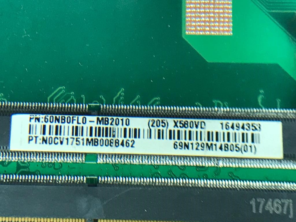

                                N580VD-DM027T
                                BOARD : X580VD REV 2.0 clear me bios I will be glad if you share what is necessary please.

                                  • 21446
                                  Re: Asus Vivo Book X580VD BIOS Needed
                                  Originally posted by syntaxzone
                                  N580VD-DM027T
                                  the old non-image replacement.
                                  Try the ME cleaning guide - https://www.badcaps.net/forum/showthread.php?t=88533
                                    my shared bios not screen.. first old bios.. i did clear me other but drivers cannot be installed
                                    and nvidia is not finding or identified..

                                      • 21446
                                      Post a good clear readable picture of the white sticker on the RAM slot
                                        thanks
