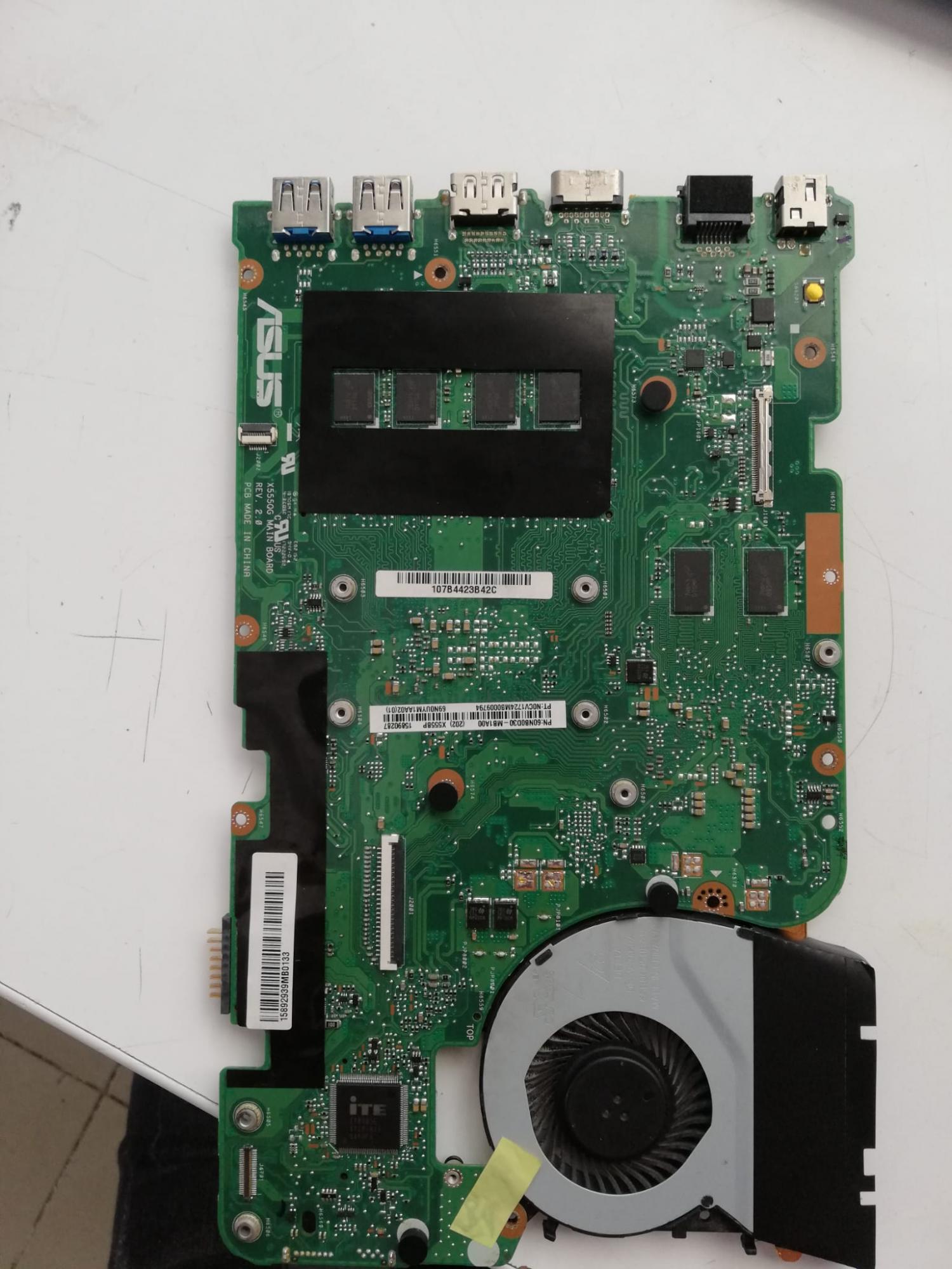

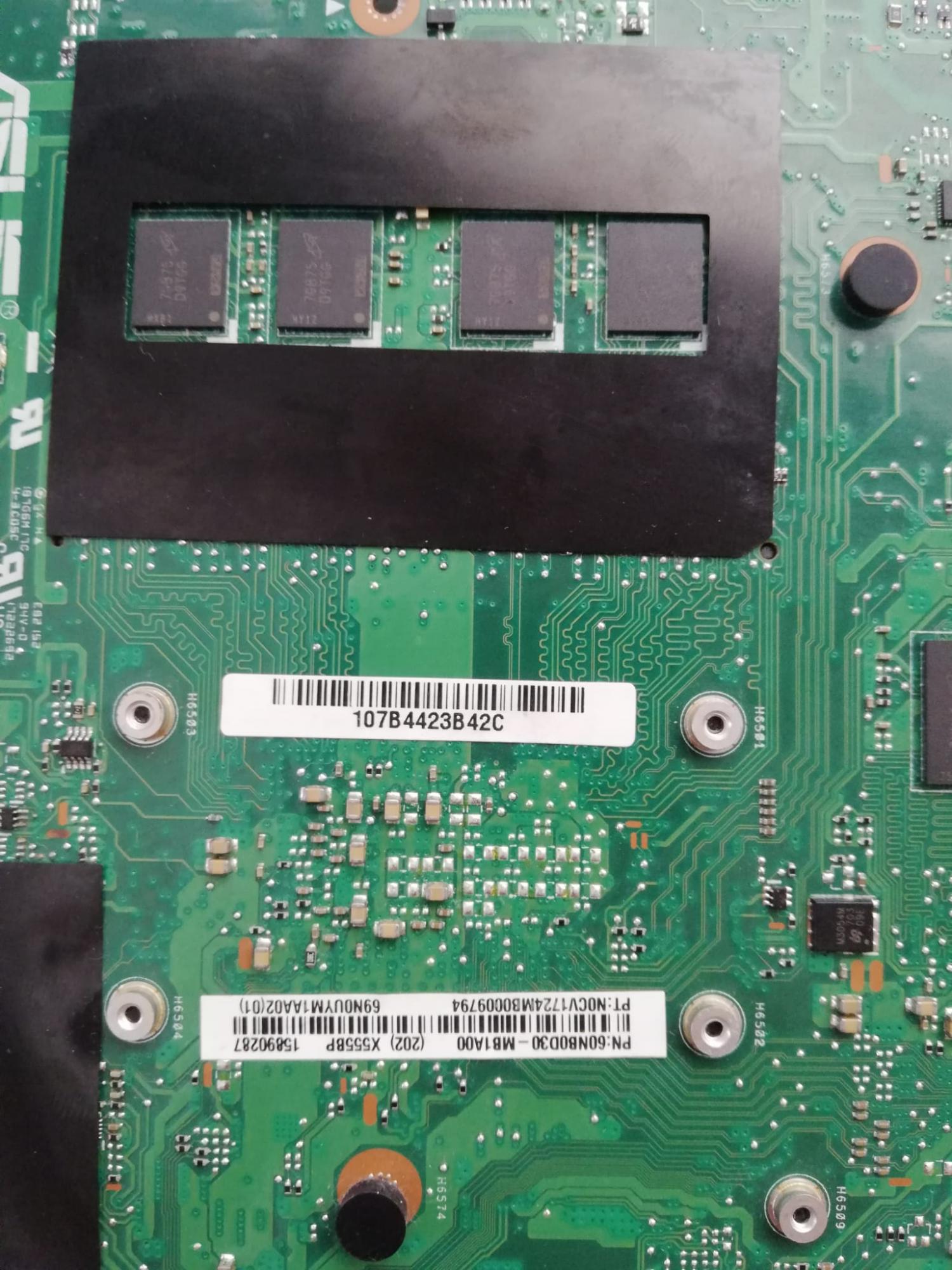

              Post a picture of the white/green sticker on the motherboard, its the one with a barcode/QR code and a model number.Its usually near the ram/ram slot

                #47
                Re: Dump ASUS X555QG Please!!
                there are only these tags

                    #49
                    Originally posted by byavci
                    I'm writing with a superpro xeltec sp500 device, it hasn't had any problems so far
                    The sticker model is X555BP ,the bios posted by peste ia AOK and i agree with him that the problem isn`t with the bios,its somewhere else .

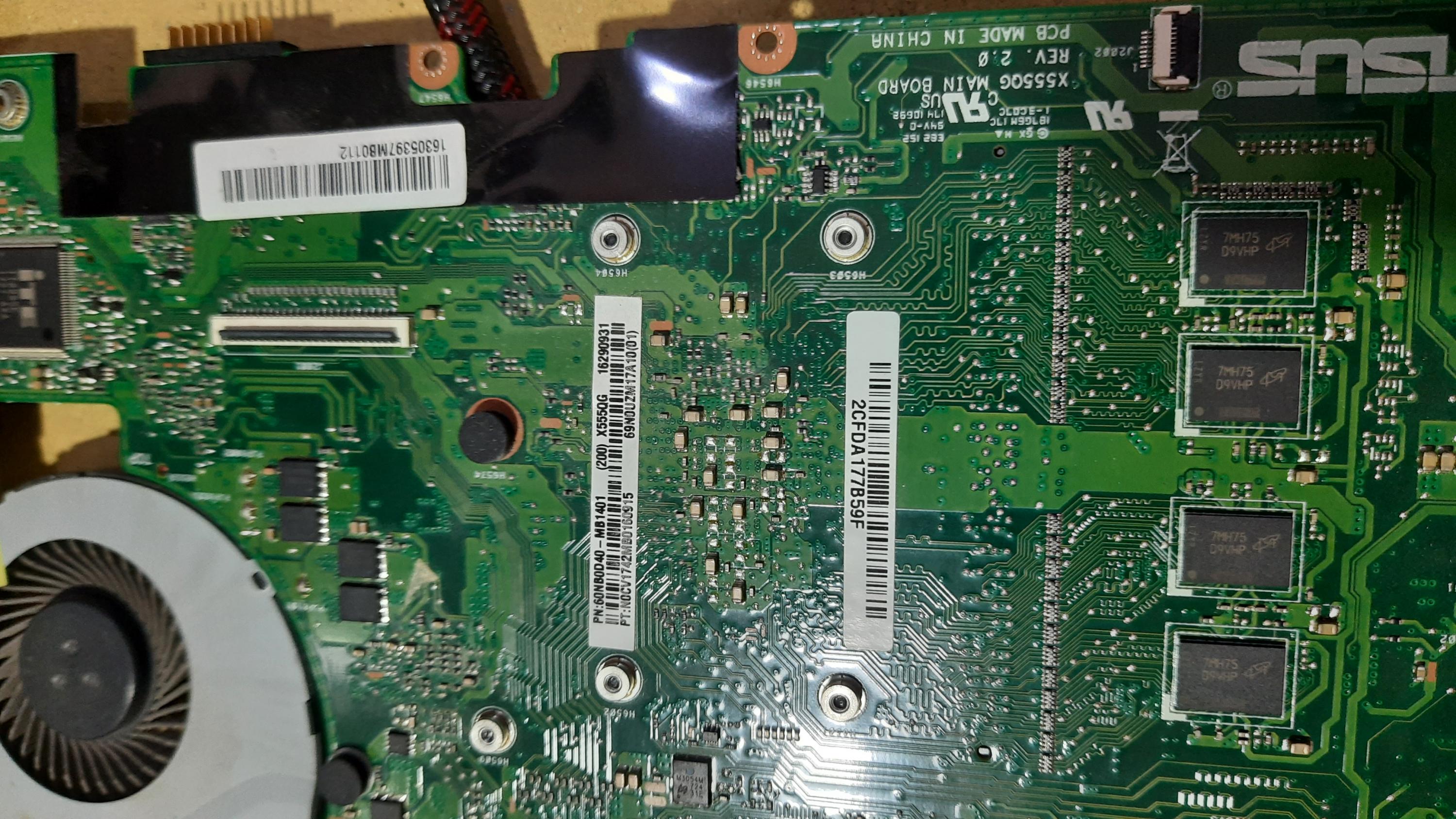

                        Hai guys, i had already try 2 bios file from above, but still got no display, plz if anyone can help. This is my original bios backup file and my serial number.
                        My mainboard is X555QG Rev 2.0

                          #52
                          bios extracted from the Asus site update

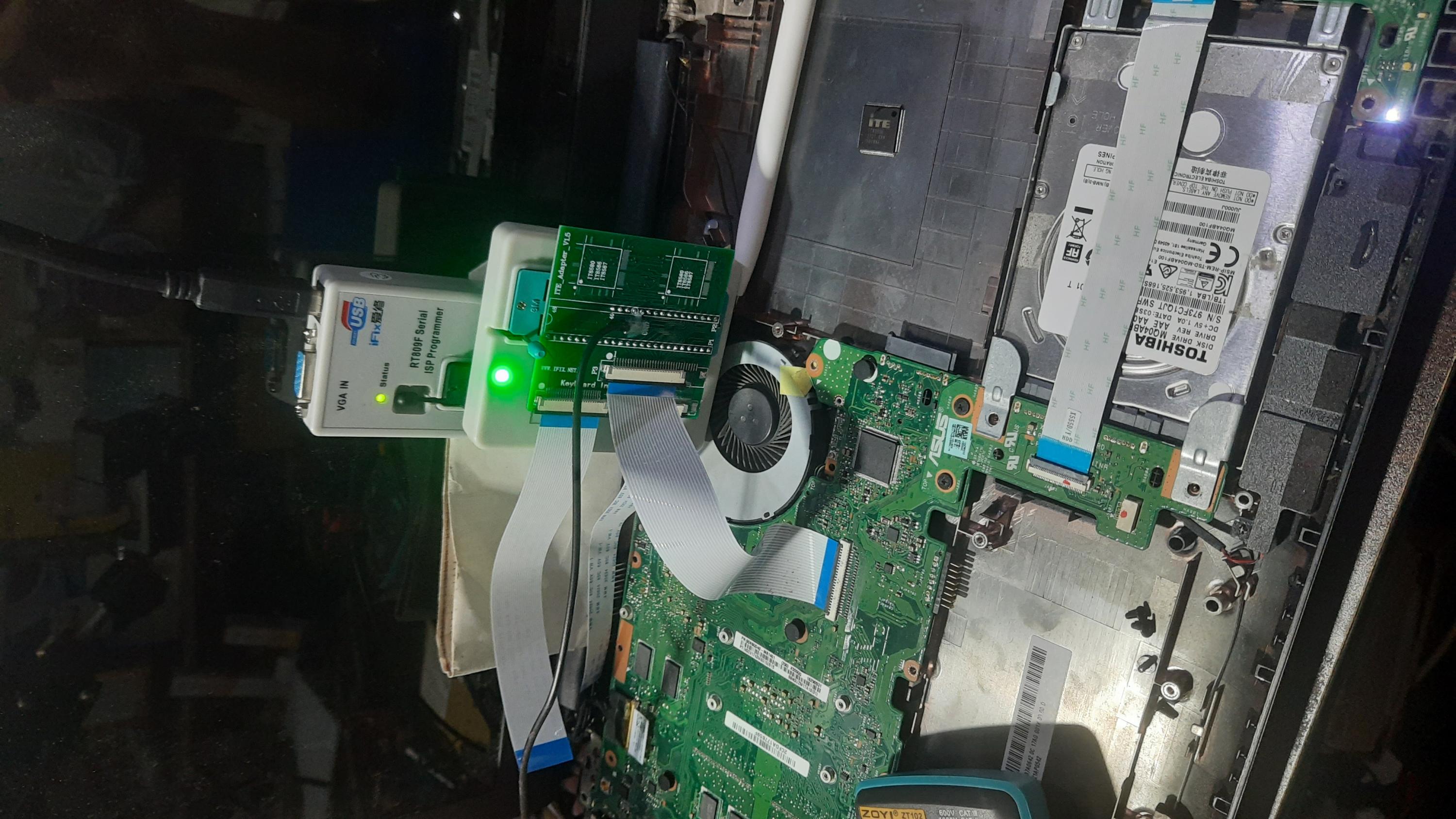

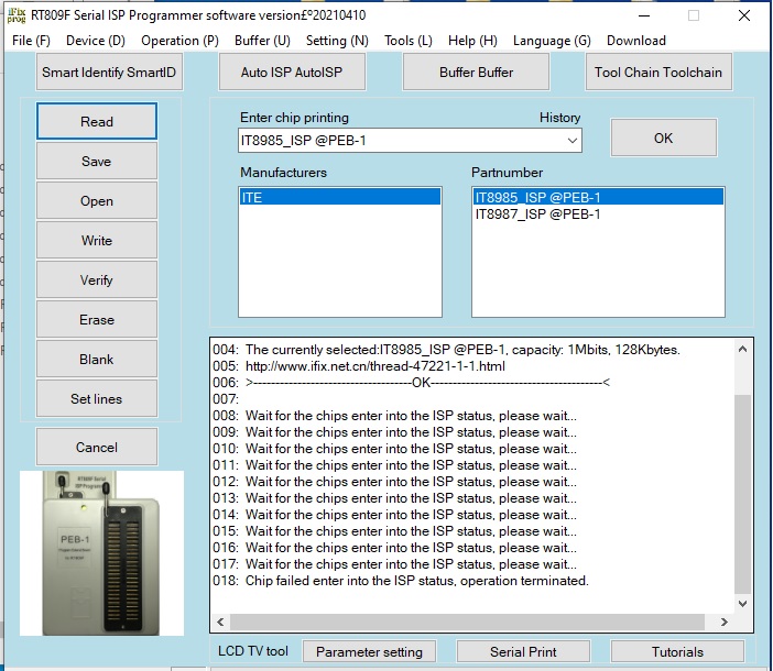

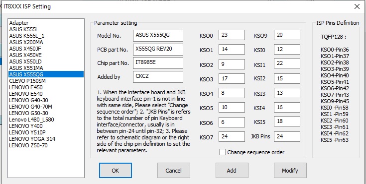

                                thanks peste for the ec file. But i still have a problem, i failed to flash it to my ITE 8985E (shown in picture "RT809_IT8985_fail"), that a new EC IT8985E that I'm using, the tool that used is RT809F + PEB1 (shown in pict "RT809F+PEB1").
                                I think my pin keyboard conection setting is good, already check. But still, its say chip failed to enter isp status. Need help here..

                                  I don't know how to help you here, I didn't use this programmer ... I'm sorry..but maybe someone else will help you ..

                                    Thanks peste, i wonder what programmer tools do i need to program that ec bios?
                                      https://ioprogrammer.com/

                                        Hello guys
                                        I how question about IT8985
                                        How can I program this IC?
                                        By Which programmer can i do ?
                                        I have RT809H programmer

                                          #60
                                          Hello guys
                                          I have this problem too and I think its becuase of adapter because this adapter is for IT85xxx family not for IT89xxx family
