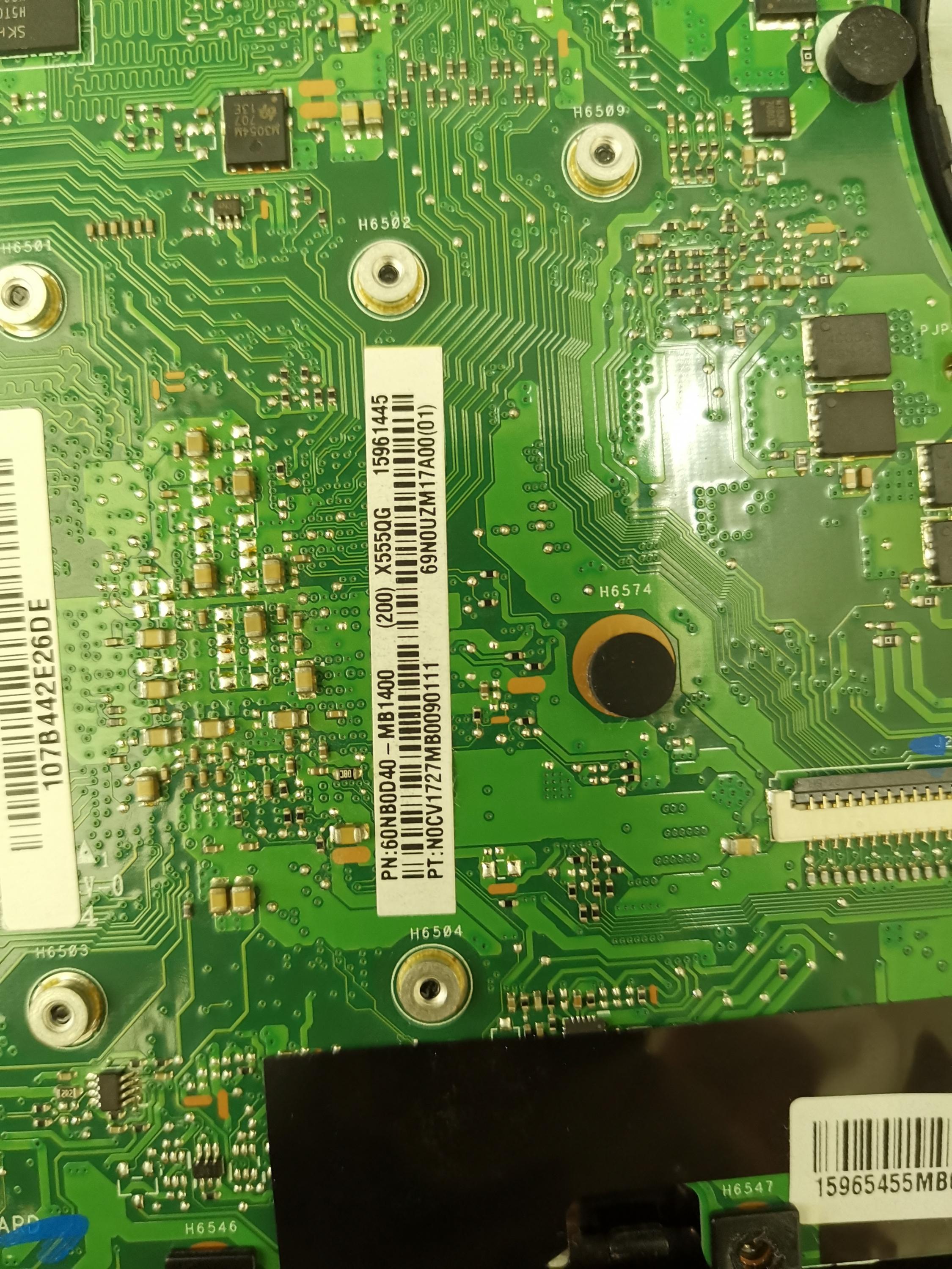

        Re: Dump ASUS X555QG Please!!
        hello i think to have the same problem with serial number since i have tried diffent bios and all no video, i attached my original broken bios if it is possible to put serial number in a new working one. Thanks
          try..
            thank you so much i have tried but i have the same situation power on also hdd woking but no video only some change of brightness for two times when power on and then nothing also on vga out. The stange thing is that if i write the file into new chips 25w64 i have no power and no led on even if i have tried different new chips. Only with the original chip go on but without display. Can you help me to solve?
              the bios is extracted from the update on the Asus site, to which the DMI information was added from the bios posted by you ... either you do something wrong when you write the bios, or you have another problem on the board ... post pictures with the stickers on the motherboard.
              • amon76
                • Aug 2013
                • 27
                • italy
                Here picture

                      • 22127
                      #30
                      Do you mean the bios chip is W25Q64FW ,its a 1.8V chip, are you using a 1.8V adapter, and what programmer are you using .

                          #32
                          thanks for you answare i have understood that the problem with my new chips is that they are 25q64fv and not fw so not at 1,8v, for this reason with new spiflash pc stay off. Now i'm using a EZP2010 programmer but yesterday come my new RT809, i have to use it to program this 1,8v spiflash? Thanks

                              #34
                              i have tried the bios from post #31 but i have always no video only some flashes on display, but i have to use the new rt809 programmer for this kind of spiflash? sorry but i don't understand

                                  #36
                                  I've tried also with rt809h and so 1,8v programming but i have the same problem so i think an hardware issue but i have to rent the notebook unfortunately so i cannot try furhter. Thanks to all for support
