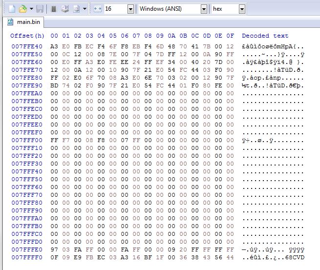

i need bios of hp elite book 8540p
  • aliiash
    • Jun 2019
    • 99
    • england
    I want bios file for hp elite book 8540p Holds the same number
    https://www.badcaps.net/forum/attach...1&d=1560210819

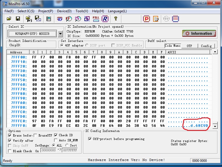

      Re: i need bios of hp elite book 8540p
      Originally posted by marcin02152
      I tried this file but not work .
      I need to another file please
        • 22275
        Your MiniPro software version is old. Why select OTP ?

            • 22275
            It means One Time Programmable,you can only write to it once with an OTP chip. Select W25Q64FV @SOIC8 .The Ala_Borbe bios by marcin02152 at post #2 is good.
            In your 1st post you said "Holds the same number" ,the MiniPro ASCII code window doesn`t display the full ASCII characters,the code looks different with a hex editor.
              Now I understand what you mean. I have selected the SOIC8 chip and programmed it again but no data appears on the screen. I need a tried file for this model please.
