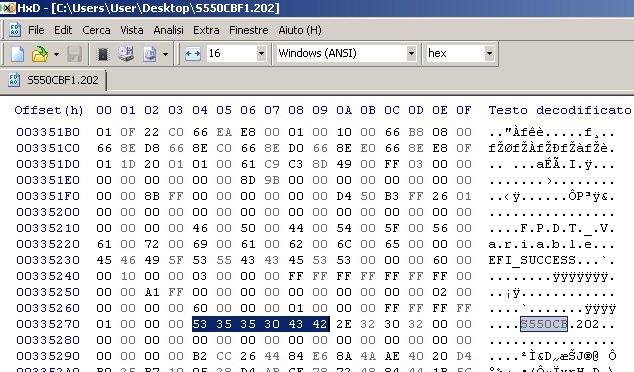

      • Bartoloni
        • Jul 2018
        • 140
        • Italy
        Re: Asus vivobook s550cb bios dump
        usually when same board is used for different models (in this case S550CM S550CB and K56CM ) you have just to modify a bios from a different model "confusing" easyflash and make easyflash can upgrade to "latest/original" from website...
        for example...
        i have an ASUS S550CM (double VGA card) ... when using the K56CM bios (that is 205 revision i have a 30min shutdown due to intel management engine)
        when i use the S550CBf1202 provided by evserv in this post i have no shutdown.. but the secondary VGA card is flagged as wrong-drivers/not-working-correctly
        in my case i need to use the S550CM original bios (ver 202 also) but there are no dumps...
        what i do is edit a "compatible" dump (in this case S550CBF1202.zip ) using hex editor.. replacing all strings (there are 5 or 6) like S550CB with S550CM ... and all versions from 202 to 201 (this is necessary to upgrade at 100%)
        after that FLASH the newly created modified dump to eeprom using a programmer...
        when starting PC on main screen of bios is still appearing S550CB (not changed) but on easy flash .. the mainboard bios will be recognized as S550CM v. 201
        from this point you can easly switch from the modded S550CB 202 to the original S550CM 202 (downloaded from ASUS web site) just asking for an update from usb-drive. (in my case after this the secondary VGA card will be recognized without issues)
