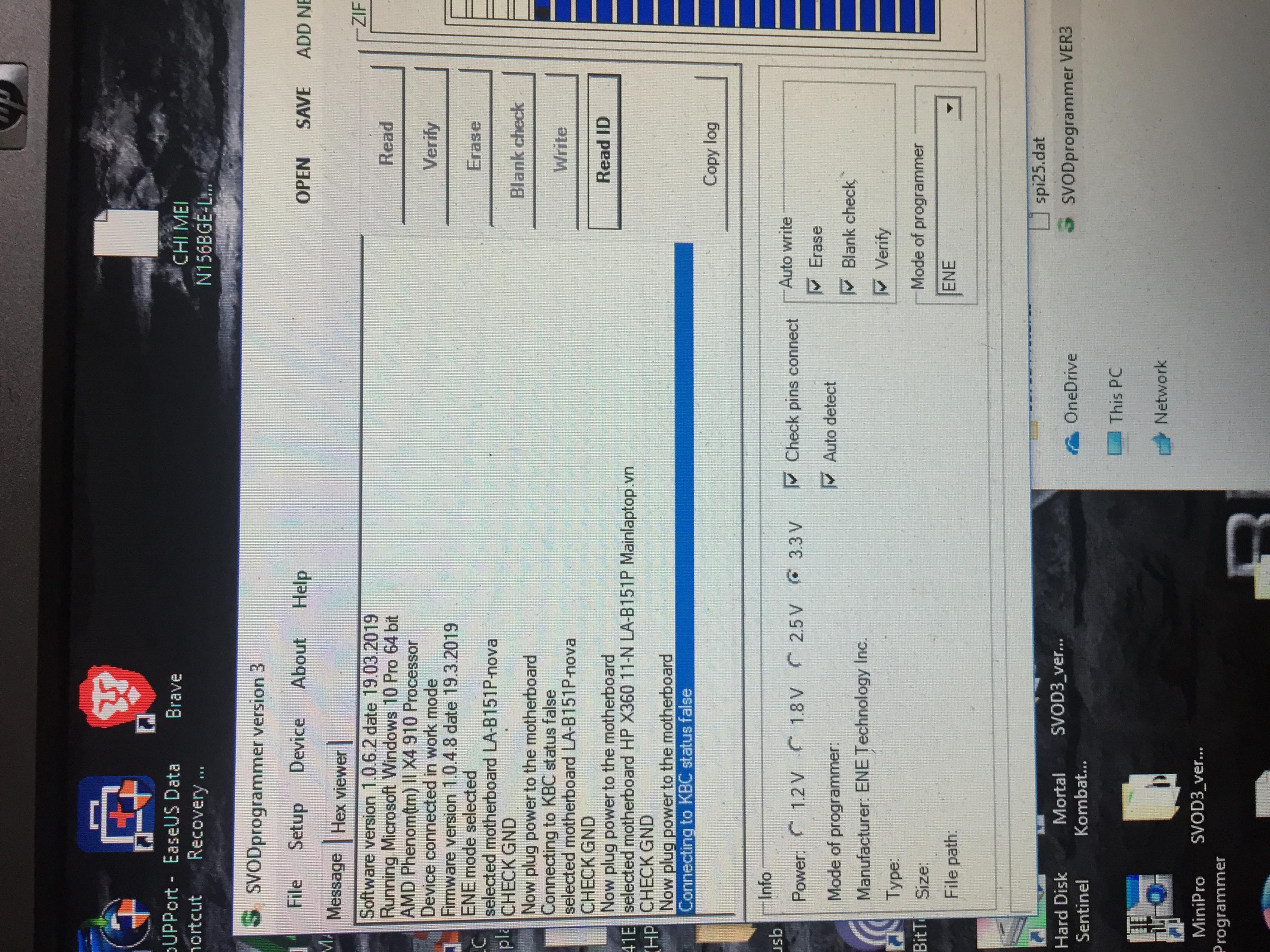

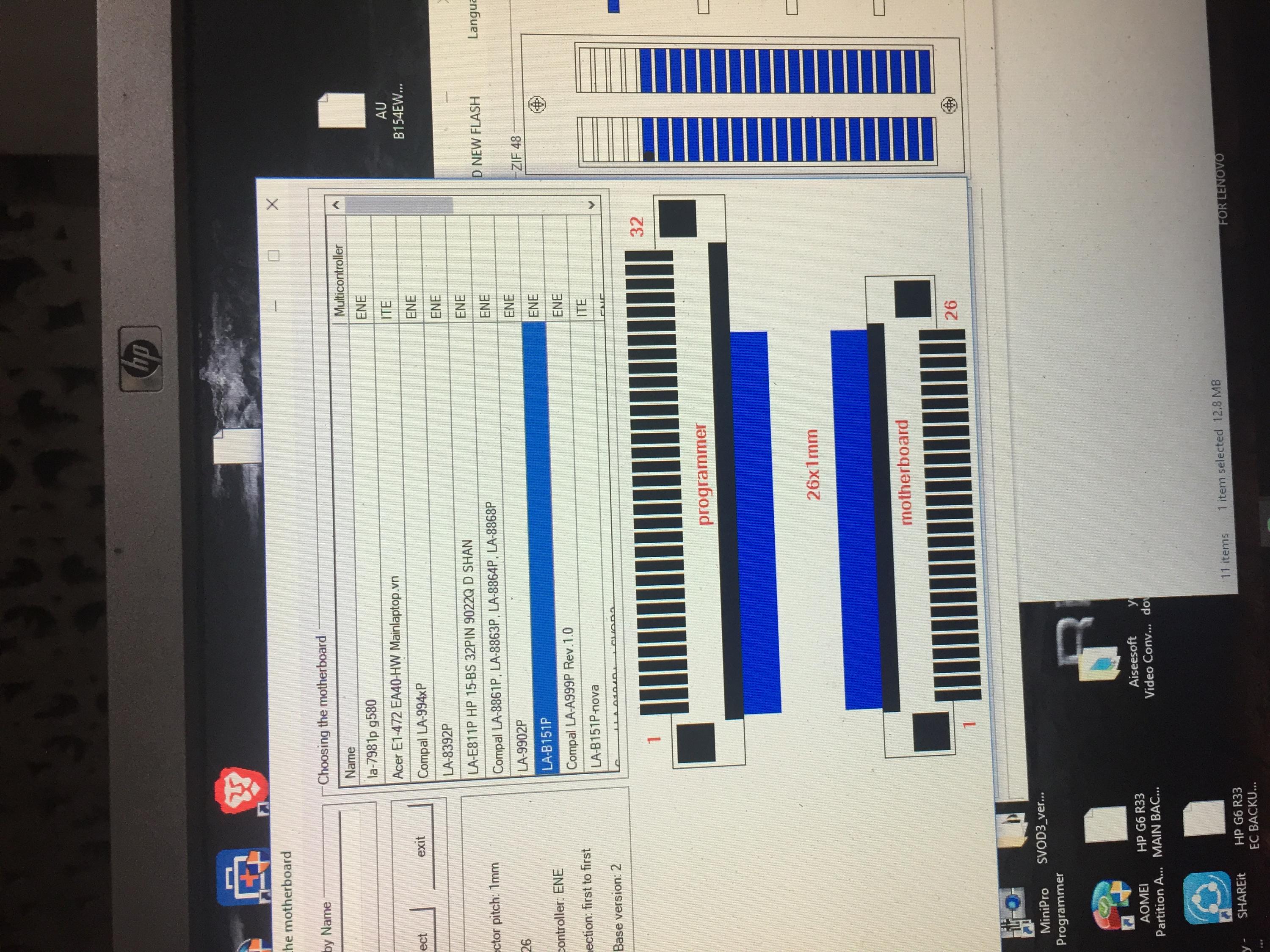

                  Thanks, but i have a problem programming on KB9012QF A4, i am new to svod the keyboard connector is 28pin so i plugged in to adapter and svod going to keyboard connector 28pin, but when i download on online database the board LA-B151P ENE is 26pin pinouts when i slelect check id is shows KBC FALSE. Anyone can help me
                    Check your settings again, update the software .

                      I already updated the software I am using SVOD3. when i got to setup and download motherboard 26pinout only available on the database

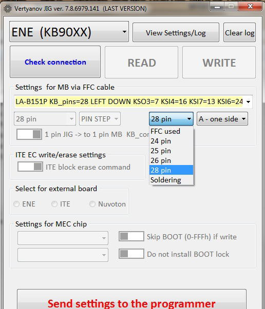

                          uses the 26-pin ribbon in this mode

                            @peste but in the keyboard connector in the motherboard is 28pin.is it ok i will use 26pin to connect?

                                Did you checked continuity between mb and svod3 cable-all pins?? Try similar HP mb config file with 28pin. Sometimes it works.

                                  yes i checked continuity good i have found same la-b151p with 28pinouts but its for ITE chip

                                        yes pin 25 has +3VS the problem is i cannot find 28 pinouts on the database for ENE that is why is shows when reading id kbc false
