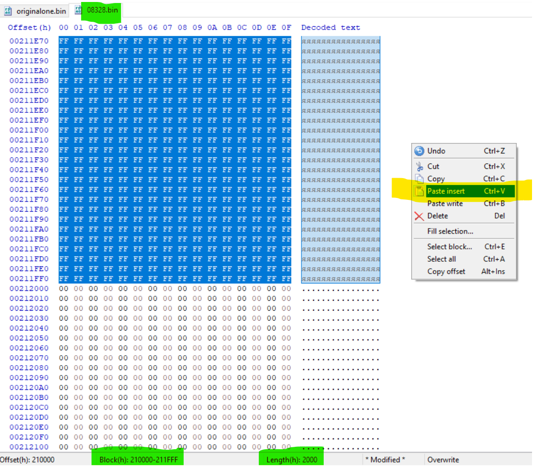

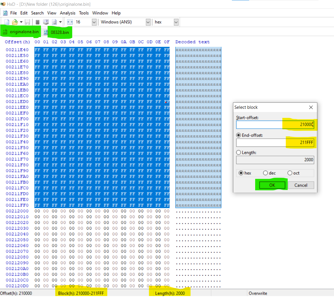

                • Vesko356
                  VIP Moderator
                  • Aug 2018
                  • 4386
                  • Bulgaria πŸ‡§πŸ‡¬
                  #92
                  Originally posted by kubernet
                  Well i find the good bios to use,
                  may you explain me now how to add my DMI on this bios ?
                  thanks
                  Download HxD hex editor, open your original bios backup and 08328.bin with the program, select "originalone.bin" tab, use Ctrl+E to "Select block", fill 210000 as "Start-offset" and 211FFF as "End-offset", click OK, use Ctrl+C to "Copy" selected, then do the same with 08328.bin but instead of "Copy" use Ctrl+V to "Paste insert", click save. Done. Your DMI area and Windows key is transferred from your original dump to the virgin 08328.bin bios.
                  Flash the 08328.bin bios to the chip, and you're good to go.

                    • Suisse
                    #94
                    . Click image for larger version
Name:	Screenshot 2024-01-31 150639.png
ID:	3208035 Click image for larger version
Name:	Screenshot 2024-01-31 152458.png
                    thanks for all, thanks for this tuto
                    my bios is ready i will test it and let you know
                    about "fill 210000 as "Start-offset" and 211FFF as "End-offset"
                    This is for all hp bios the same ?
