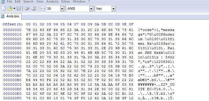

NEED P50T-A-114 PSPMDE bios dump
  • bilen
    • Aug 2014
    • 637
    • istanbul
    mainboard code : vgsg rev2.1 please help me...

        Re: NEED P50T-A-114 PSPMDE bios dump
        Post your bios backup .
          http://dosya.co/9ggpn32ebtwa/4mb.bin.html

                • 22279
                Your backup is corrupt, i`ve seen similar corruption from another turkish members bios backups. The code thats been added at the beginning 0-7F has chopped off the code from the end of the backup. Make another backup,check it with a hex editor , the 4MB backup should start with 02 00 70 02 05 5A 22 02 5C 79 22 HEX. Also there are 2 bios chips you need to backup, 4MB and 2MB .Post your backups here in a zip or rar ,not on dosya !
