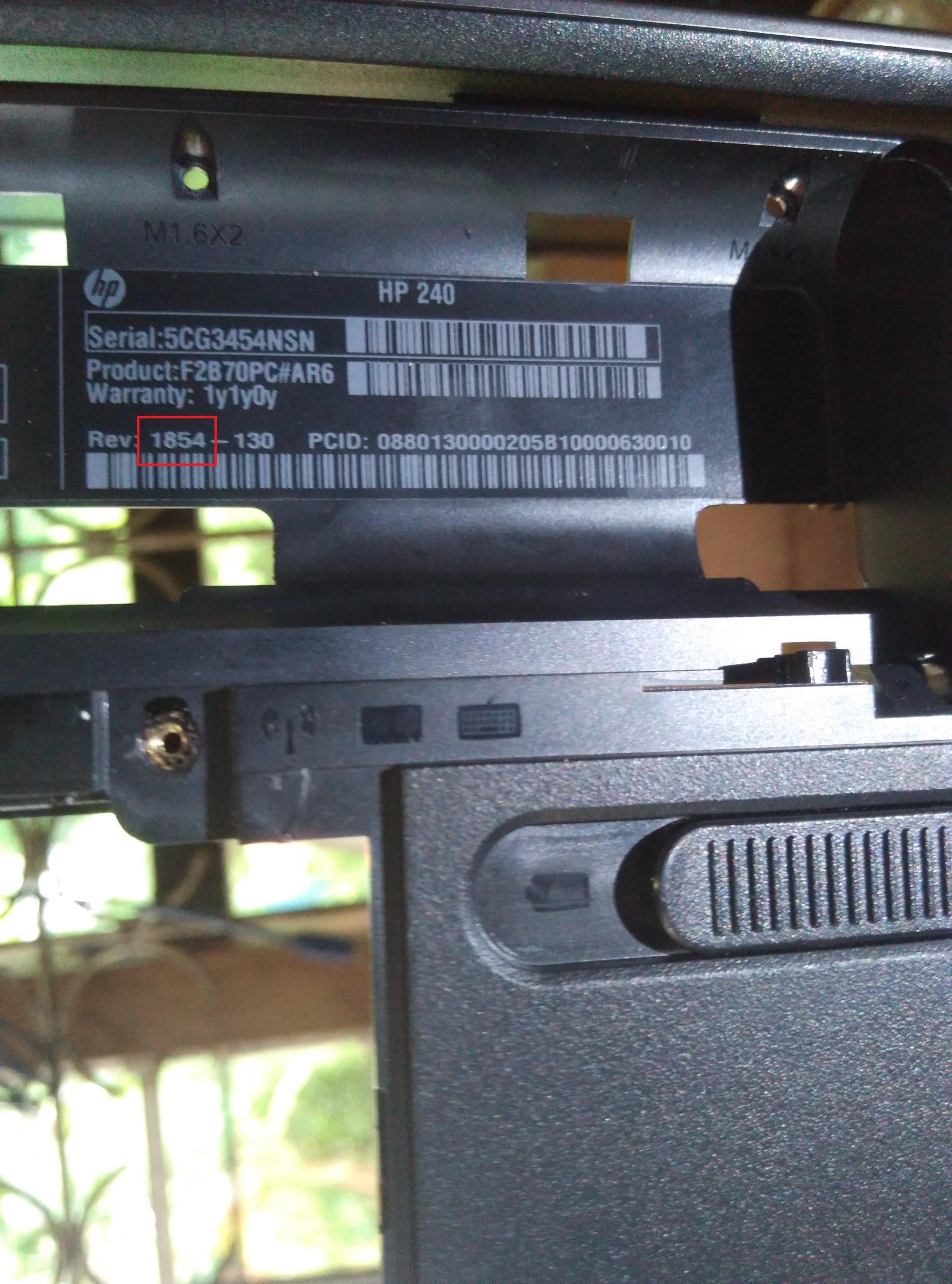

                    Maybe not match with original board. since your original broken (BTW, what code your bios IC? my ezp2010 failed when detect IC if MX IC 8mb 1.8V, maybe you face same issue, cannot read if it MX IC aka macronic)
                    Find out your code in bottom case near S/N and product code
                    REV: xxxx (xxxx it your code, then choose that match code by SMDFlea' file upload it)
                    in example see pic attahement: hp 240
                    Rev: 1854, mean the bios that match is 08154
                    also if want to try as last attempt, use my backup dump for hp14-bs005tx

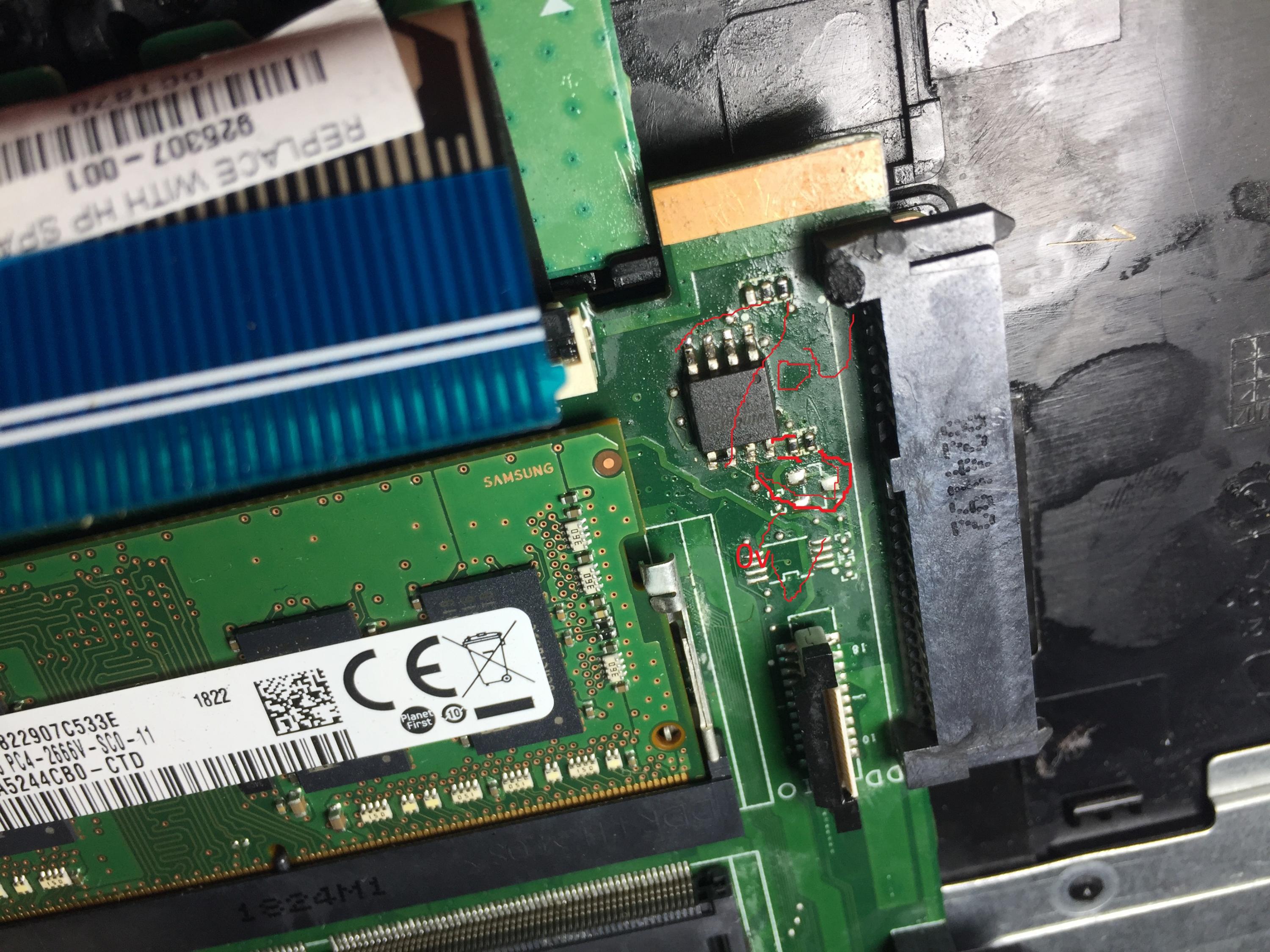

                              Re: HP 14-BS507TX bios needed
                              thanks i have attached a image where 4 resistor connected to bios chip pins and show 0v
                                • 22167
                                #35
                                Trace pin 8 +3VSPI on the boardview,there are 2 caps and 2 resistors on the other side of the board,test all those.R101 goes to +3V_DEEP_SUS .Check U4,+3VS5,PU10. Good luck with it .
