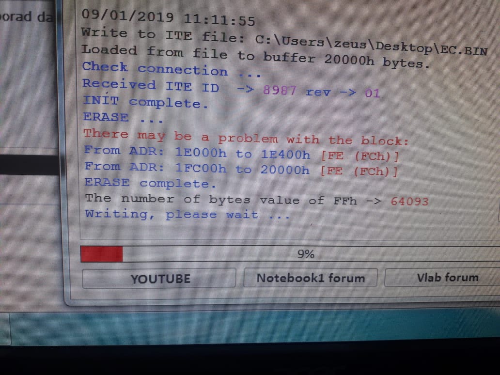

    hello.i need ec bios for new io DA0ZETMB6D0
    IT8987E

      is that work on this borad da0zrtmb6d0 rev d
        • 20633
        Re: need bios ec
        Yes .

          sir can u please explaine wht i get erreur the i/o is brend new one
            • 20633
            Re: need bios ec
            When flashing some acer EC`s you have to power first up after flashing then program the EC again for a second time with serial etc,i`m not sure if thats the case with this one . You havn`t posted your error image .

              i cant power up because i use keyboard connecteur for Vertyanov JIG and the power boutton is in the keyboard and how i uplod image on this web ..thx sir..

                Re: need bios ec
                https://drive.google.com/open?id=1s3...bC821wmeEWU9l7
                  • 20633
                  Re: need bios ec
                  Under the message box where you type these messages click on the "Go Advanced" button ,then click on "Manage Attatchments" ,browse for the file you want to upload then click on "Upload" .

                      Re: need bios ec
                      you see now
                        • 20633
                        Re: need bios ec
                        I havn`t run into that problem before, maybe other members have. I cn only suggest that you check your soldering and connections.Maybe its a bad ITE .
