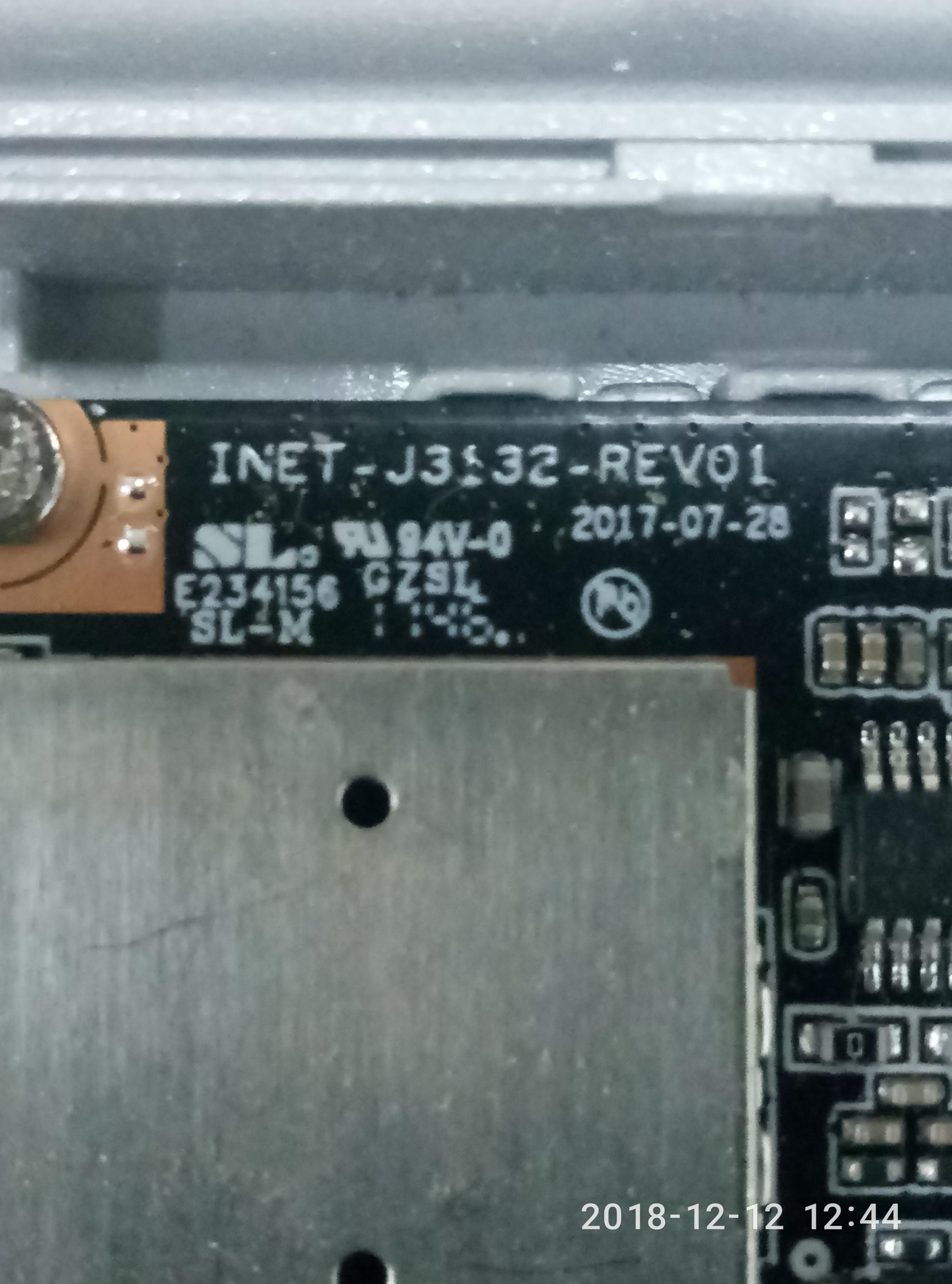

    need bios for kiano slimnote 15.6 with hdd and intel atom cpu and ram4gb
    the motherboard model
  • RJARRRPCGP
    • Jul 2004
    • 6304
    Re: kiano slimnote15.6
    Two different years of manufacture? LOL
    (I see what looks like week 46 of 2011, while I clearly see 2017 on the upper right!)
