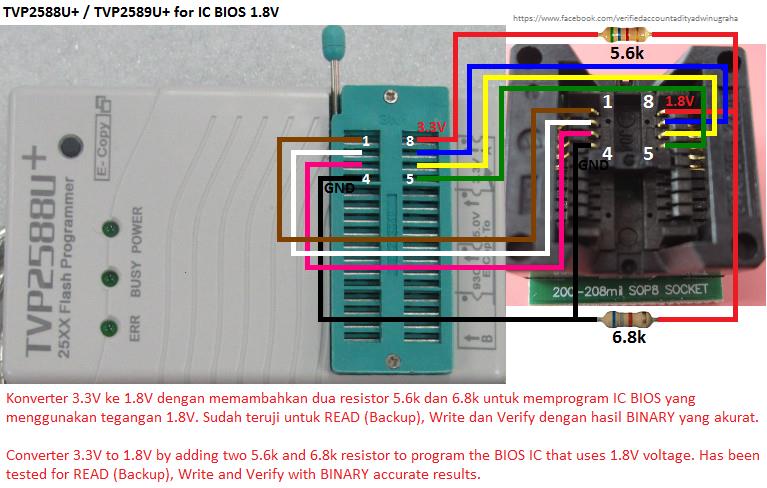

    Hi
    My Lenovo G40-30 notebook will not start. When I press the power button the power LED is lit for a few seconds then it turns off. There is no display. So I was thinking that I will start with flashing the BIOS. Problem is the BIOS chip is a 1.8v chip. My programmer is a CH341 Black Edition. I do not have a 1.8v adaptrr for this programmer. Is there anyway I can flash this chip without buying any extra adapters etc? The chip is a GD 25LQ64CVIG. I am also good with electronic stuff so if there is a diy solution I will also be most welcome to it. Let me know. Thanks

    u can make your own regulator and other stuff to reflash 1.8V bios. or u can buy adaptor for few euros

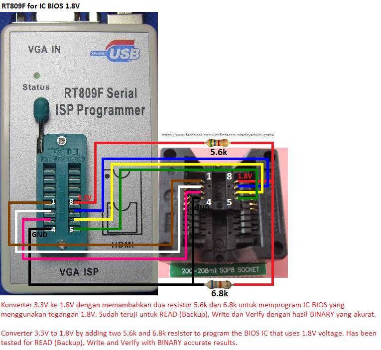

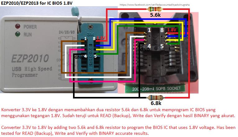

      Re: BIOS Flash - CH341
      Try it...
      original link:
      http://www.teknisi-indonesia.com/thr...os-1-8v.11535/
      Credit : Aditya Dwi Nugraha
        Originally posted by on/off
        Try it...
        original link:
        Awesome. Exactly what I was looking for. Many thanks @ on/off
