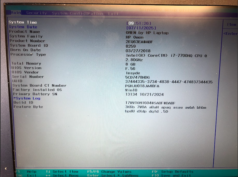

    Hey guys!
    Did a PCH replacement on a HP Omen 15-ax245nf and it worked, just slow post but hat was expectable.
    I installed windows and updated drivers to ensure all was good, and a Bios update at the restart.
    After that no more POST.
    Ive flashed one of these clean version for this model but I got the same message as the previous user Manufacture Programming mode is in unlock mode, and no DMI info on it of course and also lost OMEN logo and got regular HP one, but that is not a problem.
    Ive tried to copy the blocks as described on post #17 but did not worked, laptop started as doing a bios update, and some stuff was missing.
    Can someone more experienced help me rebuild a clean bios for this board?
    Model : HP OMEN 15-ax245nf
    ProdID:2EQ63EA#ABF
    SN:5CD7478HDG
    RMN:TPN-Q173
    BoardAG35DMBAD0 REV: D
    I leave here also the original backup bios (laptop was not posting when I read the chip)
    Thanks a lot!

        Originally posted by SMDFlea
        Virgin bios + DMI
        Thank you Mr SMDFlea
        Works.Got even the Omen logo back
        But I still get the Manufacture Programming mode is in unlock mode
        How can I disable this warning or put the bios back to "lock" mode?
        Appreciate any hints

          It will lock itself after many reboots. You can try to use HP bios config utility to lock it as well.
