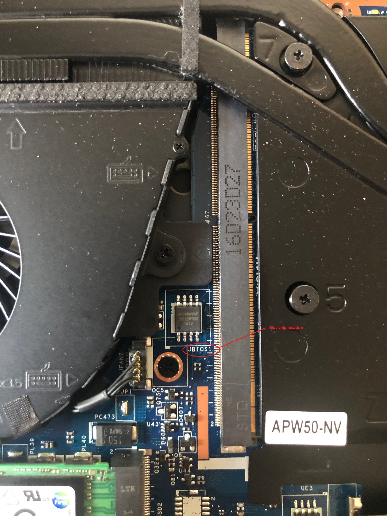

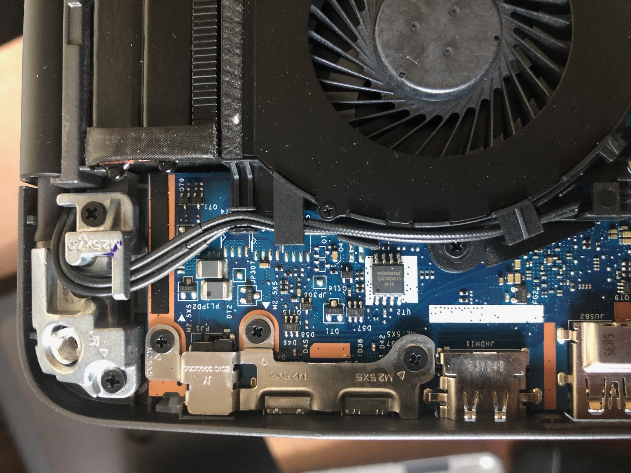

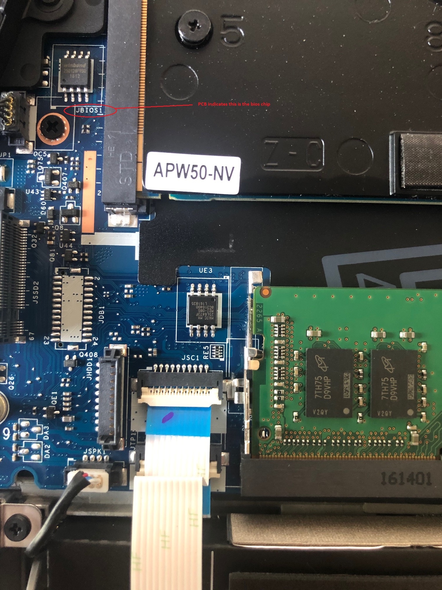

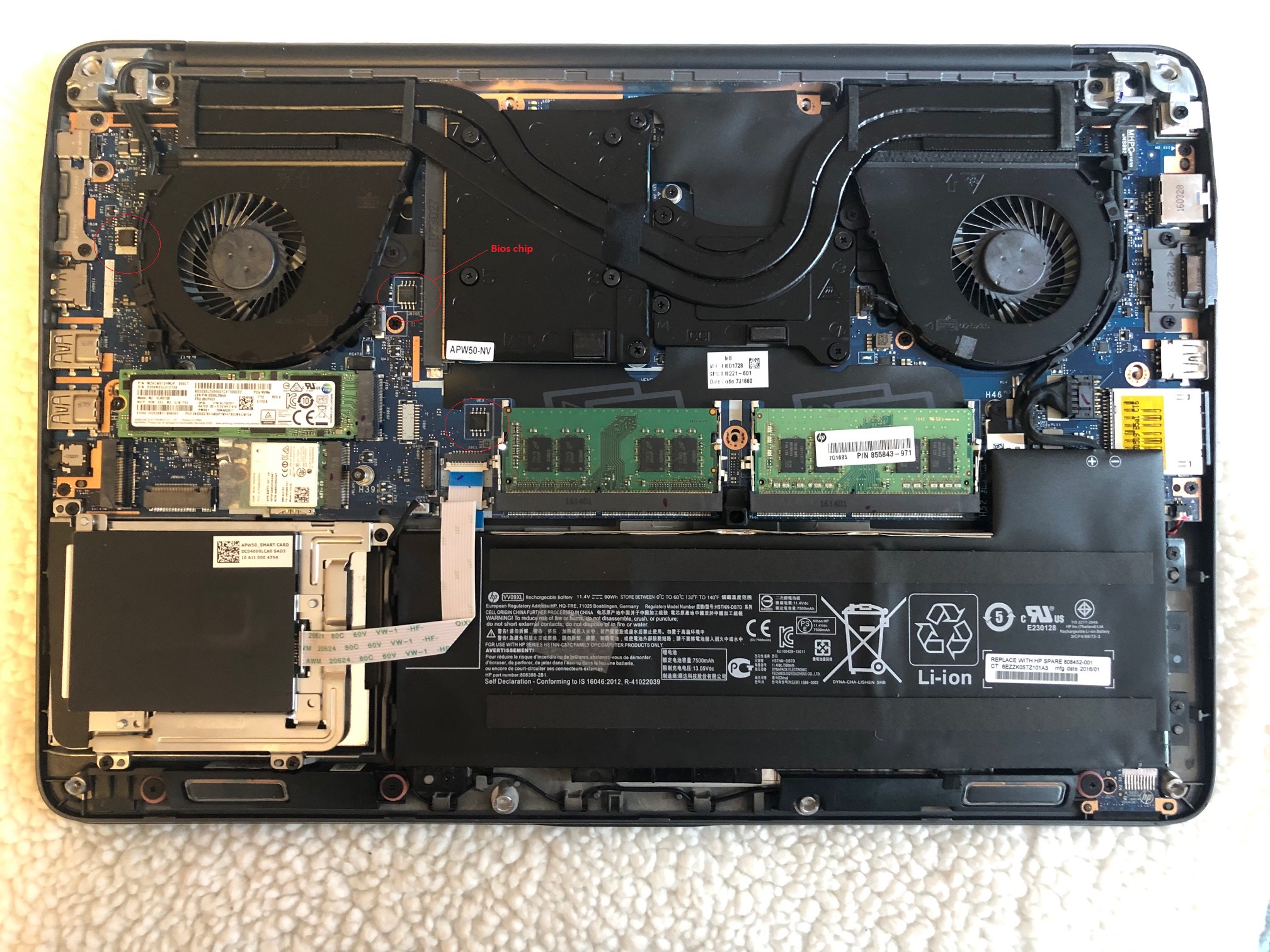

      Bios unlock for a Zbook 15 G3 studio
      I wanted to start this thread since I received a laptop from a seller that decided it was ok to sell locked computers to folks while conveniently forgetting to disclose this prior to the sale. When asked to resolve it I was told it's no big deal, just go on Youtube and they show you how to do it. Still pissed about that response (I'll deal with him later) but I believe when life gives you lemons, it's time to make lemonade.
      So right now I have this Zbook 15 G3 and really the only problem with it currently is the bios is admin locked such that I can't use the HP Assistant to update the bios to the most current version (it's still stuck at 1.09 which is probably original when sold versus the current version available from HP which I believe is 1.41). So everything else works and the laptop fully boots into windows and otherwise operates normally to start. The key here is I don't want to junk this motherboard at all if I can help it.
      I believe I have located the bios chip on the motherboard (there are 3 chips that look similar, see attached). I took a shot of the whole board and then zoomed in on each one just so others can see what I mean. The bios chip appears to be a Winbond 25Q128FVSQ and if you look it even indicates the Bios chip location right on the PCB so that part wasn't too hard. Not sure if all HP boards do this but this one seems to be clearly indicated.
      Next I bought a CH134A setup like this which comes with a test clip:
      I was hoping to be able to read the chip without unsoldering it but that's where I stopped since I wanted to check with those that have more experience than I. I had read that some of these programmers use incorrect voltage (5V vs 3.3V) and I didn't want to damage my perfectly good chip.
      Few questions.....
      1) Are these programmers safe to use? (ie won't damage the bios chip)
      2) Should I be checking any voltages before trying to read the chip using the test clip?
      3) Can you safely do this with a test clip (ie get a good Bios dump to verify) or does it have to be unsoldered to ensure success?
      4) What is the preferred program to use when reading the chip? (CH134A came with no directions, drivers or software at all)
      I assume I will need to unhook the battery and plug in the charger to do this as suggested in several other threads in order to do this process.
      Any tips/help on this would be most appreciated.

        Re: Bios unlock for a Zbook 15 G3 studio
        Looking to get started on this so just bumping the thread for some help on my questions above.
