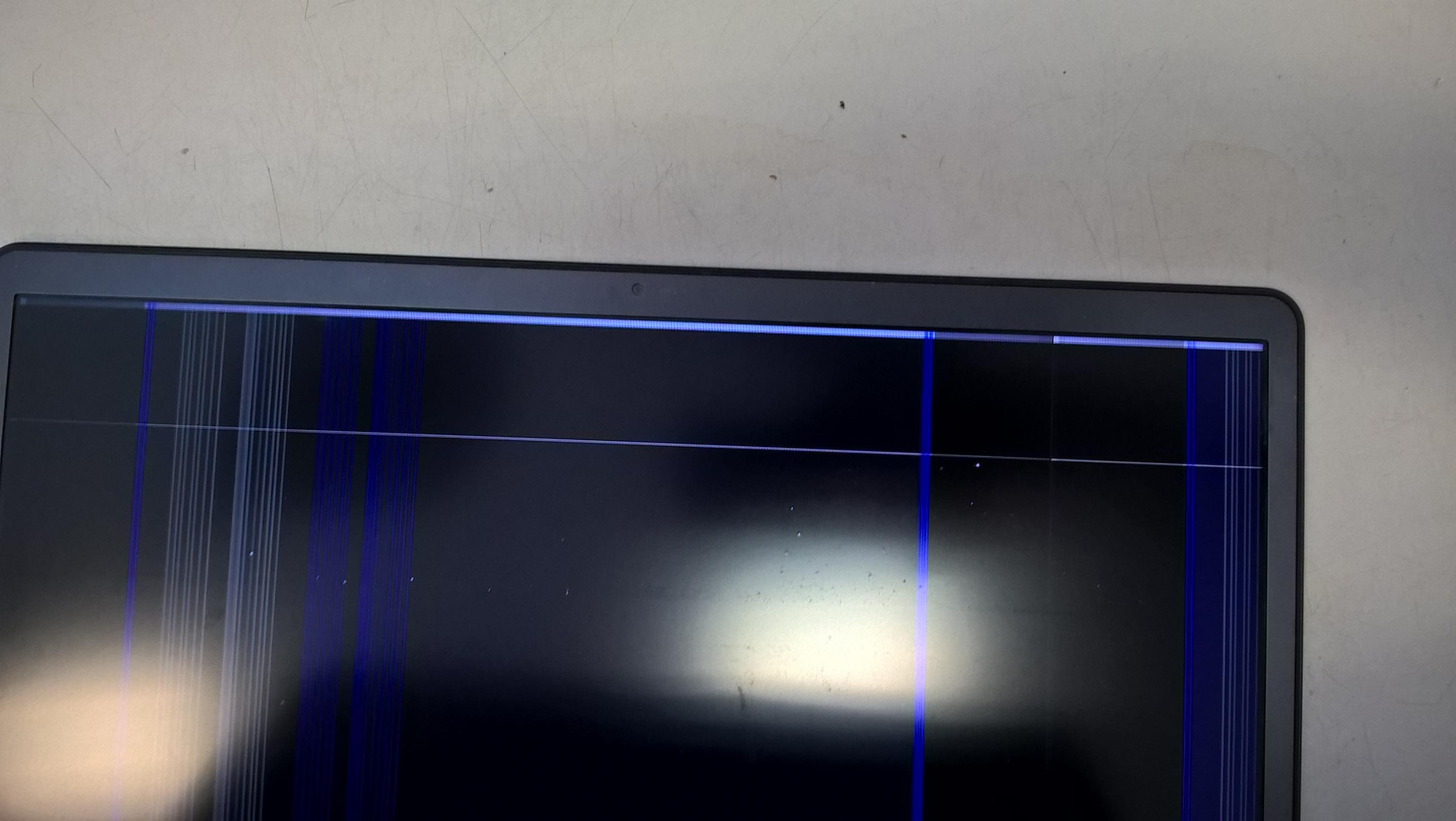

        I flashed Bios for NP900X3C code has many differences but it give me some kinda picture on screen and i can use arrows to navigate and those lines/colors change on the screen. I will attach picture.
        I can even see jump in power from 0.600 ish Amps to almost 1 Amp when those lines/colors appear.

          The bios i posted was your bios,with a clean ME area .Try with an external monitor. It looks like a bad screen or gpu issue .

                  Bad screen or gpu,first.

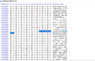

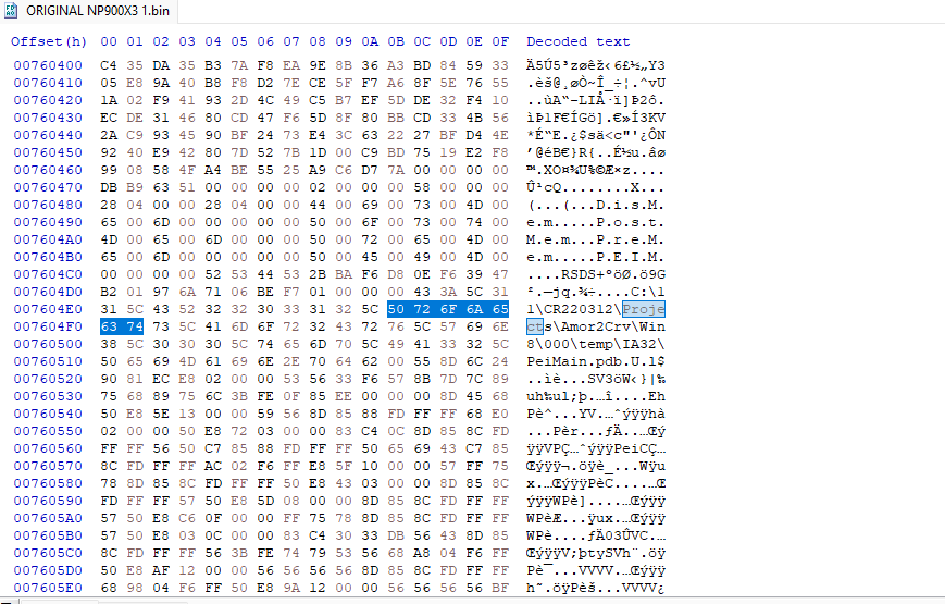

                      read your original bios to see what model it is. then check rma factory bios from samsung Click image for larger version
