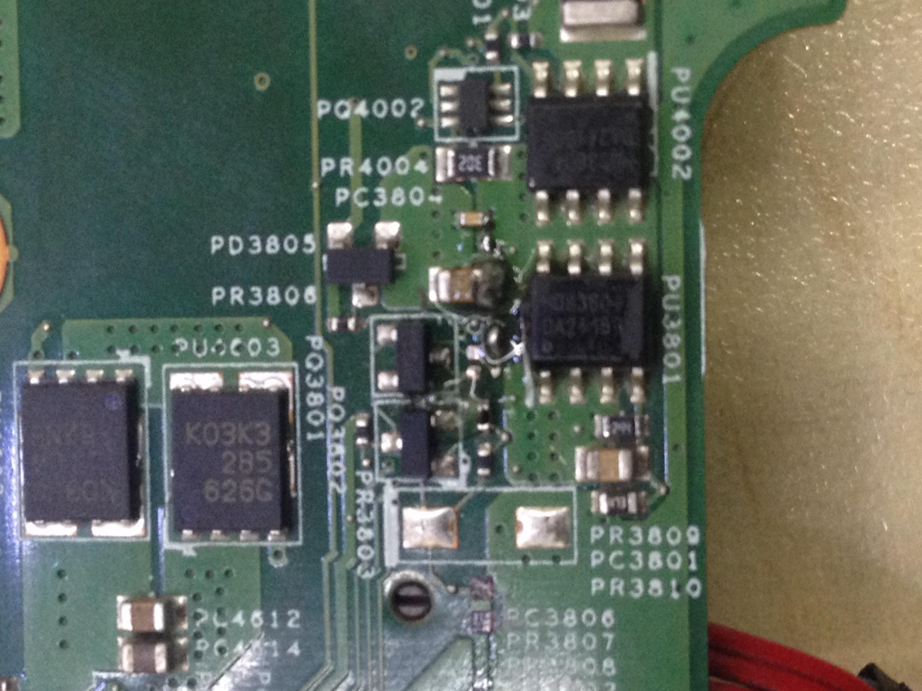

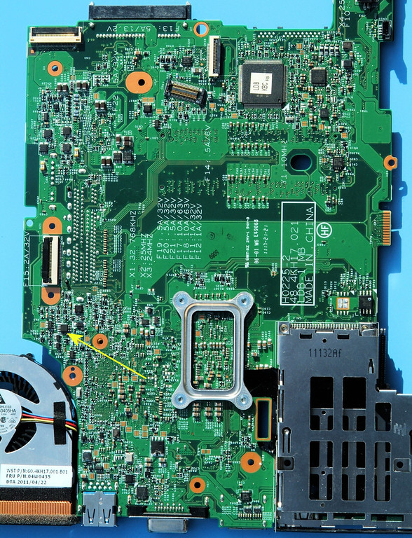

                No i means read L08 security chip like this if board same.

                  Re: Lenovo x220 tablet dump
                  Sorry 1st pics not this mistake here is 2nd.

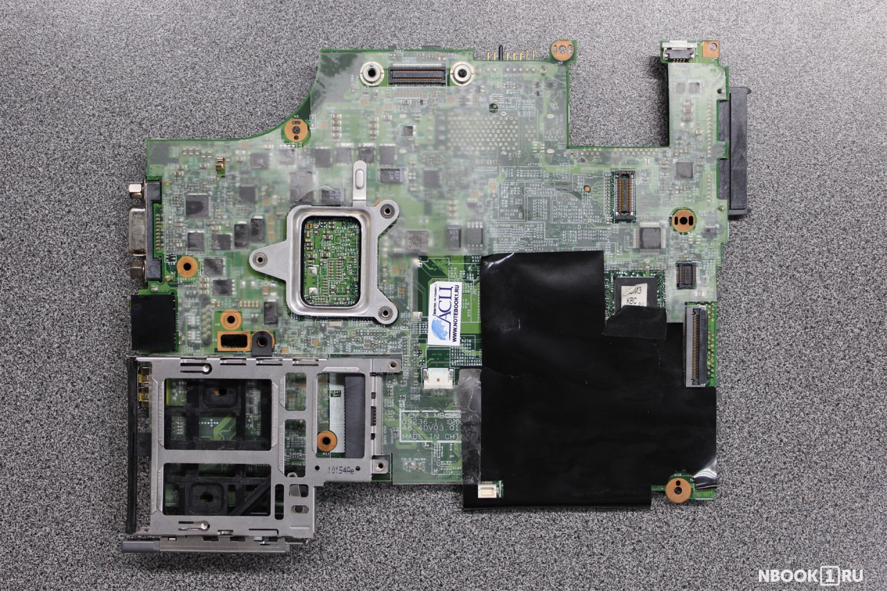

                    not the same board pls

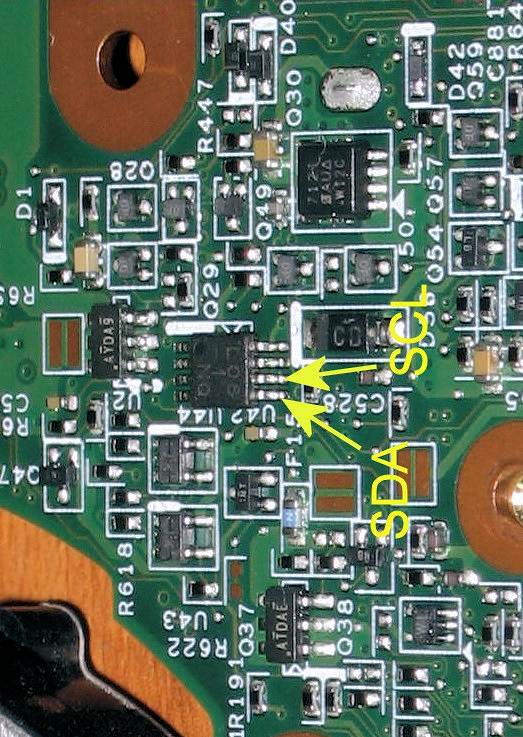

                        • 20477
                        Look at all 8 pin chips,like the pic above U42 ,it should be marked on the board starting with U .Look for L08 on top of chip
                          Look at all 8 pin chips,like the pic above U42 ,it should be marked on the board starting with U .Look for L08 on top of chp
                          chp: 25l6444se
                            • 20477
                            No thats not it. It could be any of these 93C46, C4C61, 24C01, 24C03, 24RF08, 24RF08 equivalent P24S08, PS08, L08, 08 as well as LSI EEPROM PC8394T and 8356908
