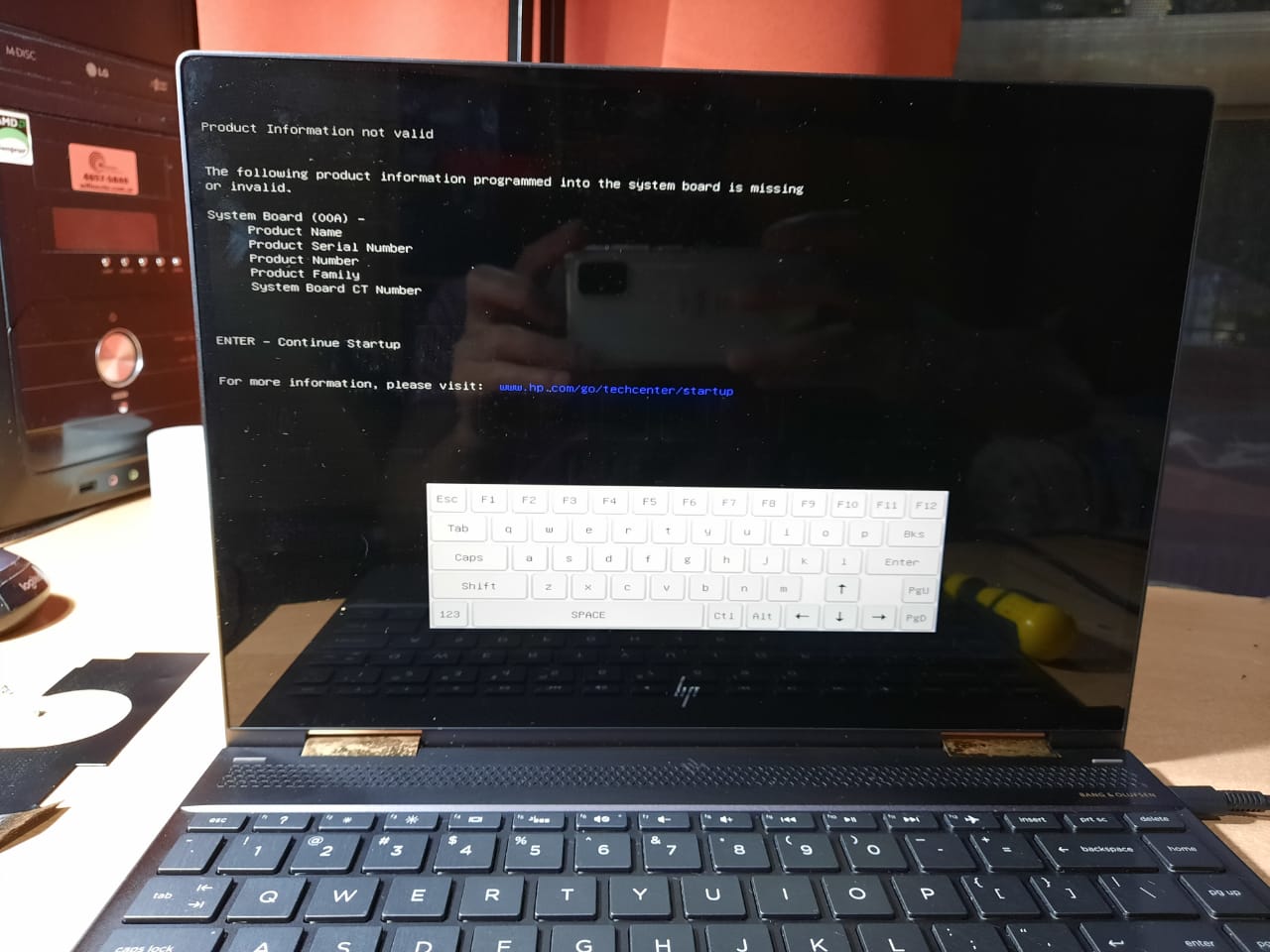

                            i download official driver and laptop its on,, but dont start up...says
                            anyone know how to do that?
                            i copy the original dump bios and the one that work for me in case anybody need it
