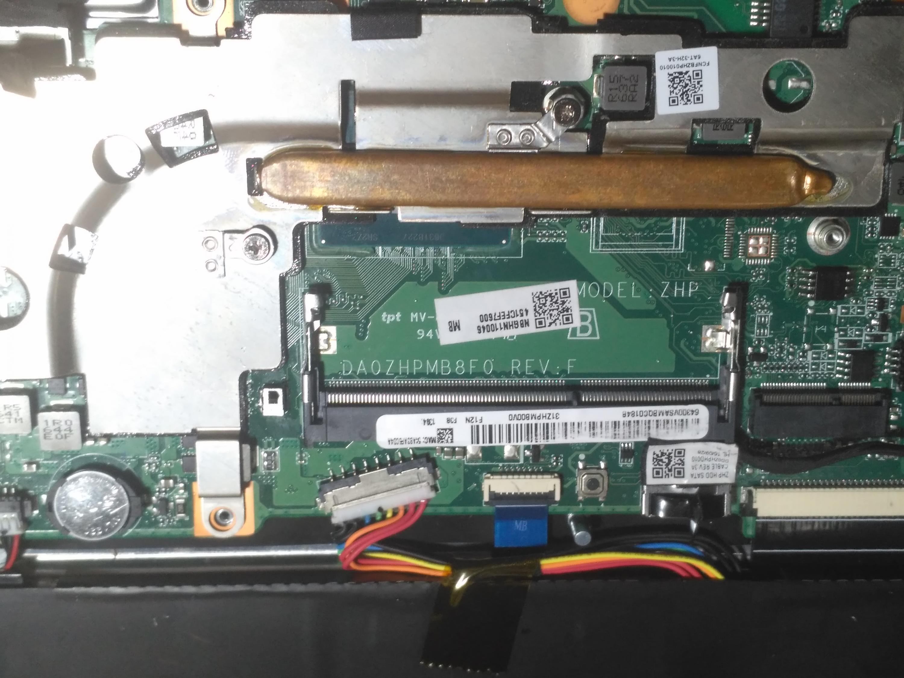

    i need bios dump for Aspire E11 (ES1-132 DA0ZHPMB8F0 Rev.F)
    Laptop is now dead after wrong update.
    I have another mainboard, but bios is locked by pw

        hmmm not works...display still black
        Flashed with ch341 with 1.8v adapter. Bios chip is 25LB64CSIG and flashed as 25Q64BV

          25q64bv is 3.3v chip-so will not work

            Oh ok...i mean that 3.3 and 1.8 are same...only votage is different...so i use 1.8v adapter.
            Do you know which compatible chip select in ch341a programmer software?

              use WINBOND W25Q64FW

                hmmm...still nothing ...display still black
                Flashed as W25Q64FW, verified twice.
                Maybe is bios for different cpu?
                Inside my ES1-132-C92R is celeron n3350

                  Try this bios .

                    ...last one works...THANKSSSSS
