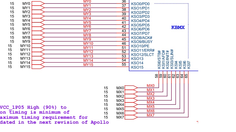

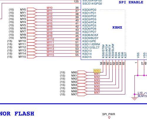

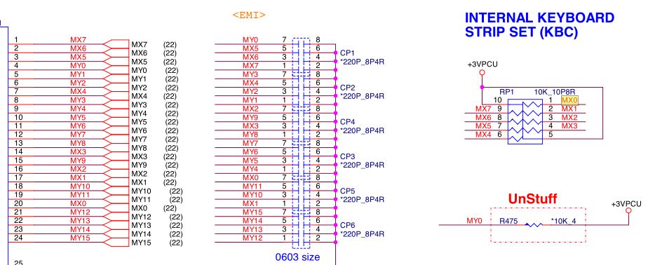

          Re: Aspire ES1-132, DA0ZHPMB8F0 / F - Bios Needed
          now is oke, but keybord not work
          i am cek from pin soket keybord and it8987e, something voltage mX0=0,034v is drop and mY16,mY17 =1,2volt
          is problems on the it8987 or from others ????
            • 20659
            I don`t have the es1-132 schematic.On the es1-131 schematic MX0,1,2,3 are pulled low # through a 10K resistor. I think your keyboard needs replacing.
                Originally posted by alaviyatayeb
                ok , i try replace keyboard again,...
                after i change it8987e,is keyboard working
                thank's all
