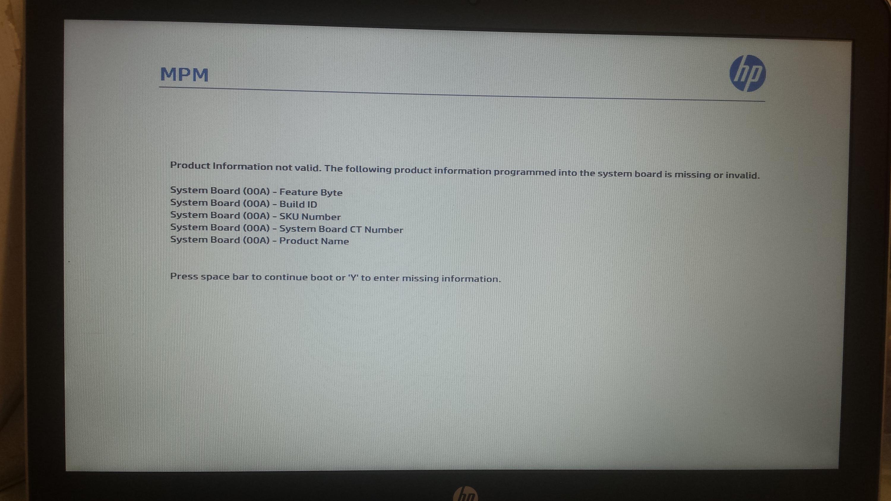

                                      #58
                                      Re: HP DMI Tool NBDmiFit
                                      im having issues with hp 450 g4 mpm (see pic)
                                      ive tried a few dmifit programs but cant find the one that works on this model
                                      does anyone have the version for 450 g4 ?
                                      thanks

                                        #59
                                        thanks
                                        Q:How to come this error?If program new bios file then come use original update bios he recover auto your dmi info.
                                        Or you want any dmi then send me bios file if you read i try add all info

                                          #60
                                          this machine originally had bios password, I reflashed a new bios and everything was ok but after a few months I get this error ?
                                          I will install windows and try the hp bios update
                                          thanks, I will let you know how things go. Thanks for your offer to fix the bios dump (I might need it)
                                          back soon
