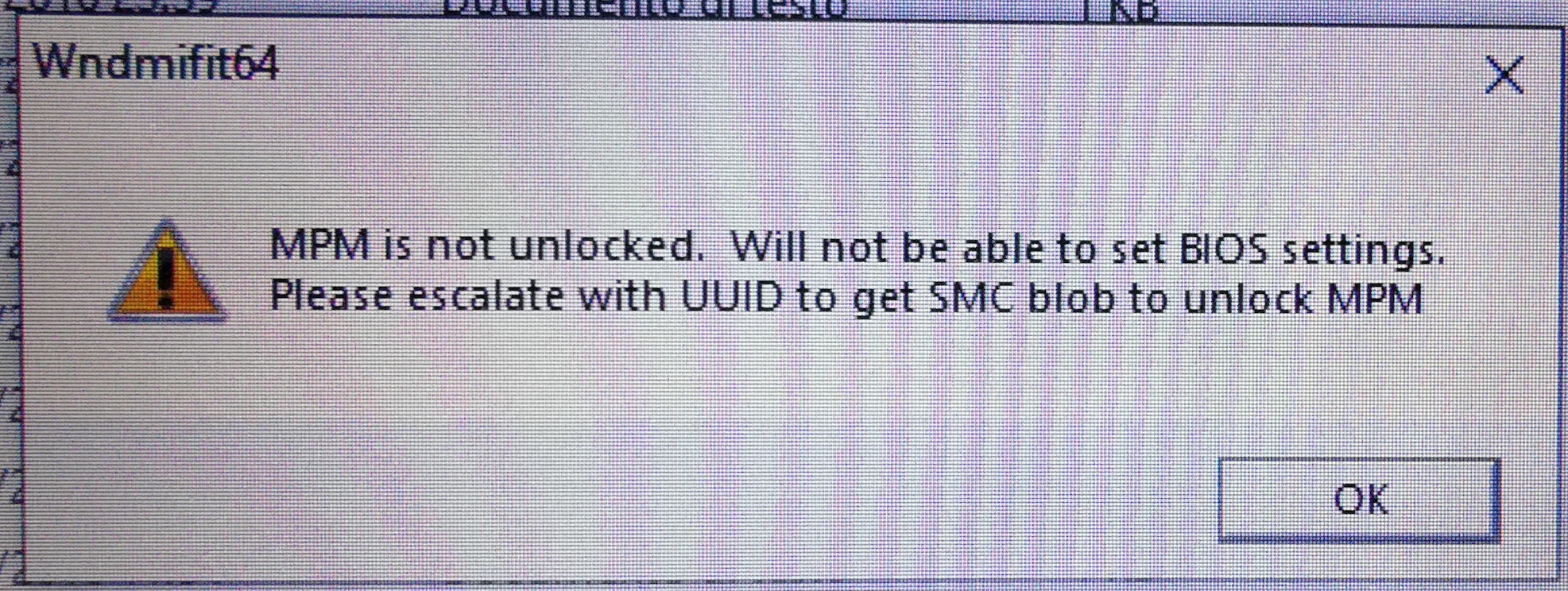

                                #195
                                Re: HP DMI Tool NBDmiFit
                                Originally posted by GGN
                                Hello!
                                I am trying to unlock the MPM on my Elitebook 840 G2 because I failed the initial branding after I changed the motherboard.
                                I tried the above method, and after I launch UefiMpmUnlock.efi in EFI shell, I receive the following message: HP MPM protocol is not present.
                                What do you guys think I am missing here?
                                I also tried to find a way to unlock the MPM via BIOS programming with no success. Could someone tell me how to find the byte controling MPM state in the BIOS?
                                Thanks!
                                I'm having the same problem.
                                In Windows HP BCU doesn't work nor the UefiMpmUnlock.efi (that gives me the "HP MPM protocol is not present." message).
                                My HP is a business model, the 9470m on which I unlocked the bios but still I've the information missing :|
                                Any idea on how to set MPM to unlock ?

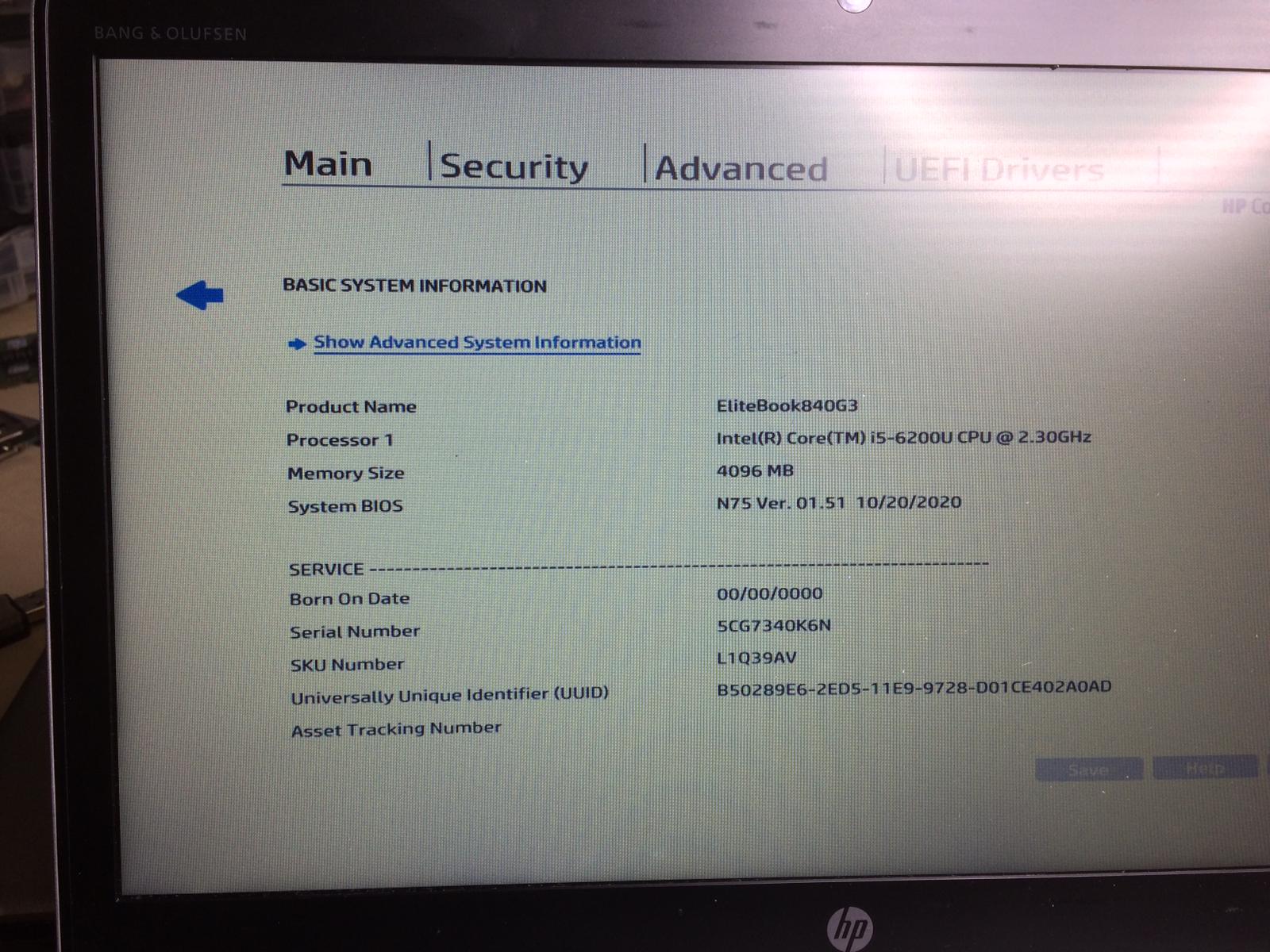

                                • pc001
                                  • Jun 2021
                                  • 2
                                  #196
                                  HP BIOS, wndmifit help
                                  Hi all, just joined as I’m looking for help with hp bios configuration after motherboard replacement.
                                  As I understand, the nbdmifit utility is for older laptops, I deal with newer laptops so I believe I have to use the wndmifit utility in windows.
                                  I have created a winpe usb and tried to run wndmifit via the cmd box but it won’t run, wndmifit runs in windows but I still need to know how to lock and unlock the mpm so I can enter the details and lock the mpm again after.
                                  I have tried the biosconfigurator64.exe config file edit in notepad, I edit the details in the config.txt file then save it again however I recently had an accessed denied error.
                                  I will be encountering hp board replacements allot so I’d like an easy / simple way of entering the sn etc.
                                  I have had success physically swapping the old bios chip to the new board on a few occasions but this doesn’t always work? This would be the perfect solution but for some reason it doesn’t work every time, what is the reason for this ?
