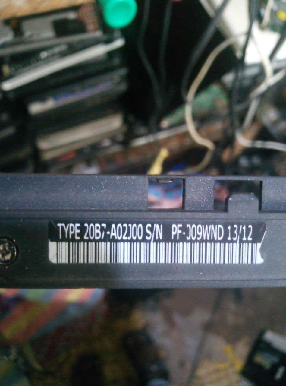

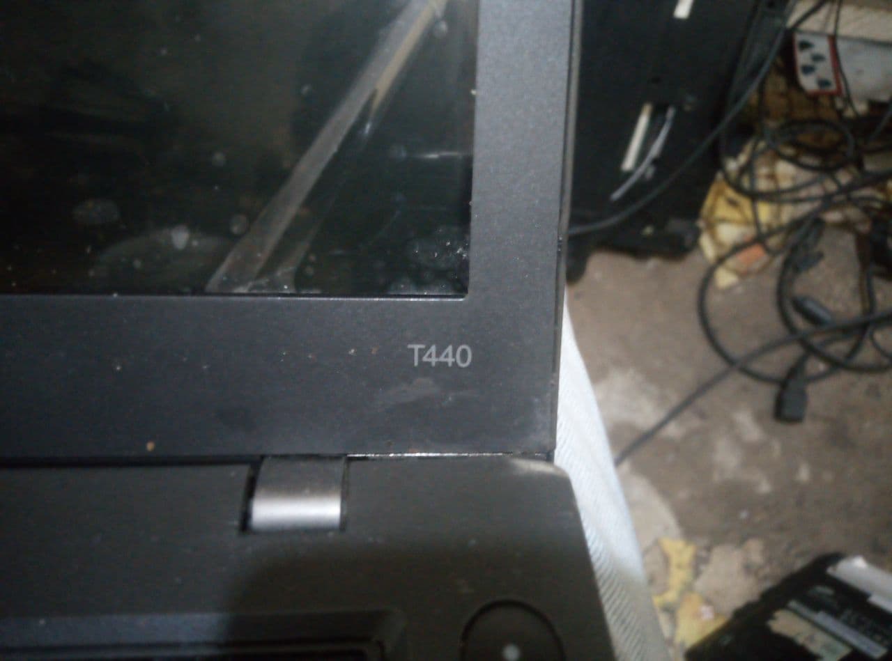

                #47
                lenovo t440 bios needed
                my lenovo has bios lock. i wanted to patch. but the backup of the old one gave me 0mb instead of 8mb. i have attached the model . so i want someone to help me convert the original exe to bin.
                  • 22001
                  #48
                  Re: lenovo t440 bios needed
                  What model is your programmer, are you desoldering or using a clip ? .
