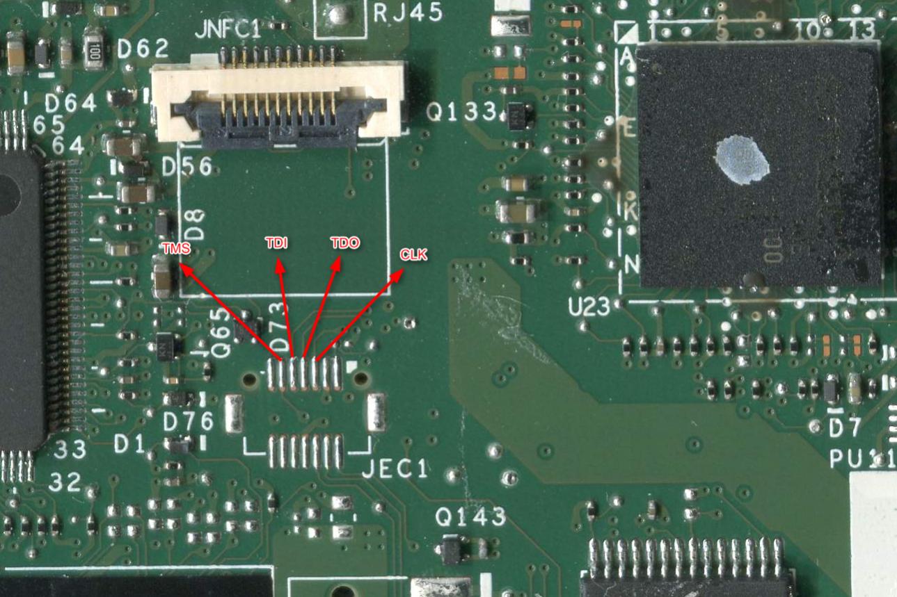

                  Try this.

                      Originally posted by imranromi View Post
                      Try this.
                      what to do with the pins?
                        Re: lenovo thinkpad T440
                        When you read MEC1633L T440 laptop using this jtag connection.Need i/o programmer if you read this.
                          interesting
                          once the mec1633l is read then what is next ?
                            Reprogram the MEC1633L then remove password.
