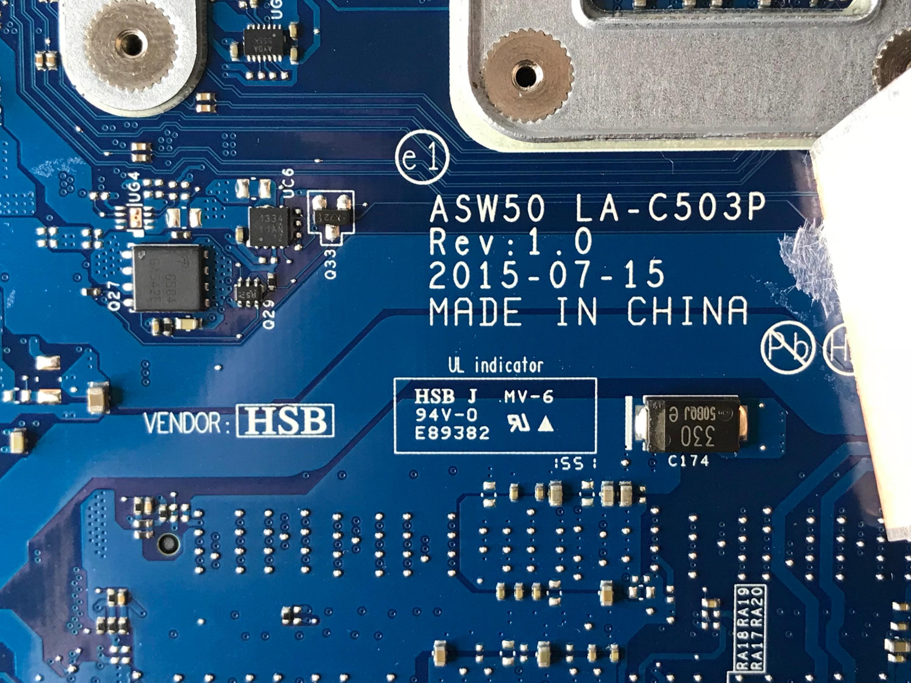

    I need bios for HP envy notebook, motherboard: ASW50 LA-C503P
    Can someone upload dump here? thanks.

            I tried all 4 dumps from Mielta and not working. Only power led on connector lights. Have someone schematic for this mobo? Thanks.

              Re: HP envy 15-ae107na bios
              Mielta has given you HP official Bios so should've worked. Seems like not a bios issue.
              What is the mobo code???

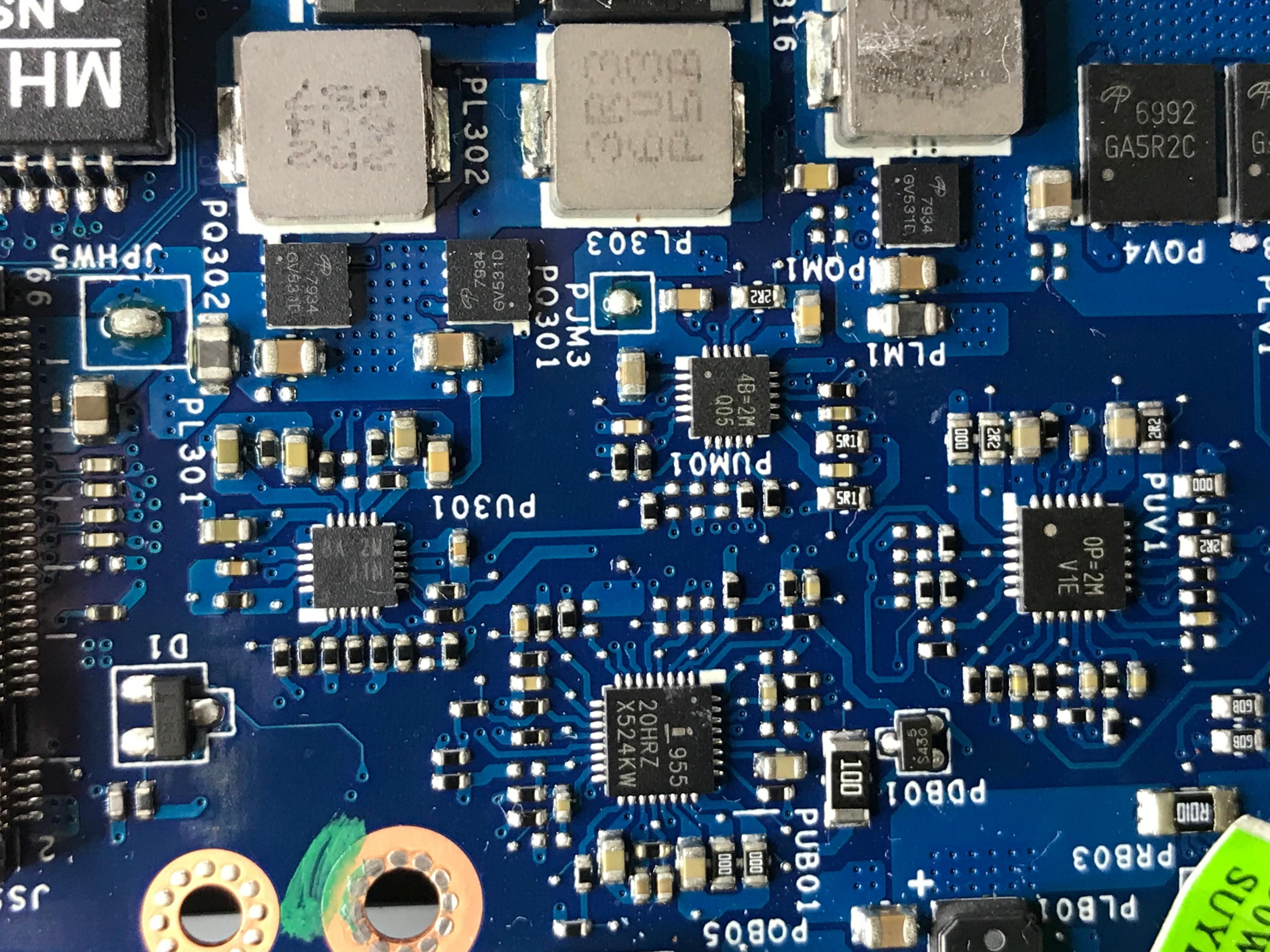

                I can't recognize smd codes on IO's - 0P=2M, 4b=2M, 8A 2M . I can't find schematic for this mobo and also datsheets for IO's.
                  8A=RT8243AZQW
                  OP=R7730GE
                  4B=RT8207P
                  Now you can download the respective datasheets and proceed further
