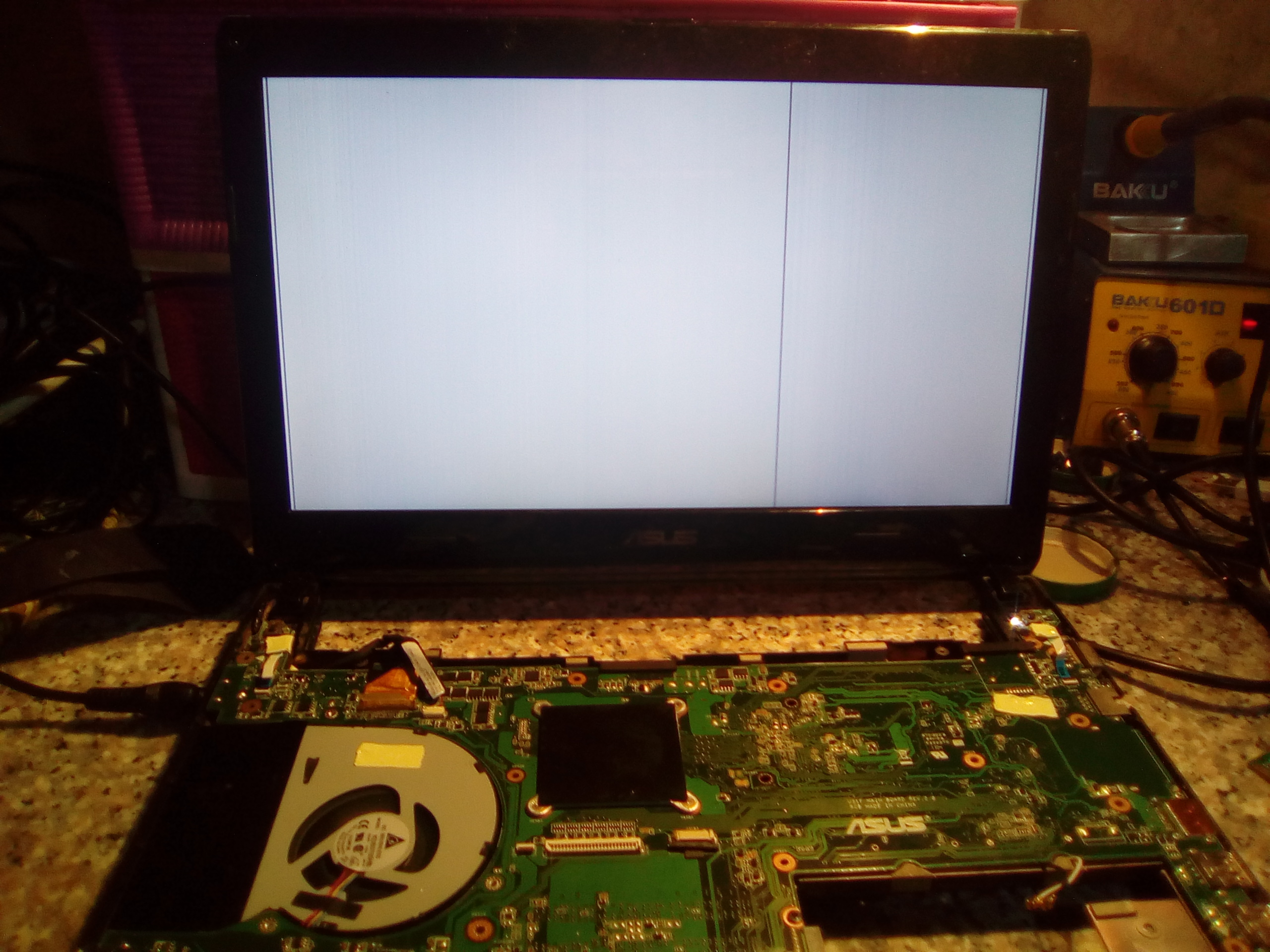

    hi for all,
    please I need bios dump for Asus U31F, I don't have the original one ( delete it accidentally).
    I Have stripe on screen after Asus logo ( see attached picture), laptop works fine befor I flash the bios with dump from asus web site.
    thank you

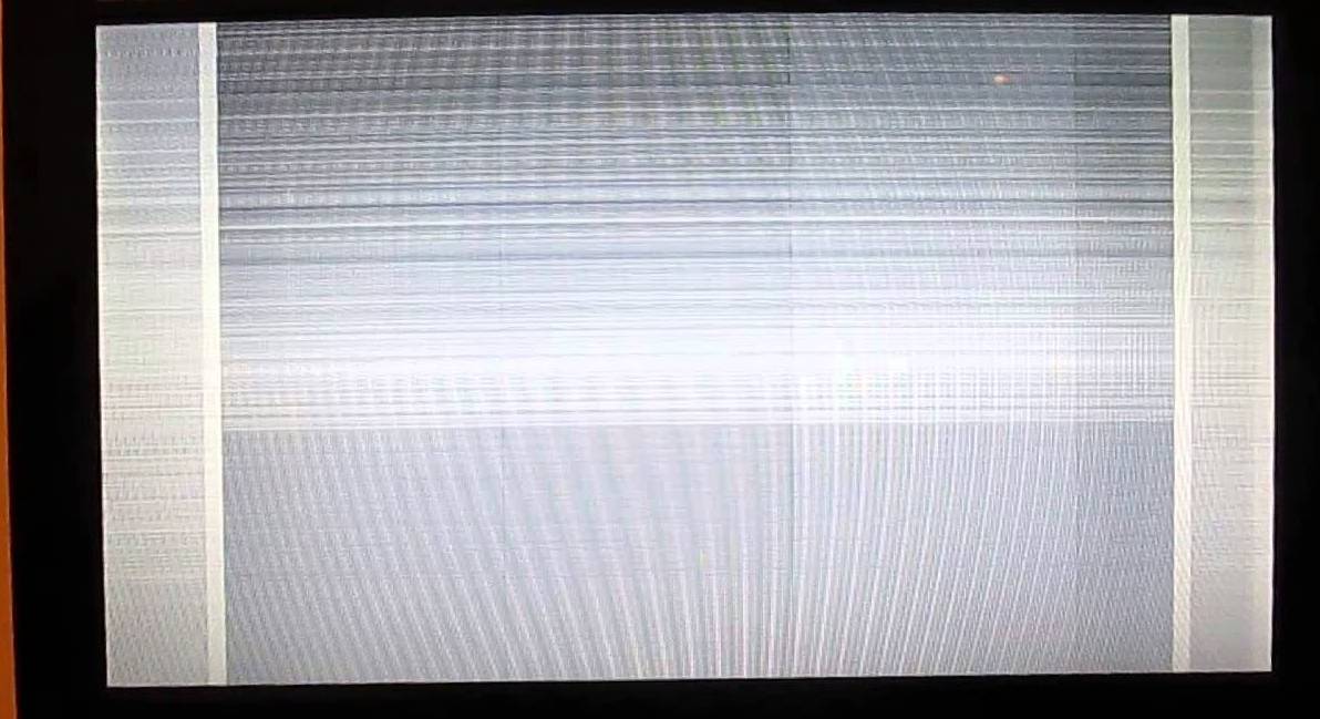

        Re: Asus U31F need clear me dump
        sorry I was busy this days, dump works but with the same issu
        can someone clean me this dump for me please..
        PS it going like this (see attached picture) after showing bios setup
                Hi
                Check an external Monitor
                • mielta
                  • Apr 2015
                  • 368
                  it looks like LCD or LCD Cable
                  • String2016
                    • Nov 2015
                    • 2242
                    • philippines
                    that is not a bios issue check external if it is not the same then your lcd screen is the problem if the same then you graphics has the problem
                    • sourcebf
                      • Jul 2016
                      • 433
                      • N/A
                      ok thanks for the advaces i'll find out an other LED sceen to test with...
