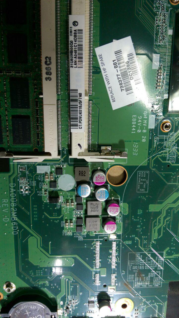

              daou82mb6do
              rev.d
              • salmanzeiad
                • May 2016
                • 68
                • world
                Re: i need bios hp 15-n009sx
                Originally posted by salmanzeiad
                daou82mb6do
                rev.d
                pic

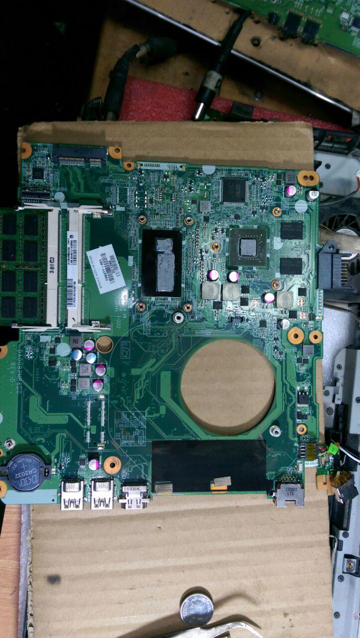

                • salmanzeiad
                  • May 2016
                  • 68
                  • world
                  daou82mb6do
                  rev.d
                  pic2
                  • mcplslg123
                    • Jun 2015
                    • 7262
                    • india
                    dear salmanzeiad, are you sure your bios is 4mb?? What is the number on bios chip?? It should be 8mb as per other forums and hp official update. Can you please confirm.
